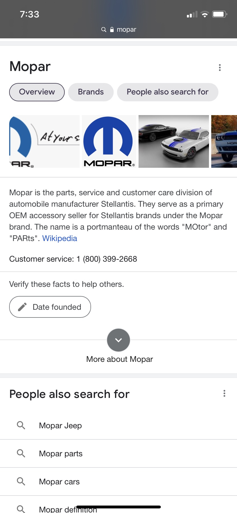

   / 2021 Chevy Silverado 2500HD gas vs. diesel? #149
Ain't MOPAR now. It's Stellantis. :p
Nope. MOPAR is still MOPAR.
MoKelly
   / 2021 Chevy Silverado 2500HD gas vs. diesel? #150
Mopar
Mokelly
