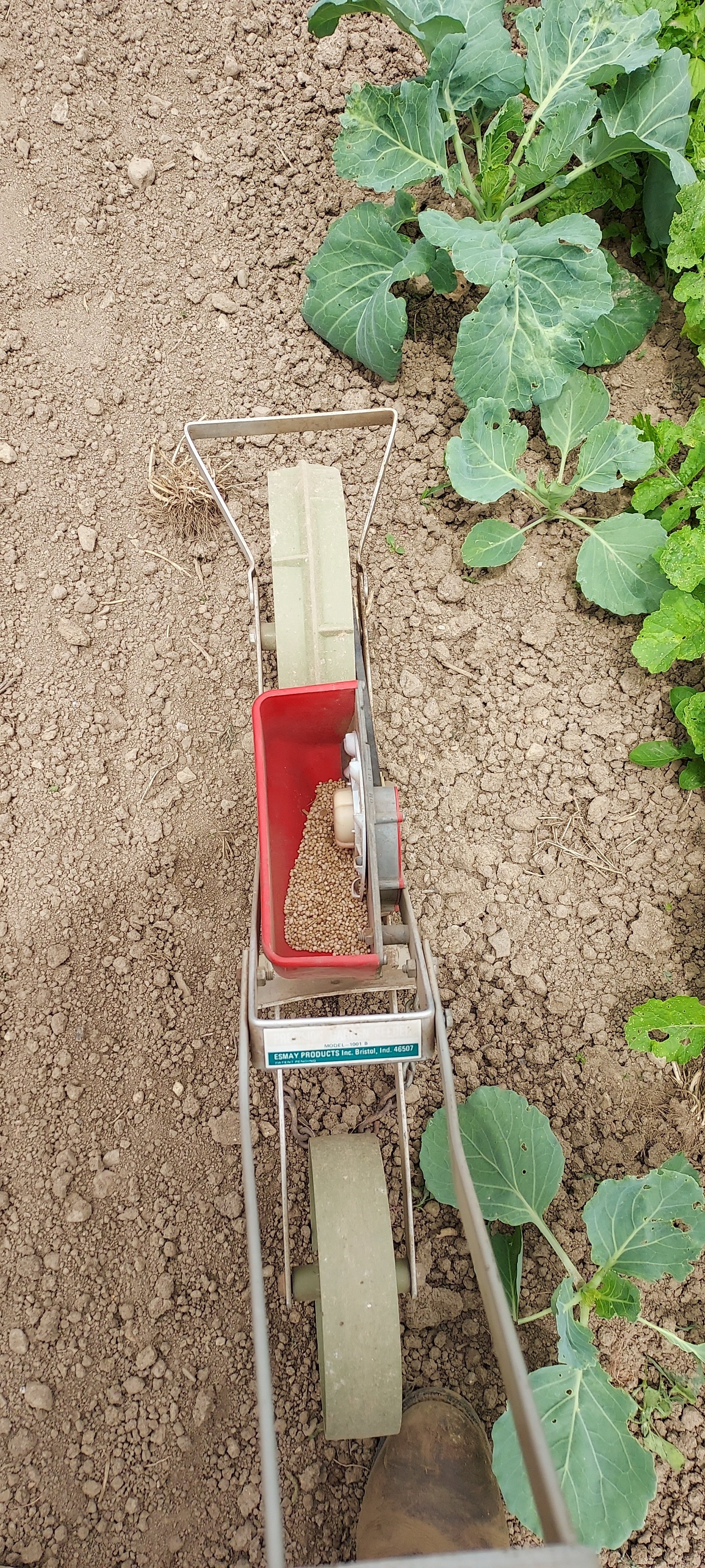

I picked up a 5 gallon bucket of Urea, and Potash last year when getting bulk fertilizer for the hay field, to side dress in the garden. I never used any due to the drought. While hoeing the other day I was thinking I need to get everything side dressed, but meter it out somehow, not just pour it on the ground out of my watering can I use for in row spreading of 12-12-12, then run the cultivator through to stir it in.
The light bulb came on about trying my Earthway seeder. I only use it to plant Daikon Radishes next to the cabbage as trap plants. I filled the hopper about 3/4 full and took off with it. The different sized pellets had a tendency to get behind those plastic plates at times but worked rather well. Just had to back up a few times when it would seem to jamb but turned when pushing again. I'd already cultivated so the soil was loose. The furrow maker was set to about 1-1/2" deep, and it applied it deep enough the little drag chain to cover furrow, and packer wheel covered it nicely so as not to evaporate.
It worked so well yesterday it was dry enough to try the Potash. I must say it worked better than applying the 46-0-0. I used the bean plate to put it down 8" to 10" away from plants so as not to burn things up.
We got a 1/2" of rain the other night after putting down the Urea, and we got another pretty good rain last night. Haven't been out to check the rain gauge yet, but from watching the radar last night and early this morning guessing we got 1"+. Ought to be enough to get it set in and start to dissolve. Now we wait to see any improvements.
I gave $8 for the Earthway years ago at an auction and seem to see one at yard sales occasionally for $10 or so, so not out a lot if the Urea starts to work on the pot metal backplate in it. Although I did wash it out really well after I finished.
Probably not ideal for small gardens but sure made quick work of doing the 50 some 100' rows I have out. I hit everything last evening and was done in 15-20 minutes. So just a little FYI for those looking for a way to side dress a larger, but not huge garden.

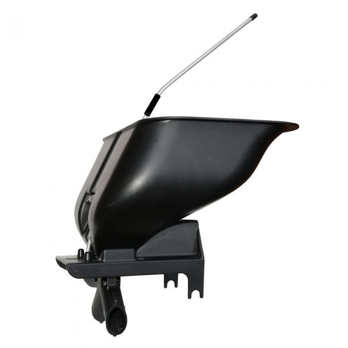

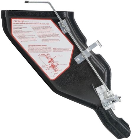

Above in the one you want and this is a pic off the internet. These are wonderful and let me band fertilizer 2" or so deep.
**If you want, I can take a picture of my planter with the fertilizer unit on it so you could see better how it fits. Just ask if you want it.
The one below you DO NOT WANT. It just drops the fertilizer on the ground. Nitrogen evaporates.
