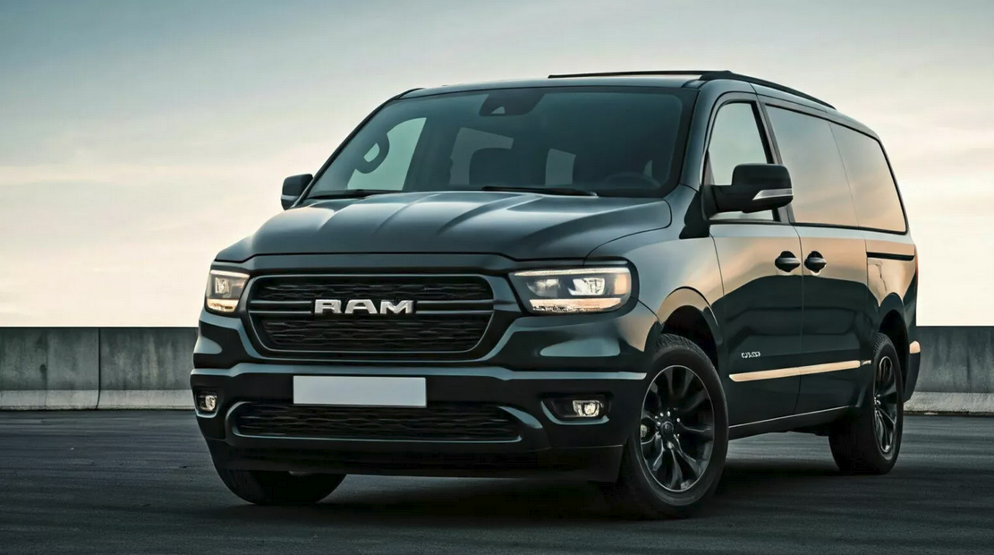

Noticed the concept 2026 RAM Dodge Grand Caravan RWD and a 5.7L Hemi. Also has a different hidden slider door track as well. Not a minivan, but a mid-size van. Not a full size RAM Van last seen in 2002.
Ram's CEO Tim Kuniskis wants a new van and it could be inspired by the best-selling Dodge Grand Caravan

How well received is the ProMaster in the US ?
Selling the Dodge Sprinter made sense, but to me personally, the ProMaster will allways be a lowly Fiat Ducato with its chimpansee snout.
I assume this is a fake, but this snout already makes it more palatable;
The only US vehicle mass imported into Europe was the Dodge Caravan, or Chrysler Voyager as it was called here most of the years. They sold a bunch untill the crossover SUV came in fashion 10 years ago. Right now, i only see the Pacifica listed.
I just dont see a pickup truck based V8 RWD van being a replacement, its going to be more expensive and heavier.. ?
Its certainly not going to sell in Europe..

Nope, it is for the North American market, plain and simple.
