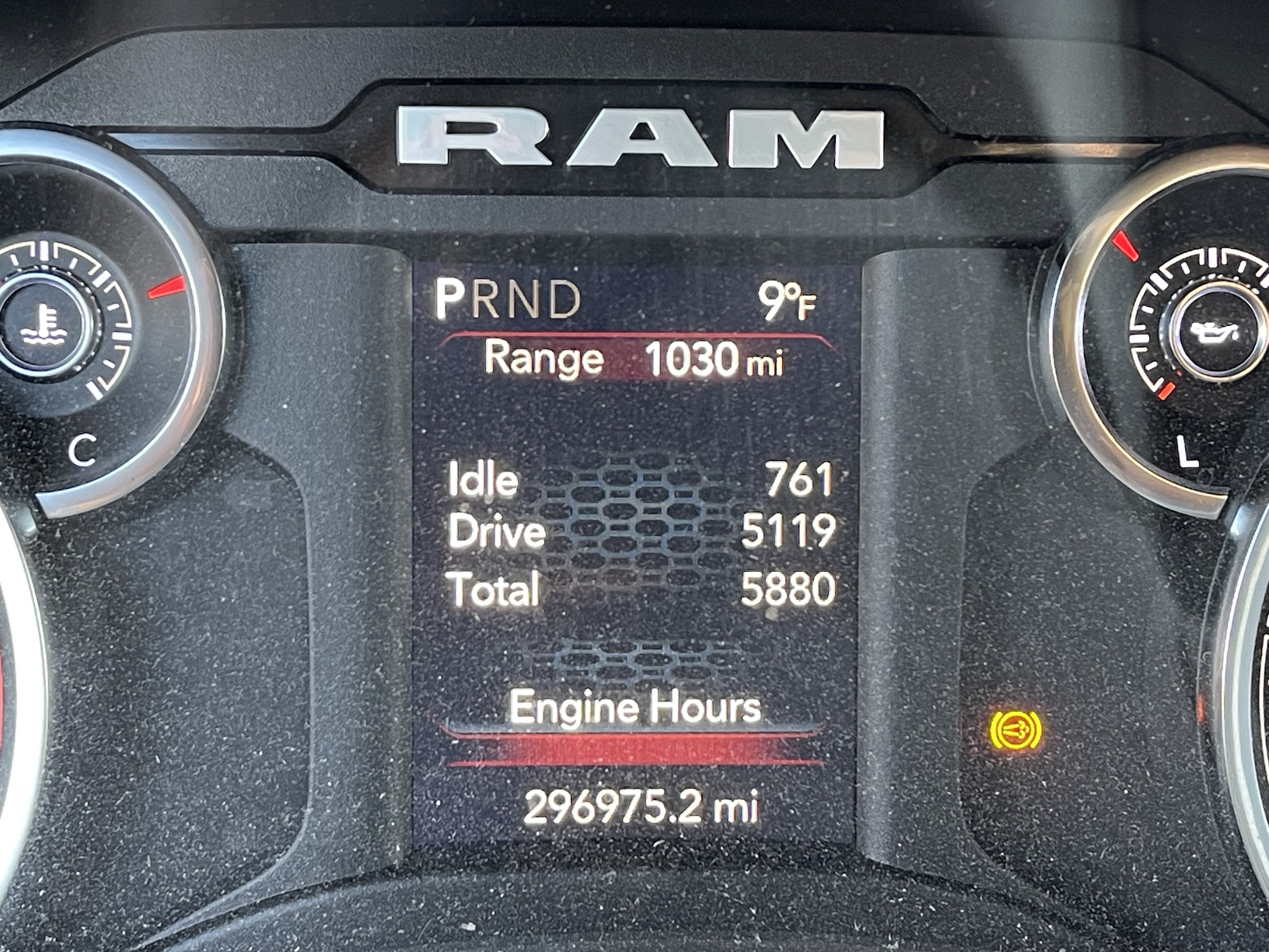

Hot shot trucker I know. '22 Ram 5500.
/ 2025 Ram trucks #63
Looks like I have a long way to go on my Cummins.
A tribute to the longevity of powerful, but low revving straight six engines.
/ 2025 Ram trucks #64
/ 2025 Ram trucks
#65
Averaging 58MPH.
That’s movin’…..
Range 1030 miles.
If he has a 50 gallon tank like me, that means 20MPG.
He has the 52+22 gallon tanks. He delivers Gatormade trailers, so he is empty about 1/2 the time. Kinda like RV transporters.
On 11/06/21 his '18 Ram 4500 had this: "Truck is at 398,065 miles and 6,953 drive hours."
