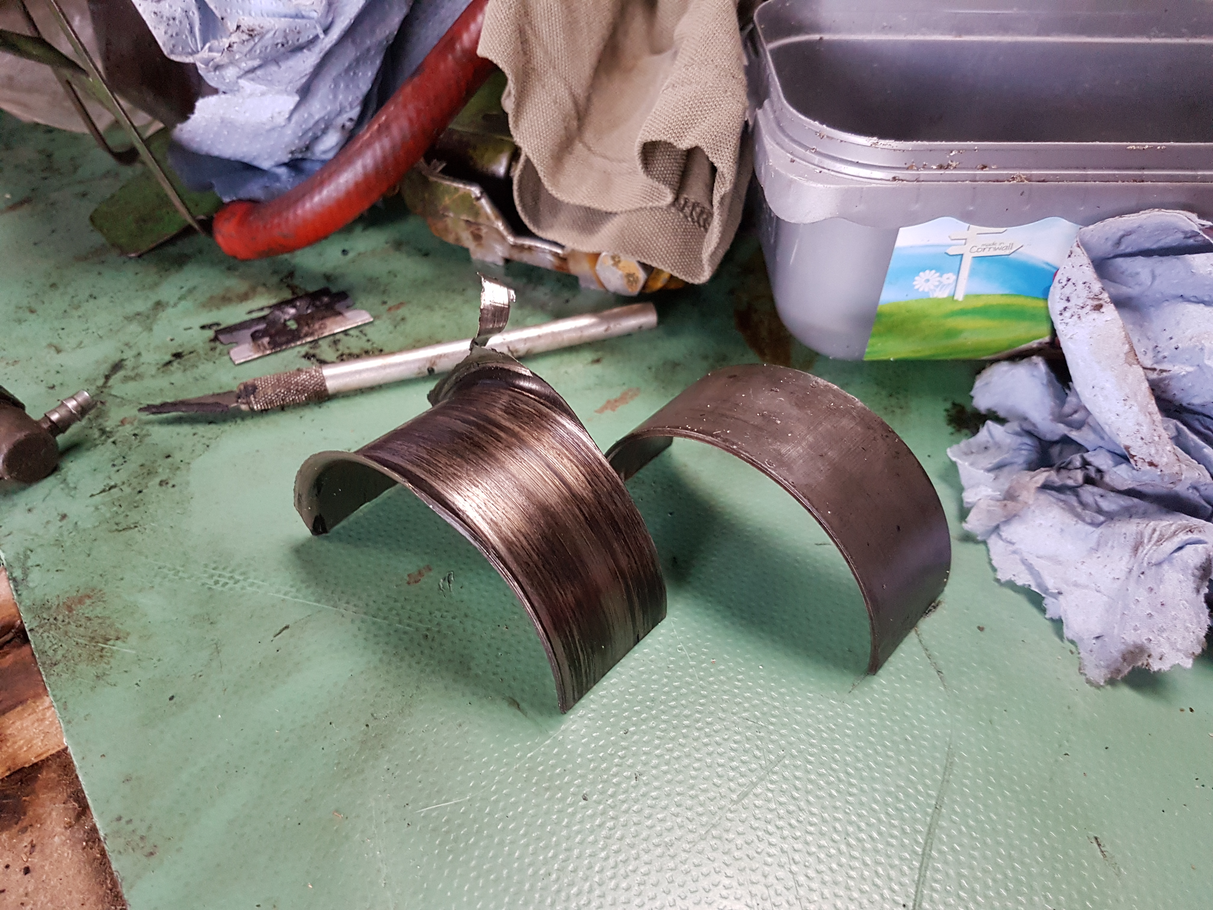

Spent yesterday taking it all apart.
Bit of sludge in the head gasket but no holes or tears that I could see. Looked in reasonable condition, TBH.
Found coppery metal shavings in the sump.
   / 2030 died while driving, now struggles to start
#15
   / 2030 died while driving, now struggles to start #16
I admire your willingness to dig in to the problem. Myself, I would have analyzed & tested to the point of exhaustion and still might not have found the issue.
   / 2030 died while driving, now struggles to start #17
Are those brgs in your photo rod or main brgs?If main brgs it appears a different block or a line bore is in order.
#18
Conrod bearings.
   / 2030 died while driving, now struggles to start #19
Coppery metal shavings come from a big end bearing.
http://i.imgur.com/odtPvkI.jpg
If both of those are from the same rod I'd guess the bearing was really worn out and one of the bearings tucked and spun. Check that rod and journal carefully before putting new bearings in it to make sure it isn't egg shaped from hitting the crank journal without a bearing.
The smoke you saw was probably from hot oil at the bearing while it was going for a ride coming out the breather.
   / 2030 died while driving, now struggles to start #20
In my experience, there is no way the crankshaft isn't trashed with a bearing that looks like that. At the very least, it will need to be turned undersized or replaced.
