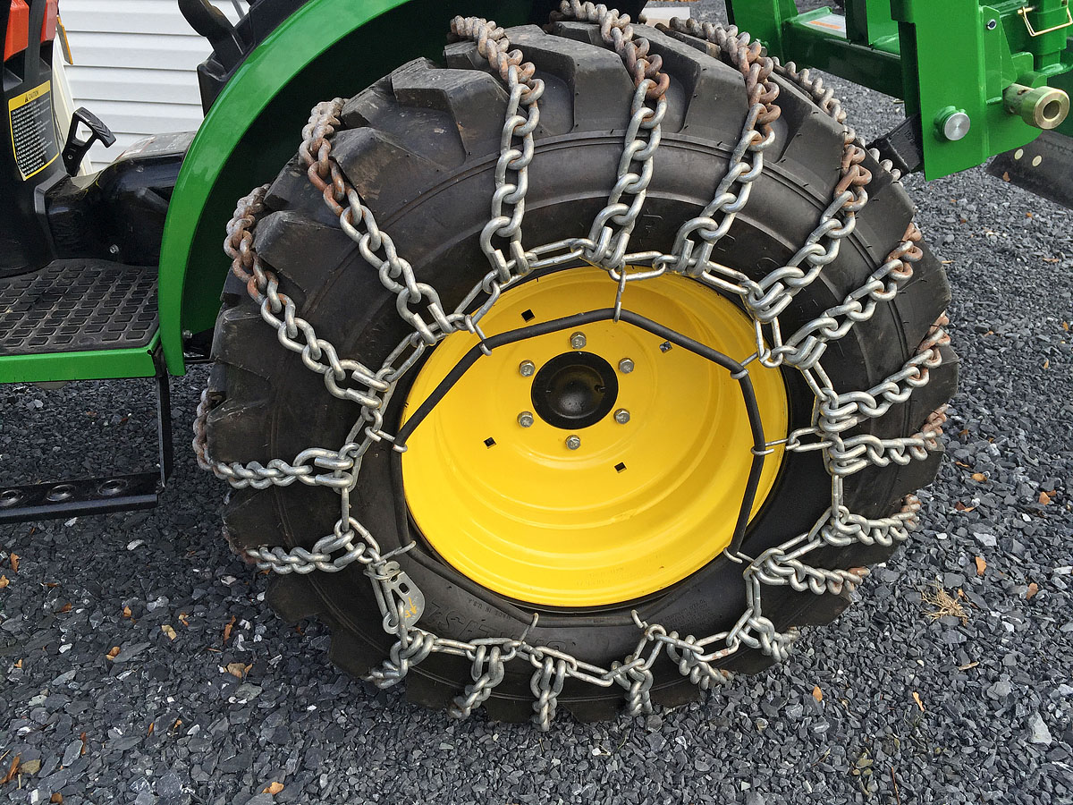

No offense meant here, but jgayman's pic of tire chains is a perfect example of a set of chains way too big for the tires. Side chains too short and cross chains way, way too long. Again, that is my opinion.. and may not be held by all. so just sayin.. for archival sake so others can at least ponder the issue.
   / 2032r Tire Chains #15
After I read your previous comments I knew you were going to say that! heh heh I agree with you. They do seem kind of big for the size of tire. I appreciate your comments. I do like the way your chains fit. I kind of wish I could find something a but more suitable. While these chains work fine, they are HEAVY, they are H-E-A-V-Y, they are a MOFO to install each year and you kind of bump along as you go.
I'm not getting any younger and would like to find something that is easier to install.

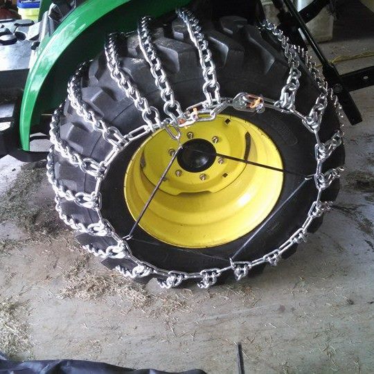

i got some 2 link chains my 2320 from Tirechains.com as well and have been very pleased..
I also had to drop quite a few links to get them short enough.. Then when i got them tight i have more 'gap' between the ends than I prefer but it doesnt seem to make a difference in traction.. you can clearly see the gap in the pic.. I have them tightened down pretty well since there are hydraulic lines running near the rear tires..
