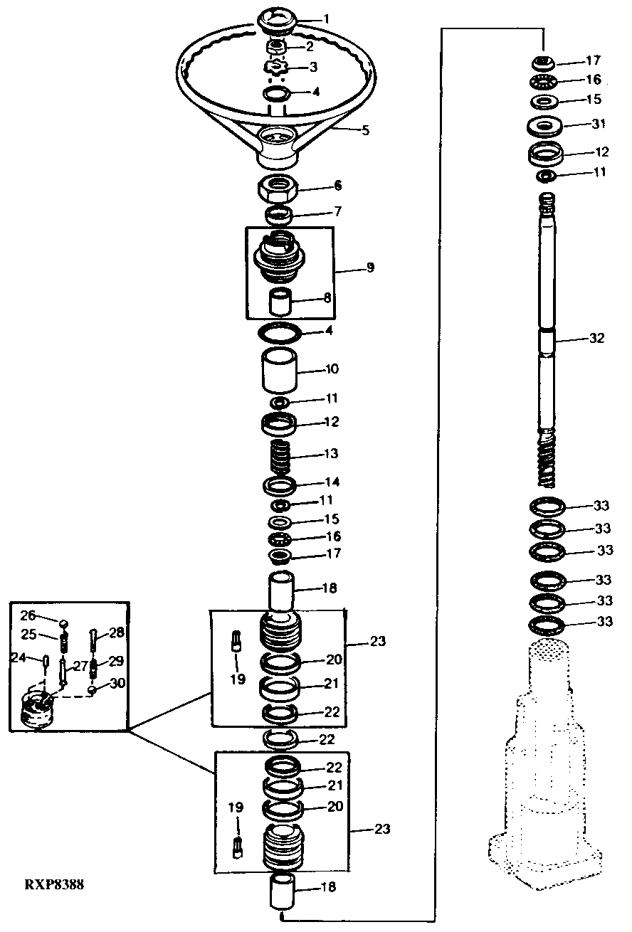

1630 has no relief valve but it has a stroke control valve in frt pump that's suppose to control psi. Check psi it should be 2250. I'm guessing one of the 6 o-rings in steering valve housing is damaged or in wrong place.

Hi
I've got the same problem but I changed the top seal and that fixed the leak but then I heard a loud "pop" like a Champagne cork popping out. And after that the oil was pouring out AGAIN.
So my question is: where does the pressure come from? Any ideas?

lupusrex
One or more of the 6 o-rings(parts key 33) has failed.

TX Jim,
Many Thanks for your quick and kind reply. I guess Iエll be going down to the dealer to pic up some O-rings and get into the right mood before I do this. Getting hold of/place new O-rings 16 inches down a badly lit tube is probably a temper tester of gigantic proportions....But then, who said life was going to be easy!?
Let you know how I do when ready.

Yes the 6 o-rings can make ones blood pressure rise while trying to install them in their correct lands(grooves).

Hello Tx Jim,
Well I should send you a "virtuall cold beer" as a small token of my appreciation for your advice on the O-rings. Two were in one piece, the others in various state of deterioration. Anyway, I got into the right mood this evening and got the remains away of the old desintegrated O-rings and managed to get the new one´s in one by one, using a long O-ring hook tool and some piano wire with a L-shaped end to gently push them in. After having done 6 of them I felt very happy. The only thing I didn´t do today , was to assemble the steering shaft into the column housing again. Mainly due to not having enough lubricating oil on hand to push down the steering shaft correctly. Is there any need for checking anything before doing this? Or just oil the shaft and push it in?

I'd just oil the valve bodies and gently install them. Besides BEER OR Tequilla I accept CASH:D:dance1::D
