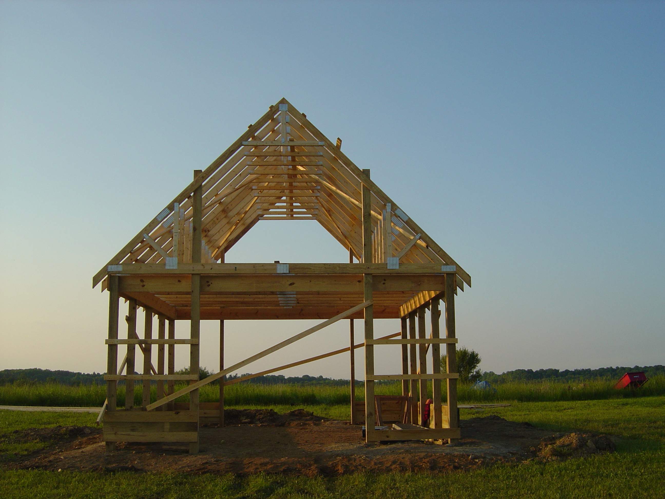

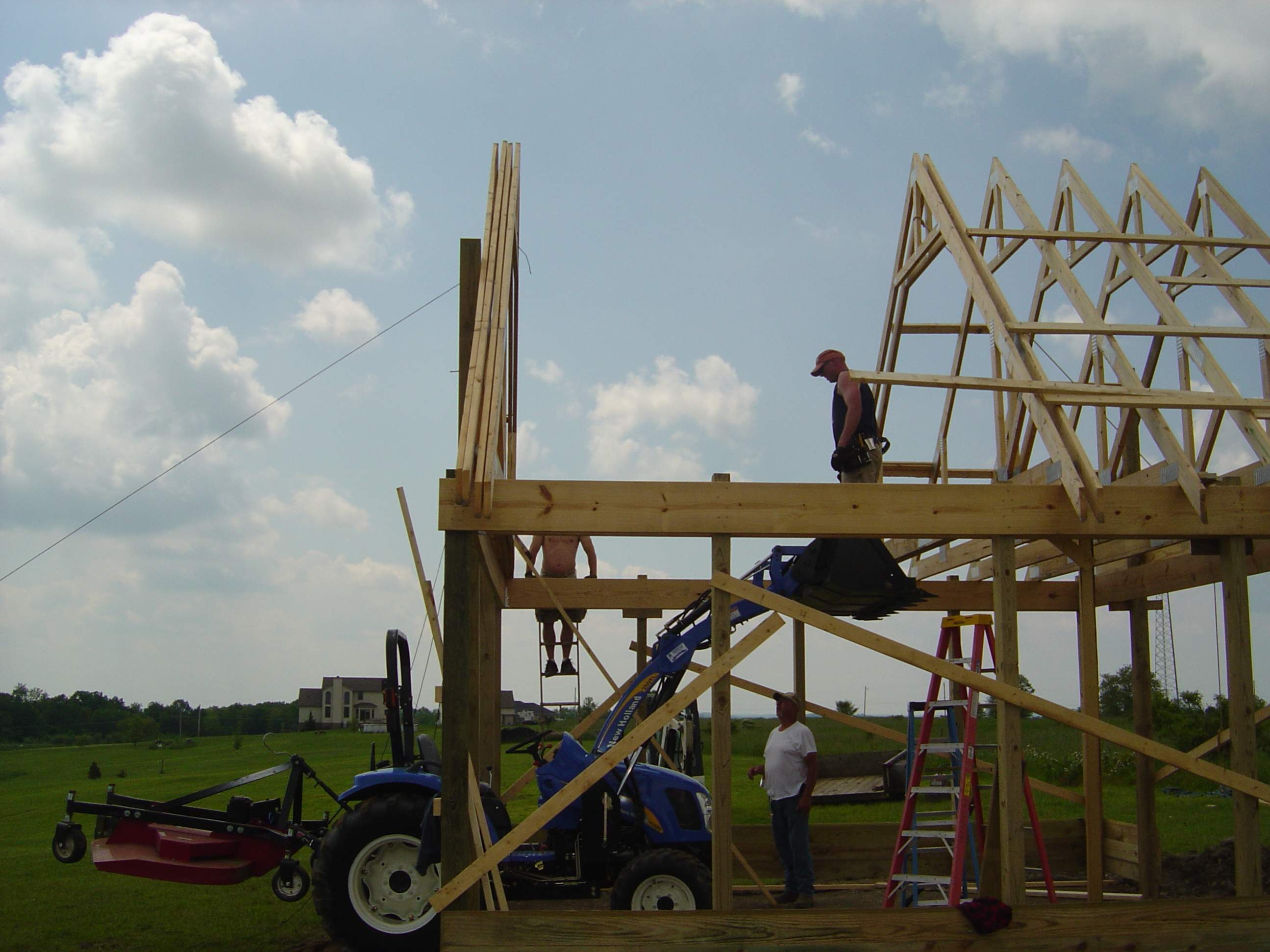

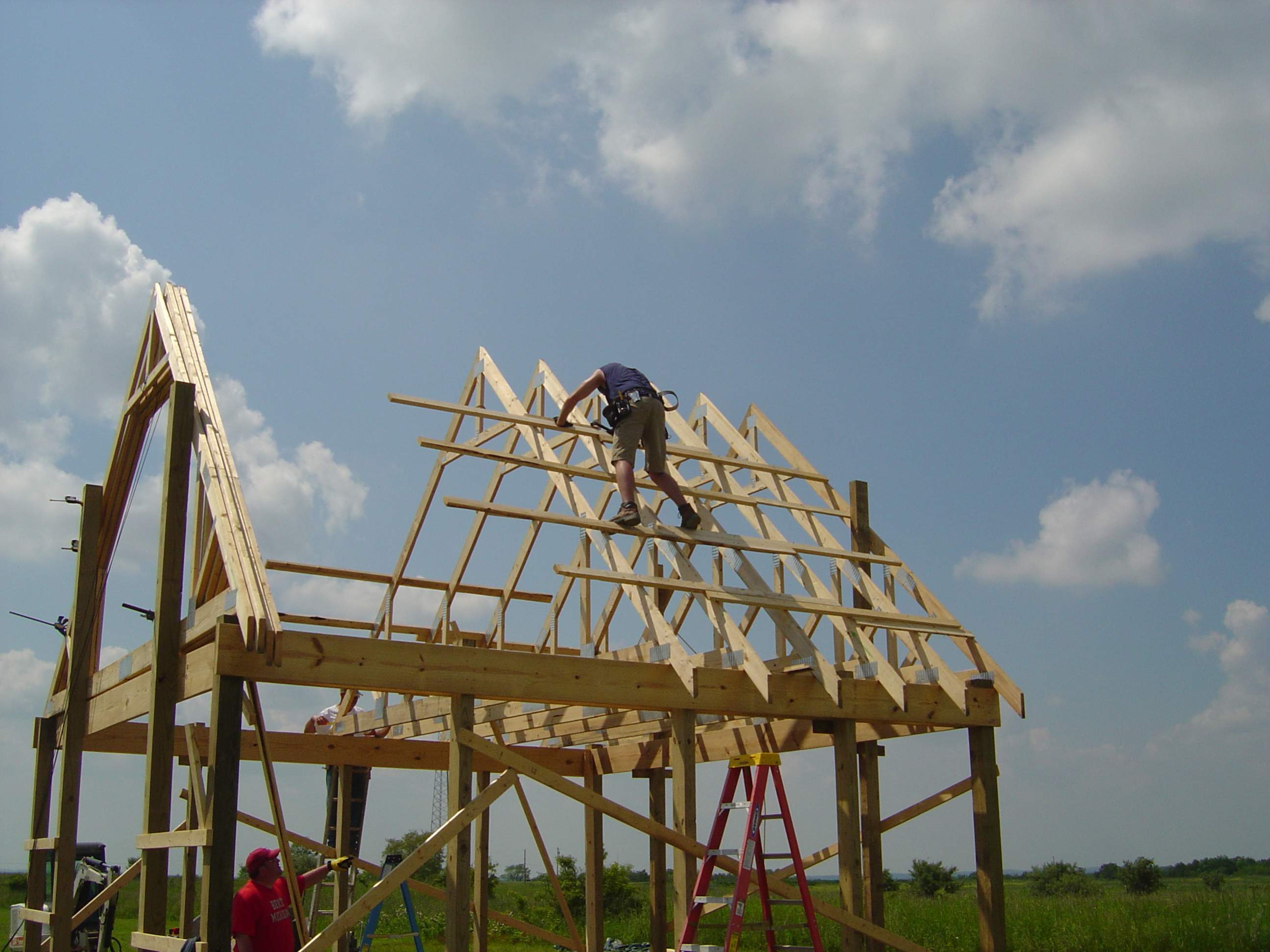

In between rain showers on Saturday, I was able to put up some of the girts.
On Sunday, the trusses were hung. It was a long, hot day, but they are all up and braced into place.

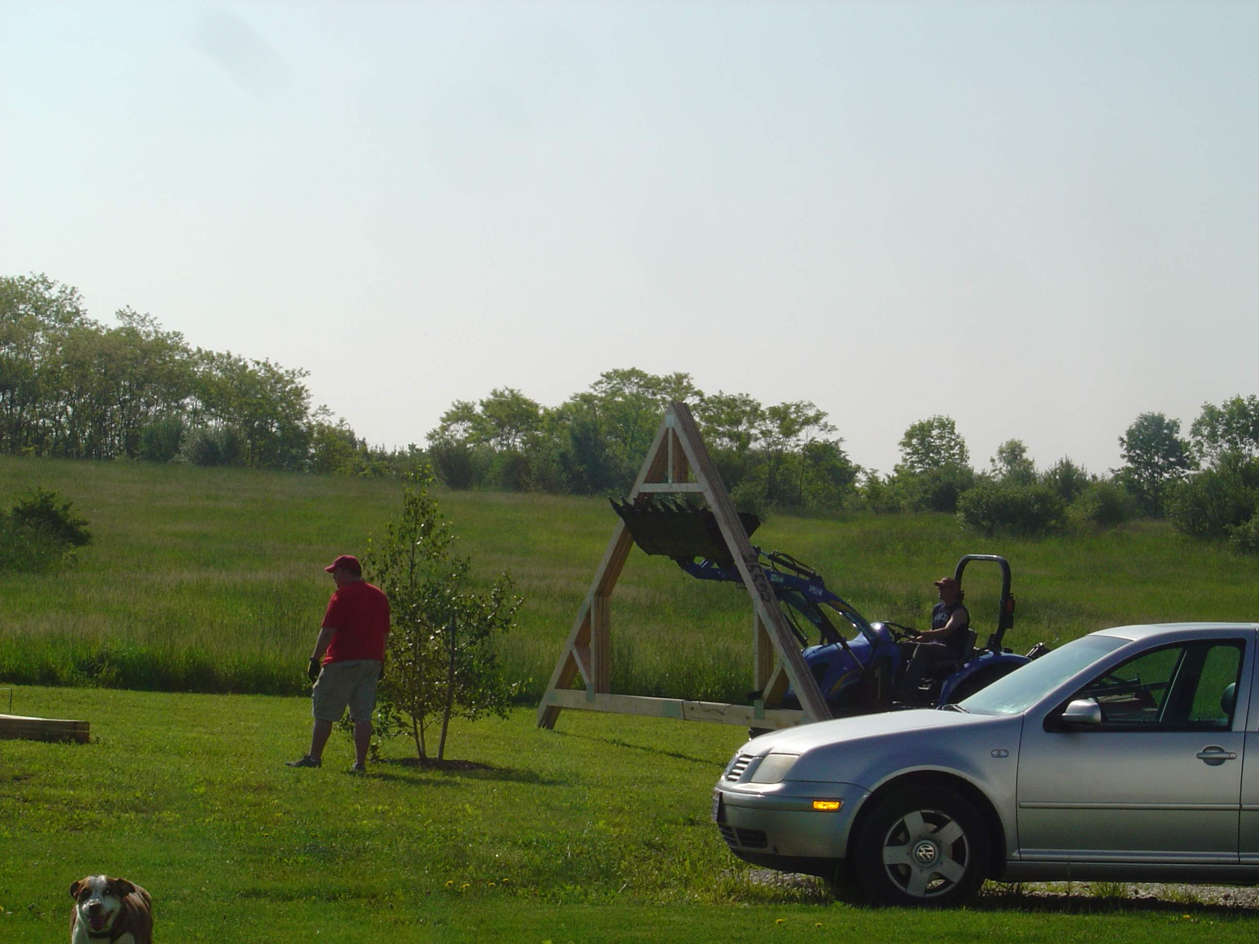

I used the T2320 to transport the trusses to the job site. The trusses were delivered without a phone call to me to see where I wanted them placed, so they ended up about 100 yards from the building site. I was also able to use the tractor to put up the two end trusses. The rest were placed by hand.

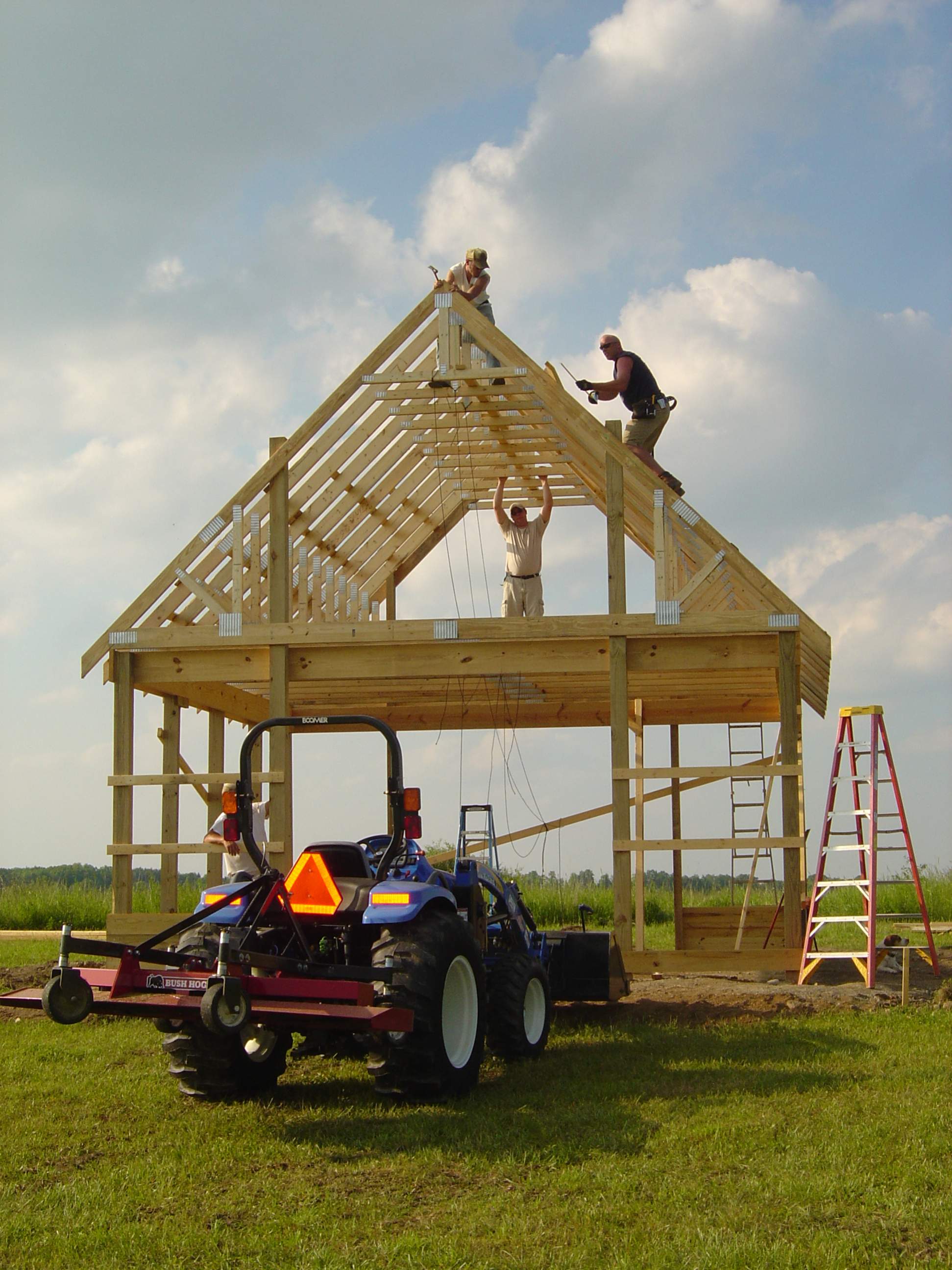

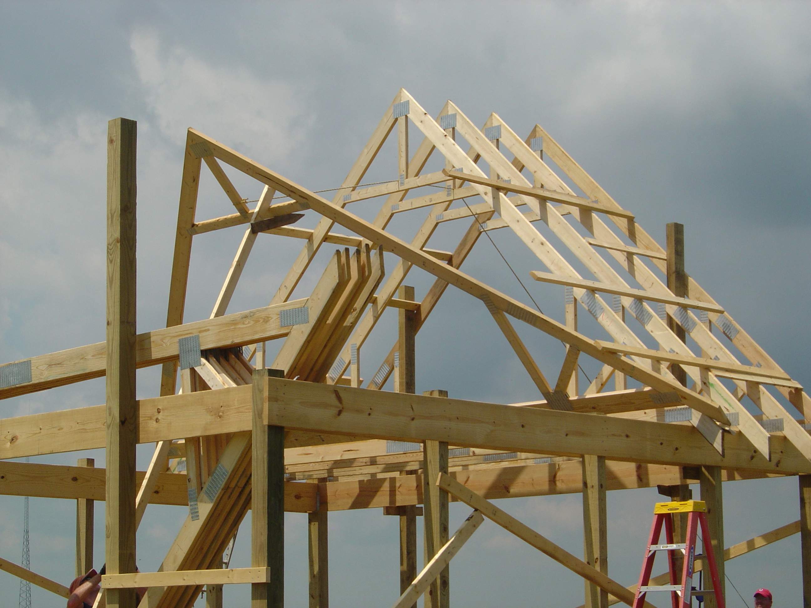

The tractor also came in handy stacking trusses inside the building. There came a point, after setting roughly 5 trusses, that we had to move the rest in the building and set them upright to be slid in place.
You can see the trusses on the left, clamped in place.
