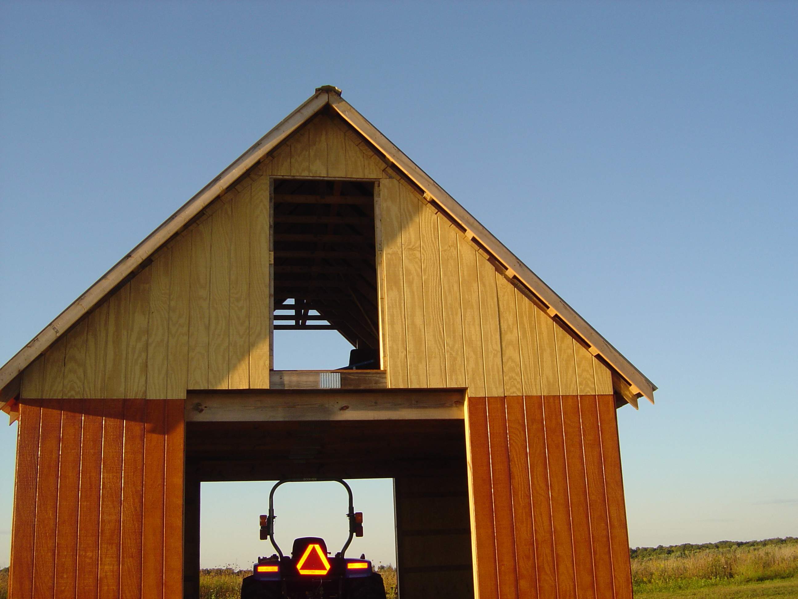

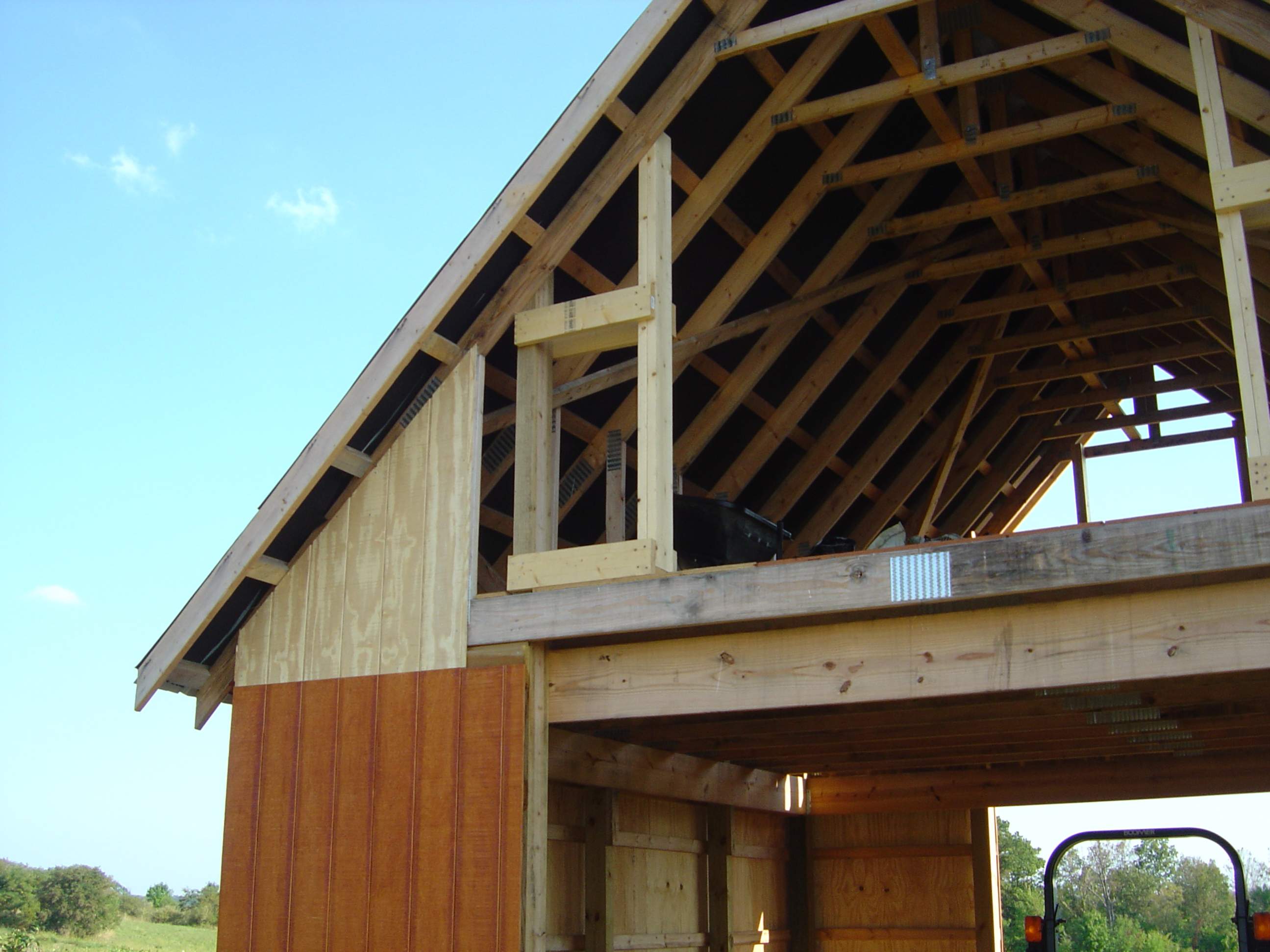

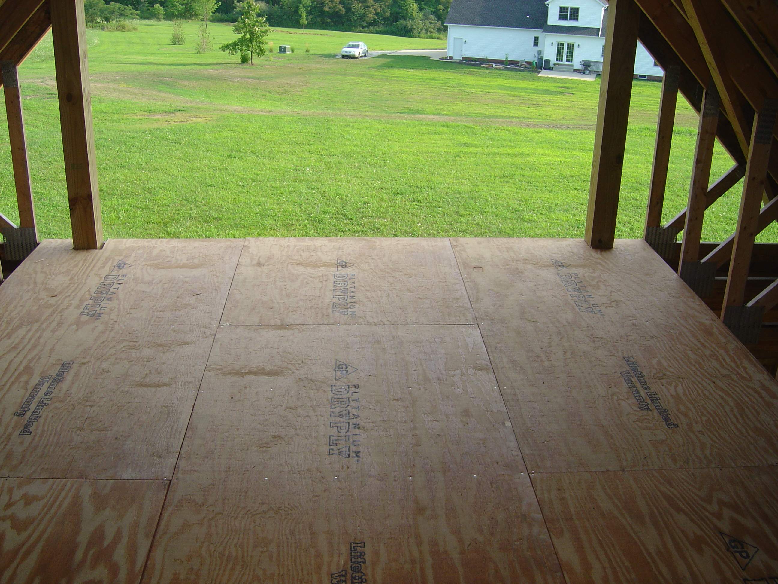

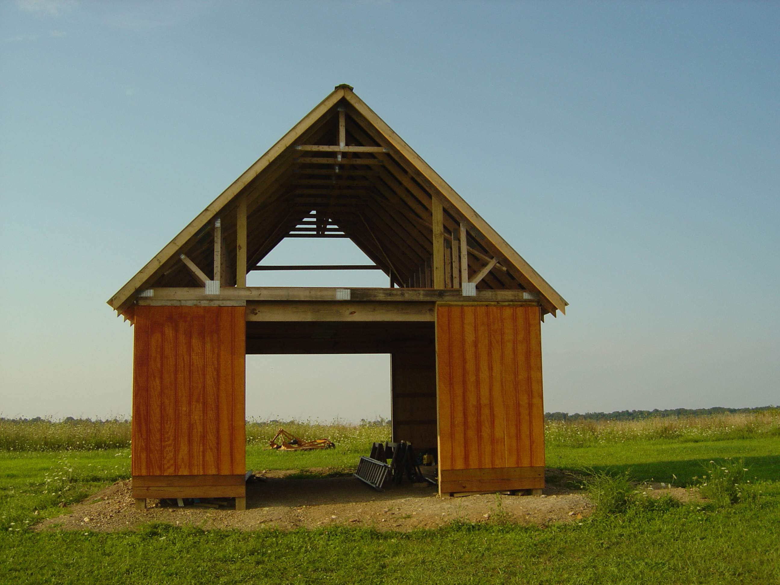

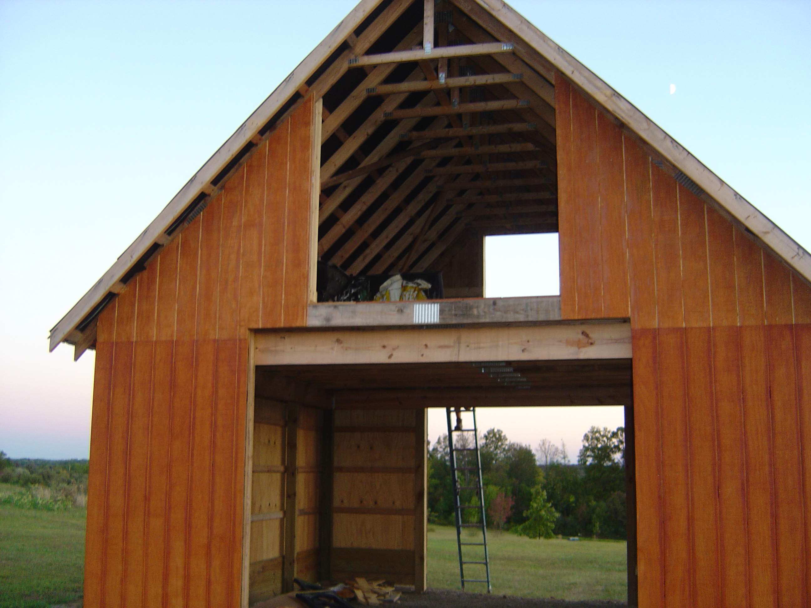

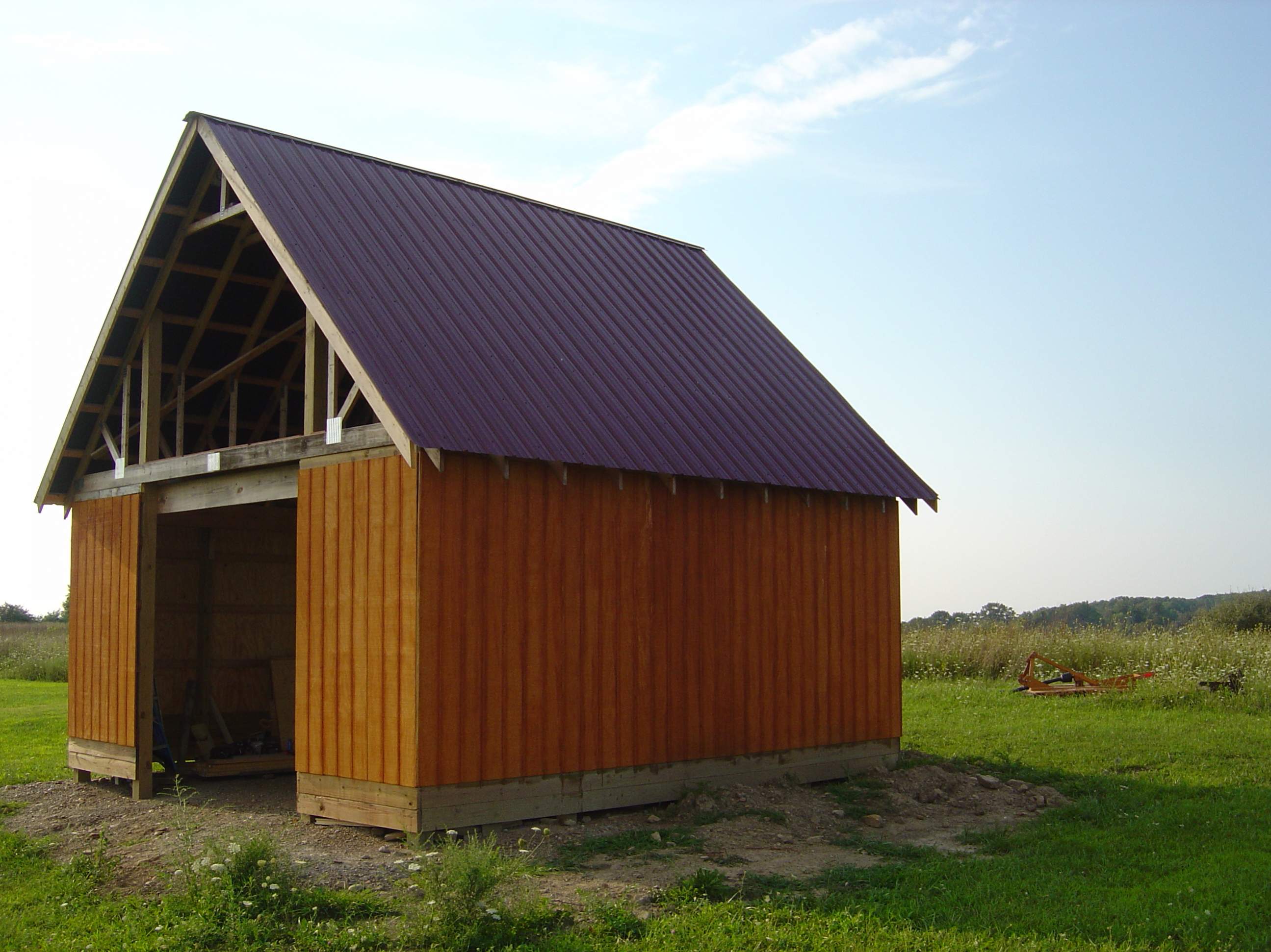

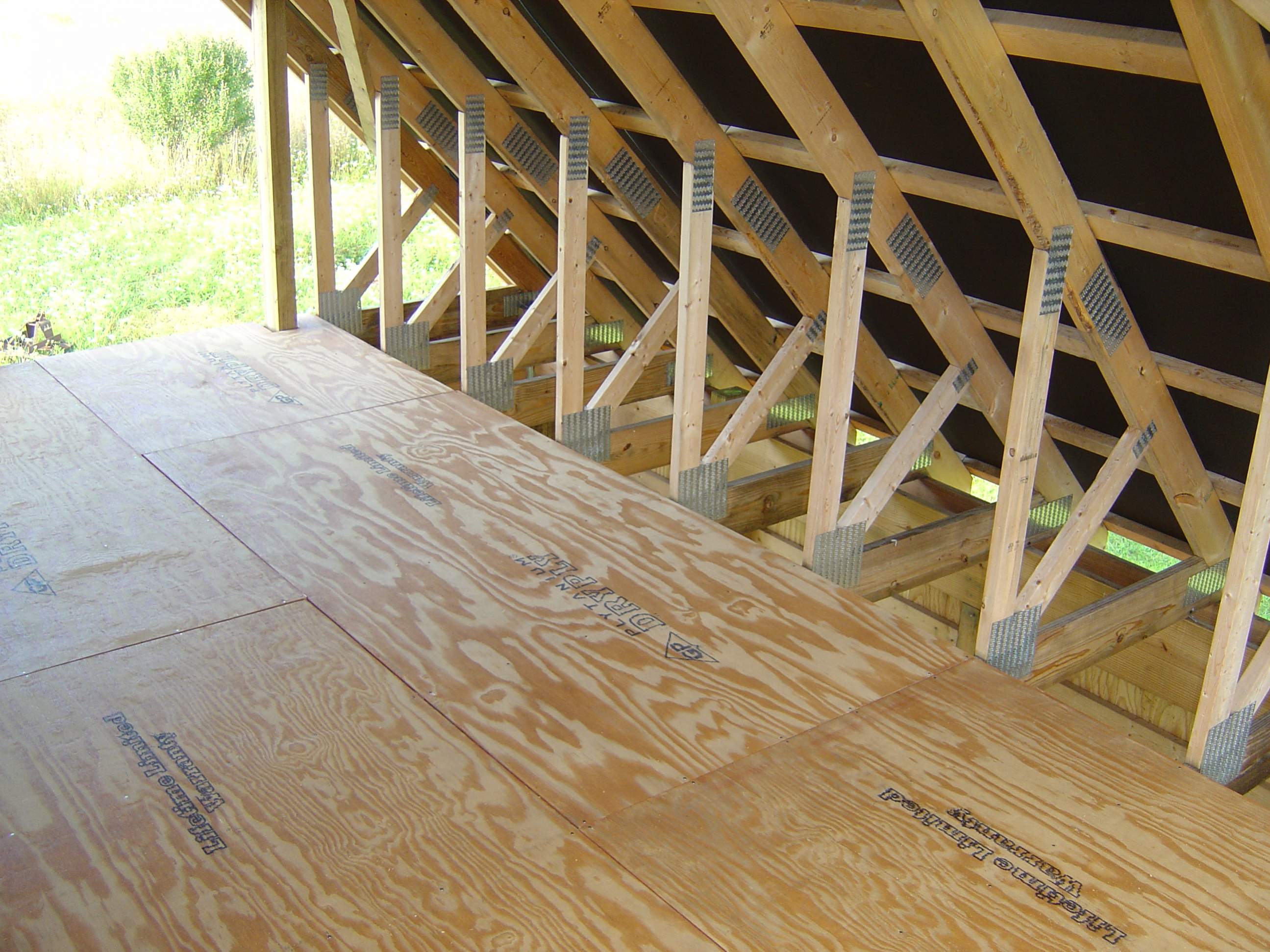

I finished staining the first coat this morning, and I completed the loft yesterday. The next step is to frame the loft doors in so I can finish the siding...I'm not sure when I will get to that, hopefully this week or weekend.
I was mistaken in my previous posts, stating that the loft was 10x20. It is actually 12x20; I didn't officially measure until I went to get the lumber on Saturday. Previously, I had just eye-balled the trusses and guesstimated. Shows what I know.

Looks good. That loft is huge for that size building.
   / 20x20 Shed/mini barn with a loft #53
Love it. I want one just like it. Or two! Fine, high quality work to be proud of. Great job, Seth. Please keep posting pix as you get the grading done, the doors on.

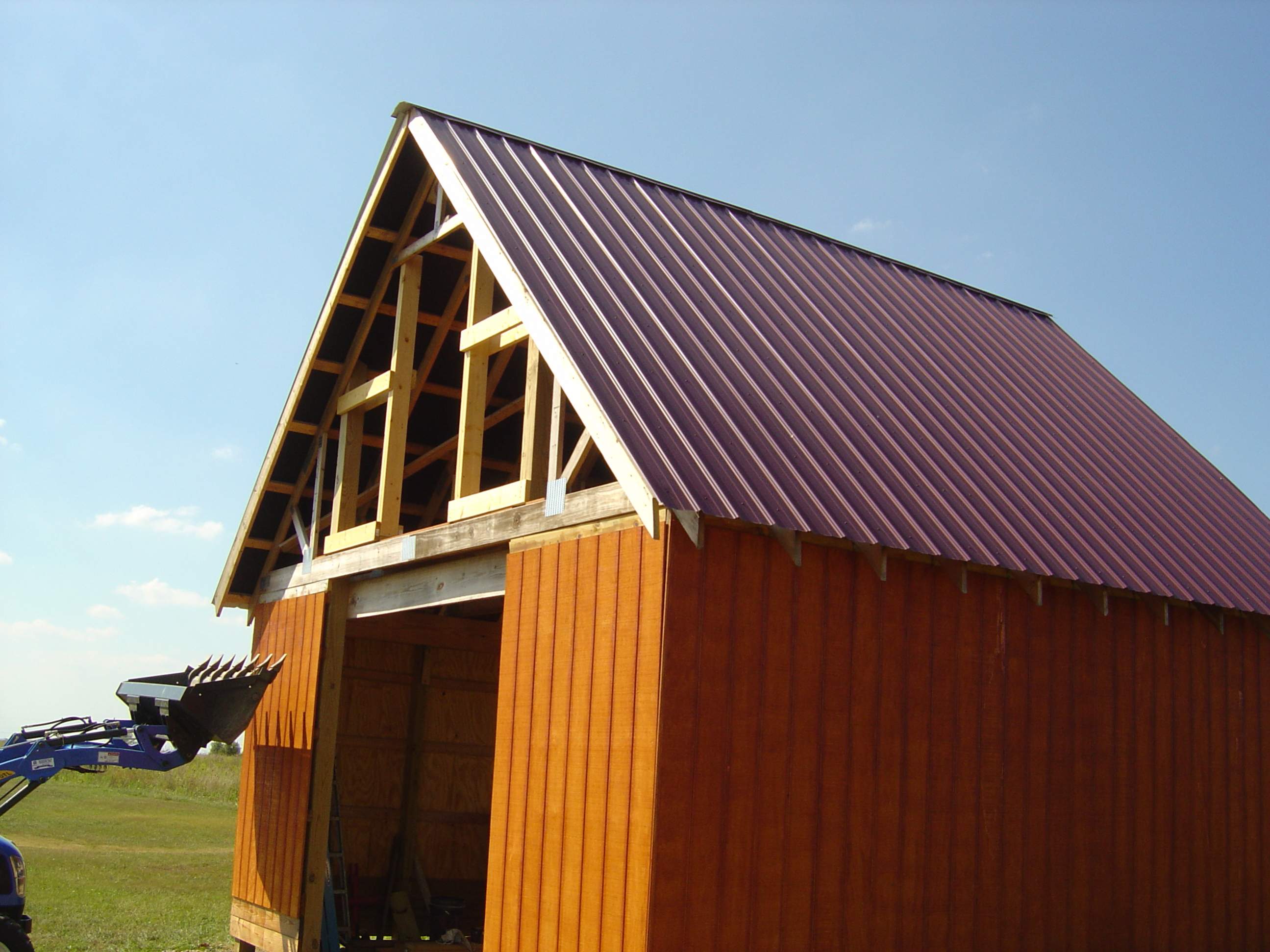

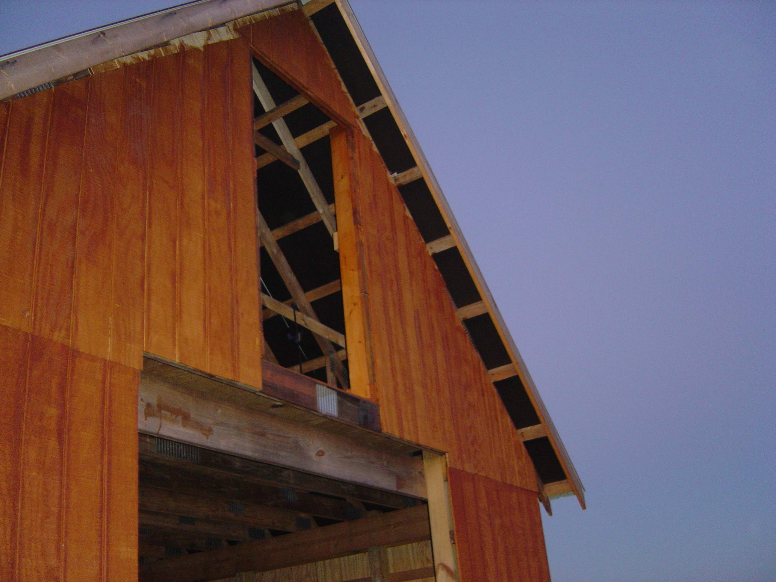

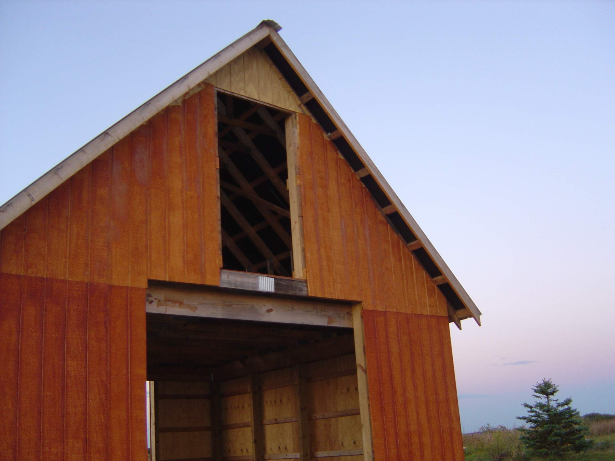

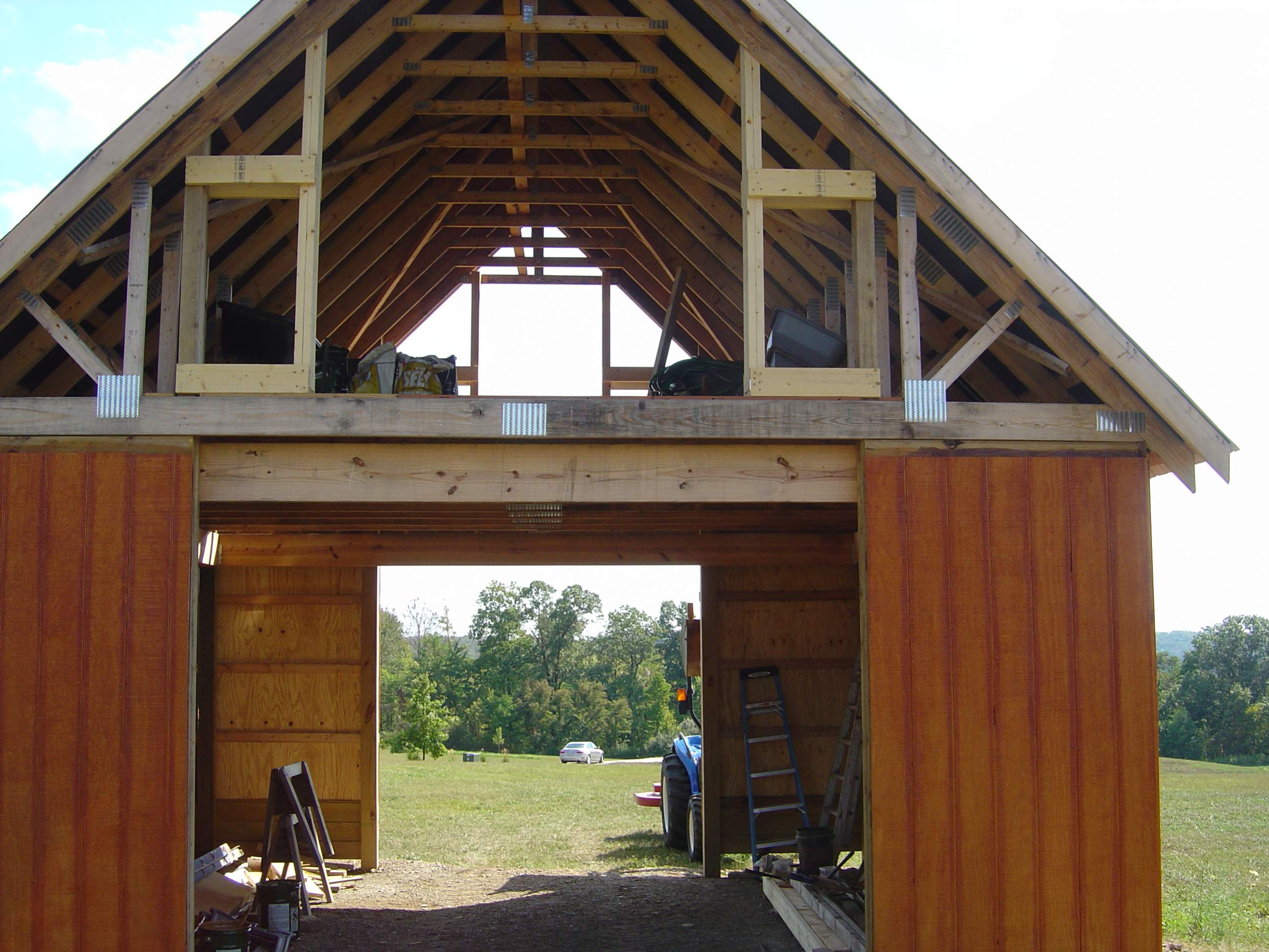

The loft doors are almost framed in, the front loft door is 4 ft wide, the back door is 7ft (two 3.5 ft doors). All of the siding that is up has two coats of stain, and I have started putting up the second story siding. I also have added some structural strength to the purlins to help support the fly rafter.

I do actually have a couple of shed questions, as I'm sitting here drawing plans for the permit.
1. I see in one of your last photos, dsc04640, you have four long diagonal braces up in the ceiling of the attic space. How come? I mean, I know what they are for, but do you think you will need them? The roofing, along with the framing and posts themselves, doesn't provide enough stiffness?
2. In post #51, 2nd photo, dsc04575, I can see what looks like roofing felt or some sort of moisture barrier beneath the metal roofing and the top surfaces of the purlins. I looked back through the thread and didn't see any mention of this. Is it felt paper? or something else? Is it there for condensation on the underside of the metal? or some other purpose.

As for your questions, I put the diagonal pieces on the day I set the trusses, and just left them. They gave the trusses quite a bit of rigidity when I first put them on, prior to the purlins, etc. and aren't really in the way of anything, and I can get a fair amount of wind, so I thought they wouldn't hurt anything by staying.
Keen eye, yes I do have felt paper under the metal roof for condensation purposes. It is standard 35# paper (I think I have the number correct) that you can get a Lowe's, etc. It was an inexpensive barrier.

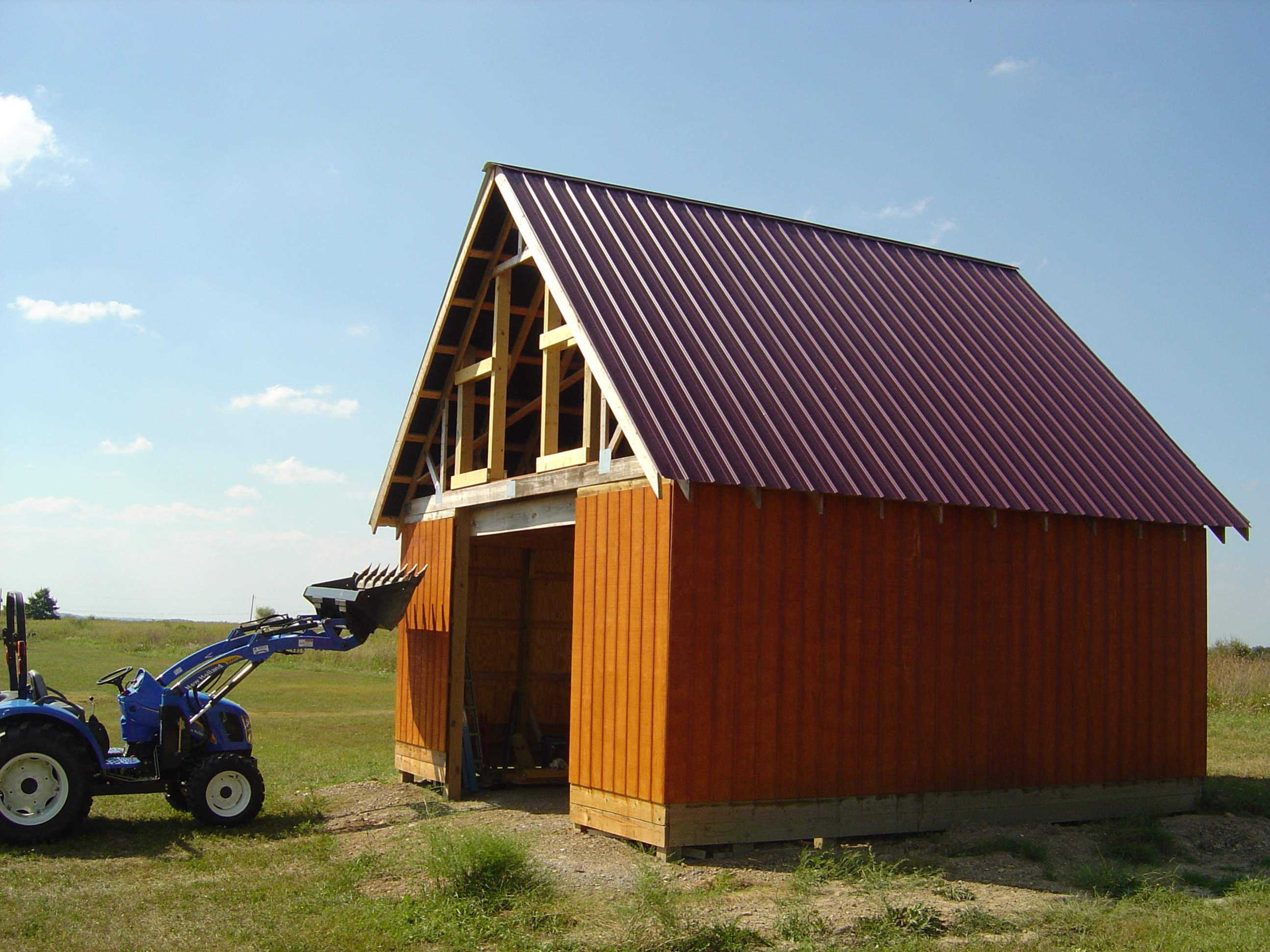

The siding is complete, I finished it over the weekend, except for a small piece on the back of the building over the 7ft loft doors. I started staining the "second floor" this evening. I goofed a little on some of the angle cuts, so I added some scrap pieces above the siding to make sure I had something to attach the j channel to for the soffit. These will be hidden with the soffit.

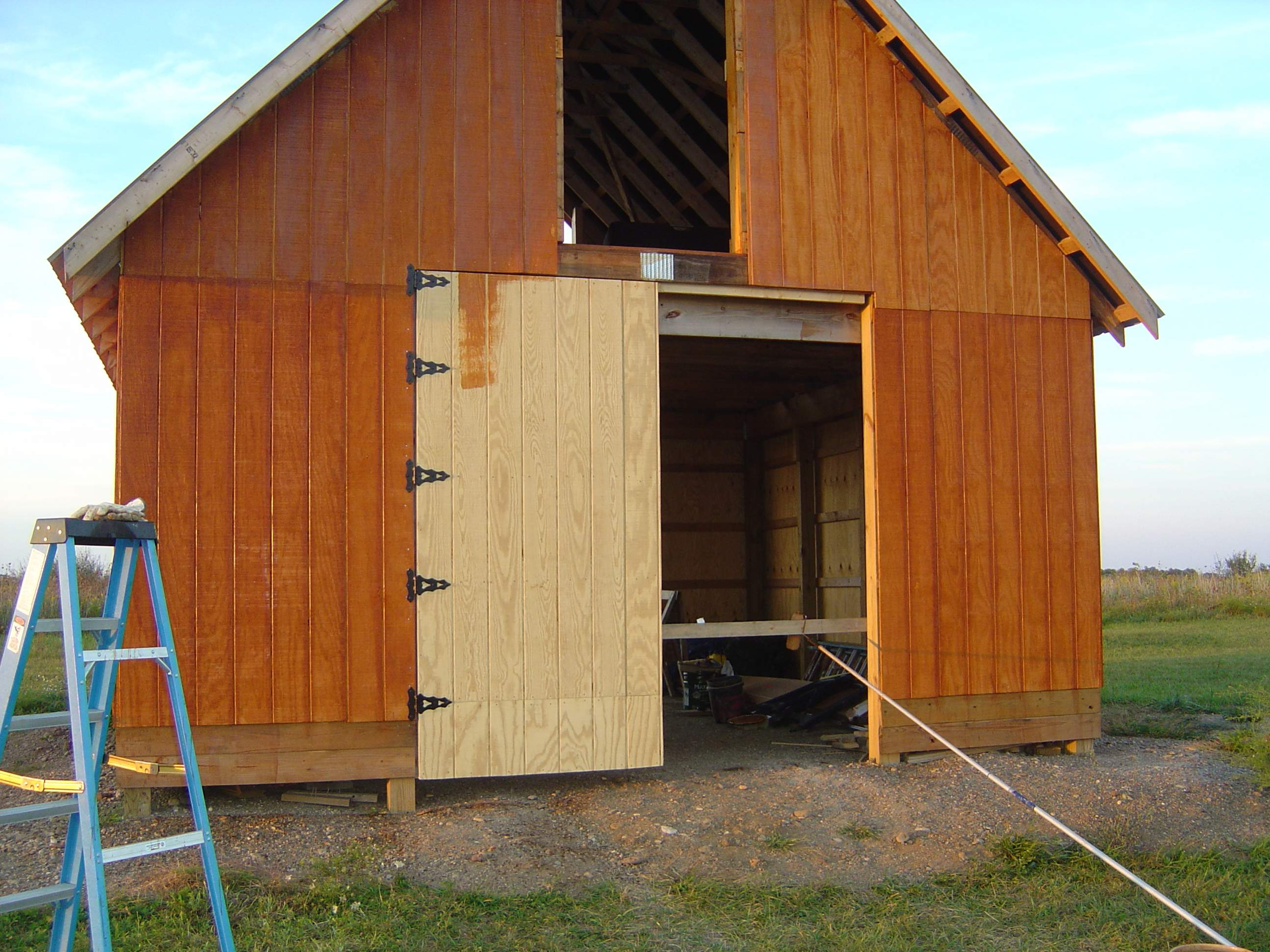

I got one door built over the weekend, I took a picture of it last night while I was doing some staining. 7 more to go...
I will eventually put trim on it to make it look like more of a traditional door, but for now I wanted to just get them up to weather proof the building.
I used 2 inch wood screws on the door.
The back of the door is pretty basic, just some bracing and additional blocking for the hinges.
Sorry for the poor picture quality, my camera is slowly failing, and I need to get another one.
The 2x4 going across the door is hold the door shut for now, until I get the other door built. I still need to think of a way to secure them until I get the cement done, which will probably be in the spring.
