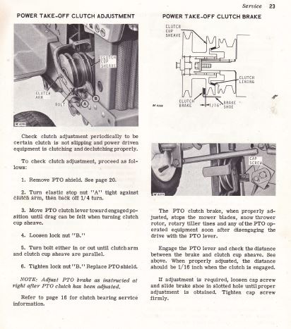

My 1973 mower has ran great. The 12 HP kohler still runs fine. PTO on motor is not engaging to turn the belt to the mower. Not electric clutch as it is just a lever. You Tube no help. Thank you for any help.

A pic of the cluch arrangement will help. And more explanation of what is turning and what isn't would also help.

Do you have the operators manual for this machine?
If so, there should be some help finding your problem in it.
Here is the PTO adjustment for a JD112 tractor.
Richard

The pulley & belt that goes to the transmission is turning as it runs fine. Outer half that runs the mower is not turning. I have operators manual pages 34 covers PTO linkage, page 35 PTO clutch brake. Has all info there. Working long hours, thank you for input. Now to figure sheave setting at 0.030 inch.
