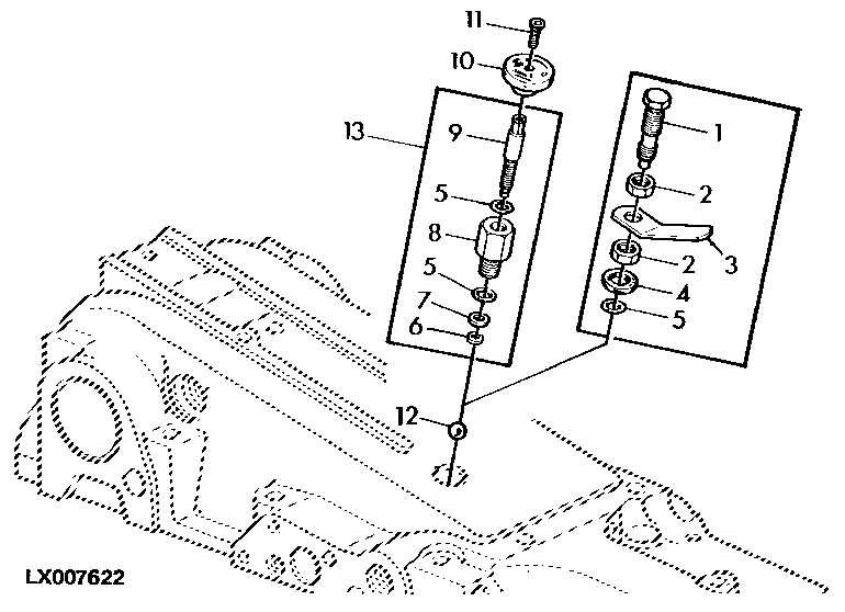

Jun 5, 2015 / 2150 jd #1 D dro46 New member Joined Mar 19, 2014 Messages 2 Location henderson tx Tractor 2150john deere lift raised to top and will not lower
Jun 5, 2015 / 2150 jd #2 J_J Super Star Member Joined Sep 6, 2003 Messages 18,973 Location JACKSONVILLE, FL Tractor Power-Trac 1445, KUBOTA B-9200HST Check your descent knob. Turn left to open.
Jun 6, 2015 / 2150 jd #3 Tx Jim New Member Joined Jan 26, 2007 Messages 10,400 Location Coyote Flats,Tx Tractor JD 4255/Kubota M7040 HDC I agree with J_J BUT JD 2150 could have a hex stud or wheel for rate of 3 pt drop depending on serial number which changes at SN 517544 Attachments LX007622_______UN15MAY95.gif 11.4 KB · Views: 95
