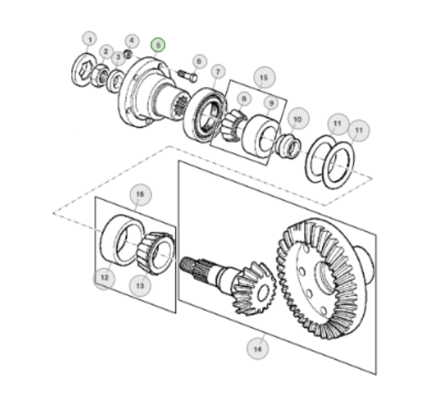

Update. I found one place that had the appropriate DIN 6 hold flange for the front axle. Turns out JD used a standard metric flange of 100mm OD, Pilot 57mm, bolt circle 84mm, number / size of holes 6, 8mm. I only found one US driveline shop to supply this flange and the appropriate 1 3/8" 21 spline, and they are building the drive shaft now. I spoke with my local automotive trunk driveline, transmission shop and they recommend for AG stuff to call these guys. Chuck was super helpful.
DRIVE LINE SERVICE OF FRESNO.
I'll update once installed. I will fabricate a appropriate drive shaft protector that will protect the shaft going through the woods.
