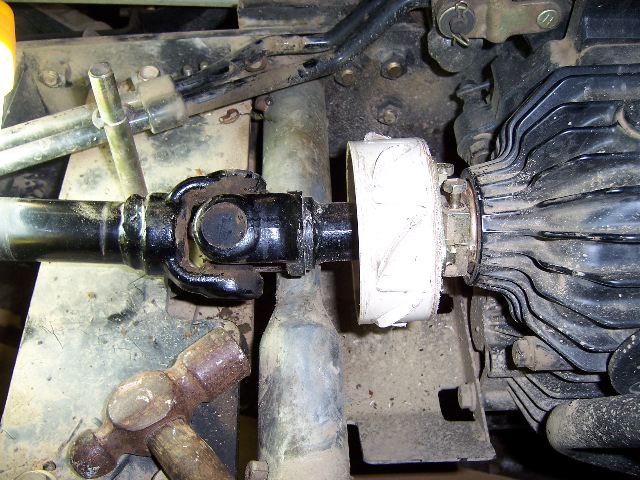

Figured out how to get the MMM knob off- floorboard off, still cannot figure out how to get the old fan off- there does not seem to be any way to slide the shaft to make room to get the fan off. any ideas? pic attached.
in another thread this was mentioned, but I cannot seem to find this on my 2210:
myersjc said:
Replacement of the fan can be done without splitting the tractor. I replaced mine by removing the floor board, fender, and ROPS. From there you will find cover over the flywheel on the right hand side. If you remove tht you can get in and drive out the roll pin holding the driveshaft in place on the splined shaft. Once the roll pins are removed you can slide the shaft on the splines enough to remove it without having to move the transmission or engine. Taking the ROPS, fenders, and floorboard off is not a bad job. It only takes about 30 minutes
There doesn't appear to be any cover on the flywheel accessable unless I take off the dashboard.
   / 2210 hydro cooling fan #14
I believe you may need to split the u-joint by pressing out the cups.
   / 2210 hydro cooling fan #15
Ray2210 is right, the best way I found was to take apart the universal joint. I initially tried unbolting the drive shaft from the engine & sliding the shaft forward, but there wasn't enough play to get the shaft off the male end of the hydrstatic rear end. Here's how you take apart the universal joint:
1) Remove the 4 Clips from the unversal joint.
2) GENTLY tap the cups in one direction until one cup sticks out & can be removed (I could just take them off with my finger once they were exposed).
3) Push the joint the OTHER way & remove the second cup (should be on the same axis as the first one you removed).
4) Now push the joint along the other axis to remove the third cup. Once the third cup is apart, I could remove the center piece of the universal joint & the joint was apart.
Be VERY careful with the cups as they contain the bearings of the joint. You don't want to loose any parts or get dirt in the bearings. Once you get the first cup out, it will all click & make sense how it goes together & comes apart.

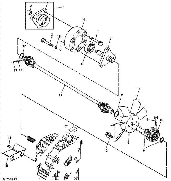

I don't know how to link back to an old thread, so I pasted 2 posts from an old thread here (see below). This is how I got my fan repaired. I took these posts, and a diagram of the 2305 driveshaft which I downloaded, to my dealer. He used this approach, and had my fan replaced the next day. You don't have to disassemble anything except the rear universal joint in the driveshaft. Hope this helps.

here's a diagram of the 2305 driveshaft
