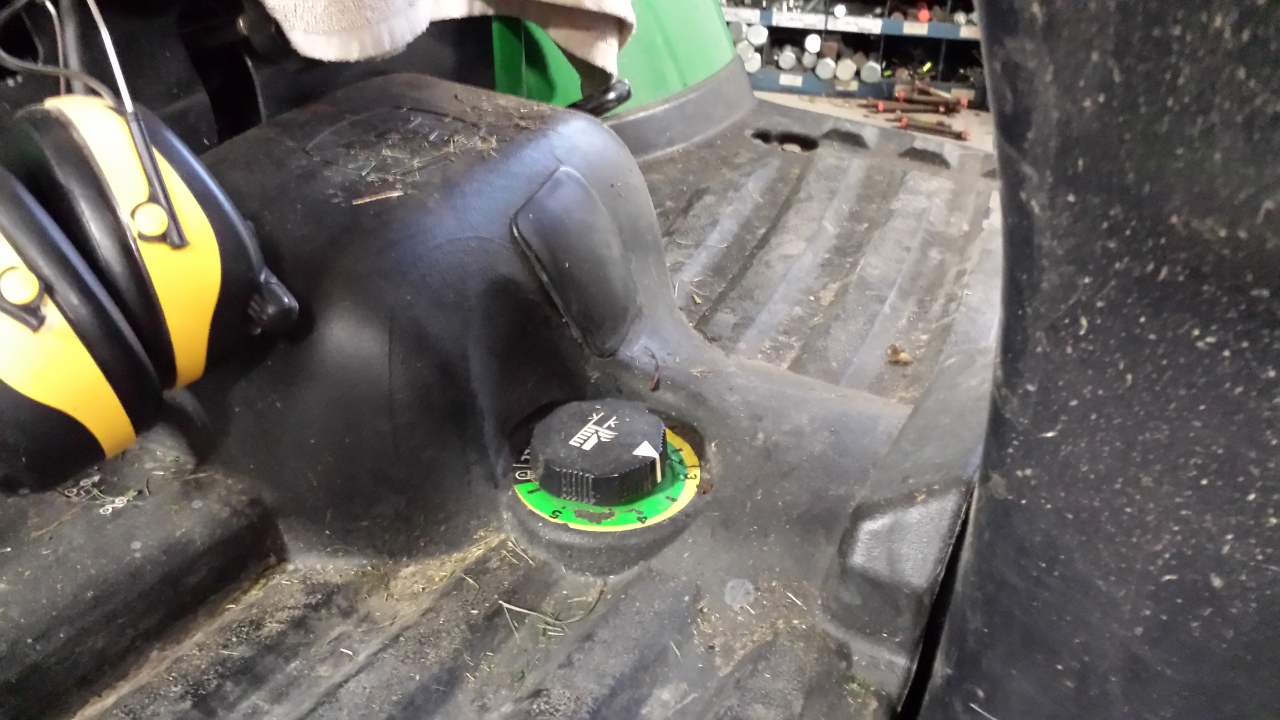

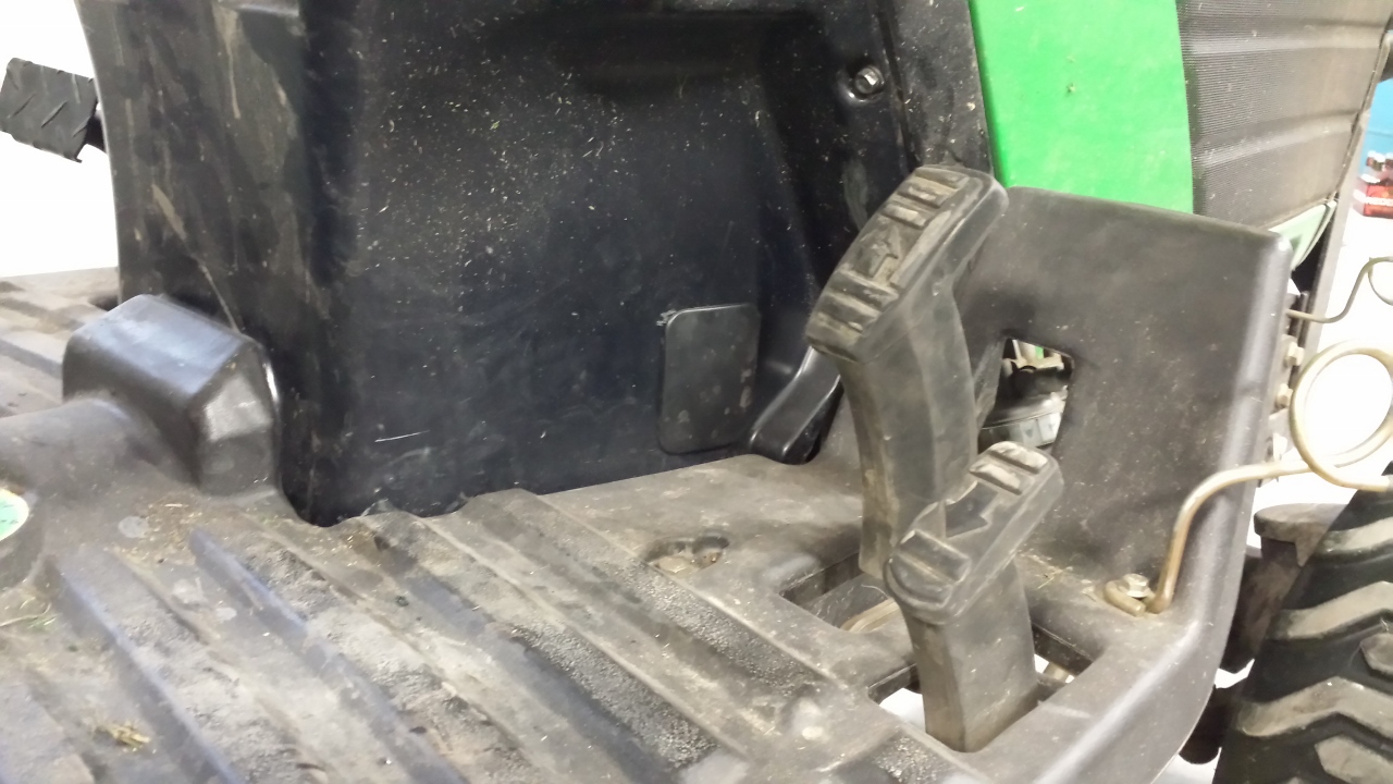

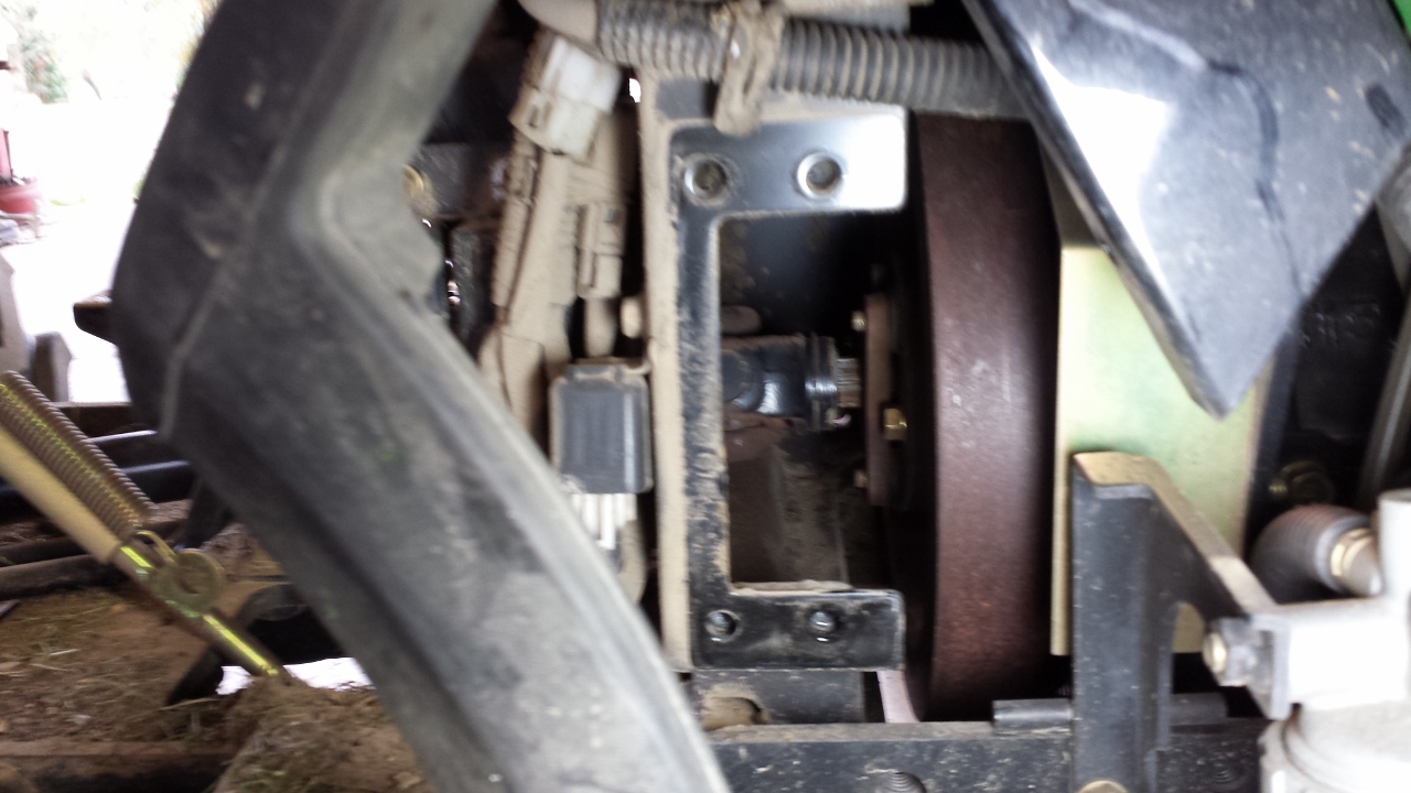

Let's see if I can help ya.
First I cut a square hole in the floorpan, center, over the rear u-joint. Cut the right size you can buy the JD rubber plug to fit. That let's me reach the rear u-joint zerk with a needle fitting.
Then I removed the plastic cover below the steering column, then cut away a portion of the metal framework, then cut another square hole in the plastic with factory plug to close it, this allows me to reach the front U-joint.
These two modifications allow me to grease both joints. I grease them every 30-40 hrs or whenever I remember. :)
View attachment 446891View attachment 446892
I also did this. Still a PITA but at least it goes from impossible to possible.
