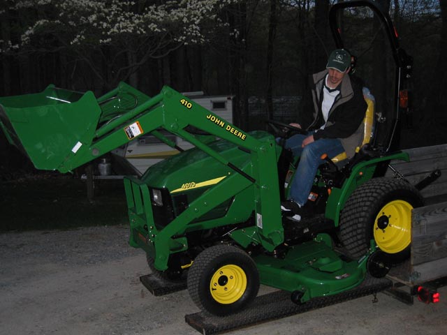

I just brought my 4010 home after going through these same decision points.
Bob_In_MN summarized it very well. In my case the total package difference was about $500 more for the 4010 which seemed like more of a tractor. The capacity of the FEL was a selling point.
Another selling point for me was the dual brakes. Sometimes it's nice to be able to use the "inside" brake to help turn the tractor around, and the 2210 doesn't have this feature.
A third point was that with the 4010 I could add auxilliary rear hydraulics, and it wasn't available for the 2210.
Also, the 4010 has a tachometer and the 2210 doesn't.
A disadvantage of the 4010 for me was the height adjustment for the mid-mount mower, but this shouldn't be an issue since it's not on your option list.
I'll try to attach a picture, since 4010 pictures seem hard to find! Good luck with your purchase.
