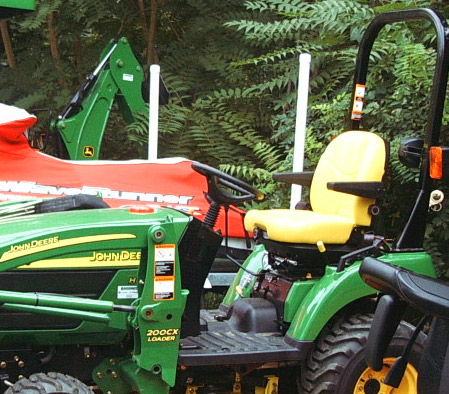

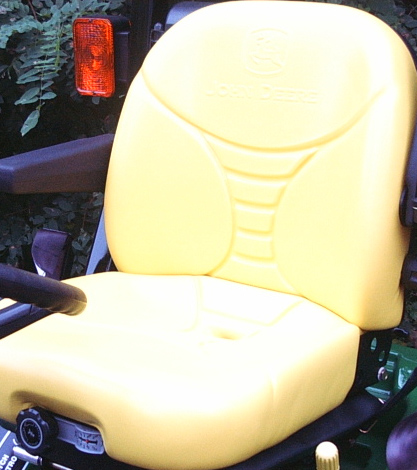

I added a X special edition seat to my 2210 today It was really easy to do . /forums/images/graemlins/laugh.gifAnd let me tell you what a difference it makes!!!!! /forums/images/graemlins/wink.gifThis should be a factory option.It has a adjustable suspension and lumbar, And also has arm rests! /forums/images/graemlins/smile.gifThe hardest thing with the install was mounting the seat switch.I will try to add pictures if the files are not to large. If not I will retake them.
JIm

   / 2210 with an X seat -again #18
Here is another picture! /forums/images/graemlins/smile.gif

RRacing
How much did it cost to put this on and did it include a whole new seat suspension?
