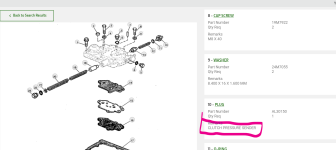

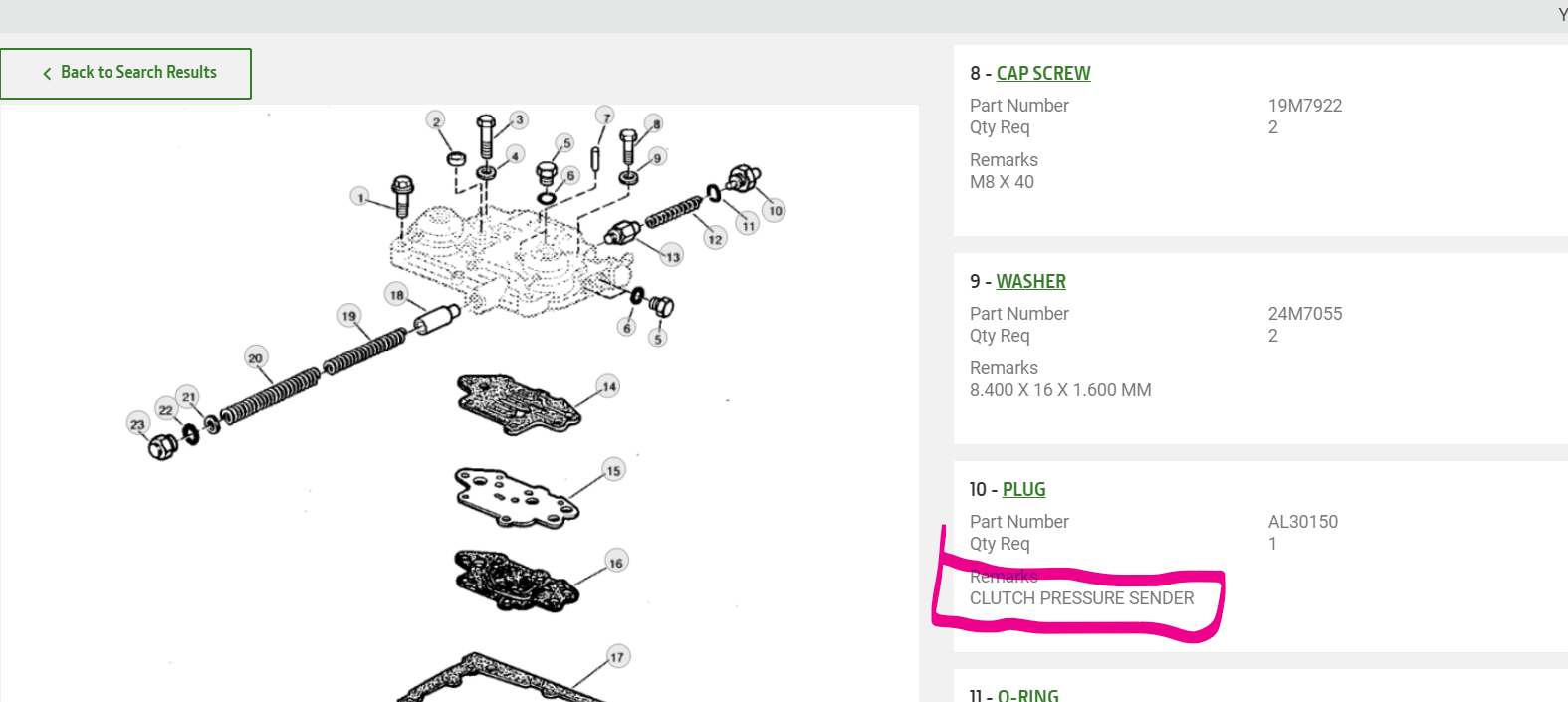

Then the PTO lever will only stay in the up(engaged) posision when the engine is running.
When shutting off it will stay up for about 2 seconds before dropping to neutral.
   / 2240 electrical questions and PTO lever questions #12
That switch is to indicate oilpressure for the lowpressure hydraulics working your PTO ...MFWD and HI-LO if installed.
There is a neutralswitch in the starting circute and that is on the rockshafthousing under the plate that covers the gearlevers.
Ditto I agree switch indicates trans pump pressure to ensure correct pressure for hyd hi-lo & hyd pto. JD is very proud of their neutral start switch @ $52.58
   / 2240 electrical questions and PTO lever questions #13
Are you referring to open station or cab tractor on pto lever operation? I was thinking OS tractors the pto lever had detent balls to hold pto lever in set position? I have no experience with 2240 cab tractors.
Thanks,Jim
