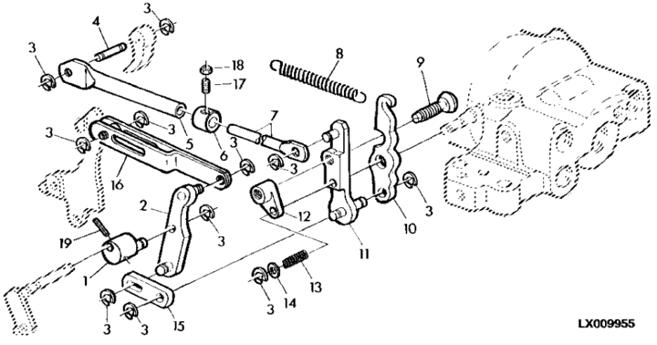

Only trick is getting L/D control cam relocated correctly in 3 pt operating linkage

Before pulling the rockshaft cover put the load selector lever in "L"
Tighten cover bolts to 85 lb ft when reassembling
   / 2240 Shift Shaft/Fork Replacement #13
Zebrafive
Granted it's been a long,long time since I was a JD dealer service manager BUT please explain why one needs to put L/D in "L"? I thought "D" setting removed the most tension from rockshaft control linkage and L/D cam.Thanks,Jim
   / 2240 Shift Shaft/Fork Replacement #14
That's the very first step in the service manual. Put selector lever in "L" No explanation why
