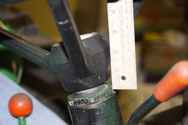

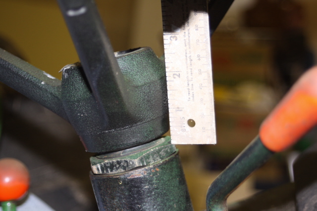

Has any body ever torn the steering column out of a 2240 and rebuilt it? I just bought a used JD 2240 with three major problems for me to fix. The first one is done and now it's time for the steering problem. I have about a full wheel turn of play in the steering. When I took a close look tonight to identify the problem, I found the the steering wheel and shaft rises or lowers about 1/4 to 3/8 inch as you turn the steering wheel before the wheels start to turn. I'm assuming it is a problem with one of the thrust bearings in the shaft. Anybody have any warnings or advise?

OK, here are pix of what I found when I turned the wheel from one end of the slop point to the other.
I'm thinking that it might have something to do with one of the thrust bearings or the associated snap rings.
Anyone have any other ideas?

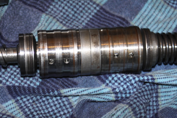

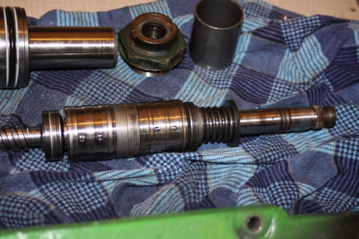

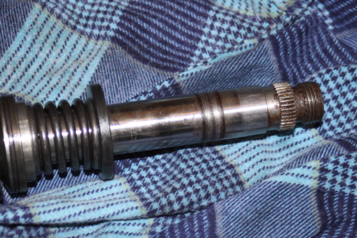

OK here's where I definately need advice. I'm in new territory here.
The shaft has some minor pitting and wear that I can feel with my fingers where the upper seal rides on it. Should I replace the shaft because of it?
Also, where the O-rings ride on the outside of the valve body assemblies, ther are black marks left from the wear of the old O-rings. I assume that this needs to be cleaned off so that the new O-rings will seal correctly. How do I clean it? I was thinking to do it with emery cloth. Is this correct? The old O-rings that seal around the valve bodies are worn about 1/2 way through and one was broken.
Besides the O-rings and seals which come in the rebuild kit and maybe a new shaft, is there anything else I should be evaluating for replacement?

Try using a solvent like lacquer thinner first to get the black of, if that does not work then try very fine Emory cloth-like 600 or so and keep it lubricated with mineral spirits-you just want to polish it, not remove material.

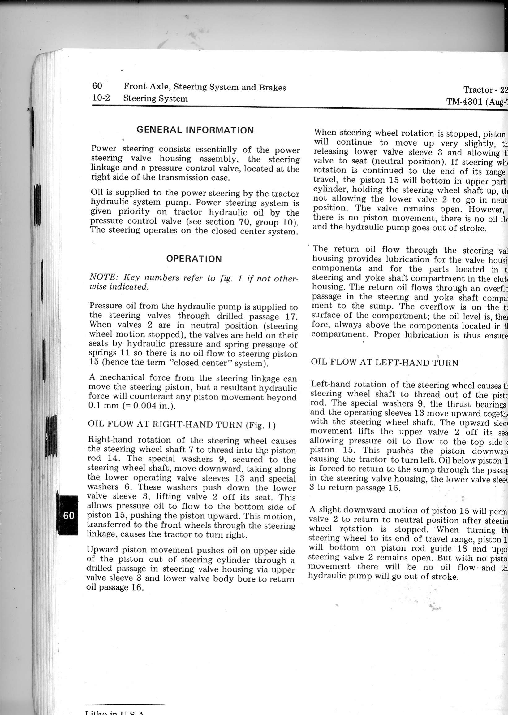

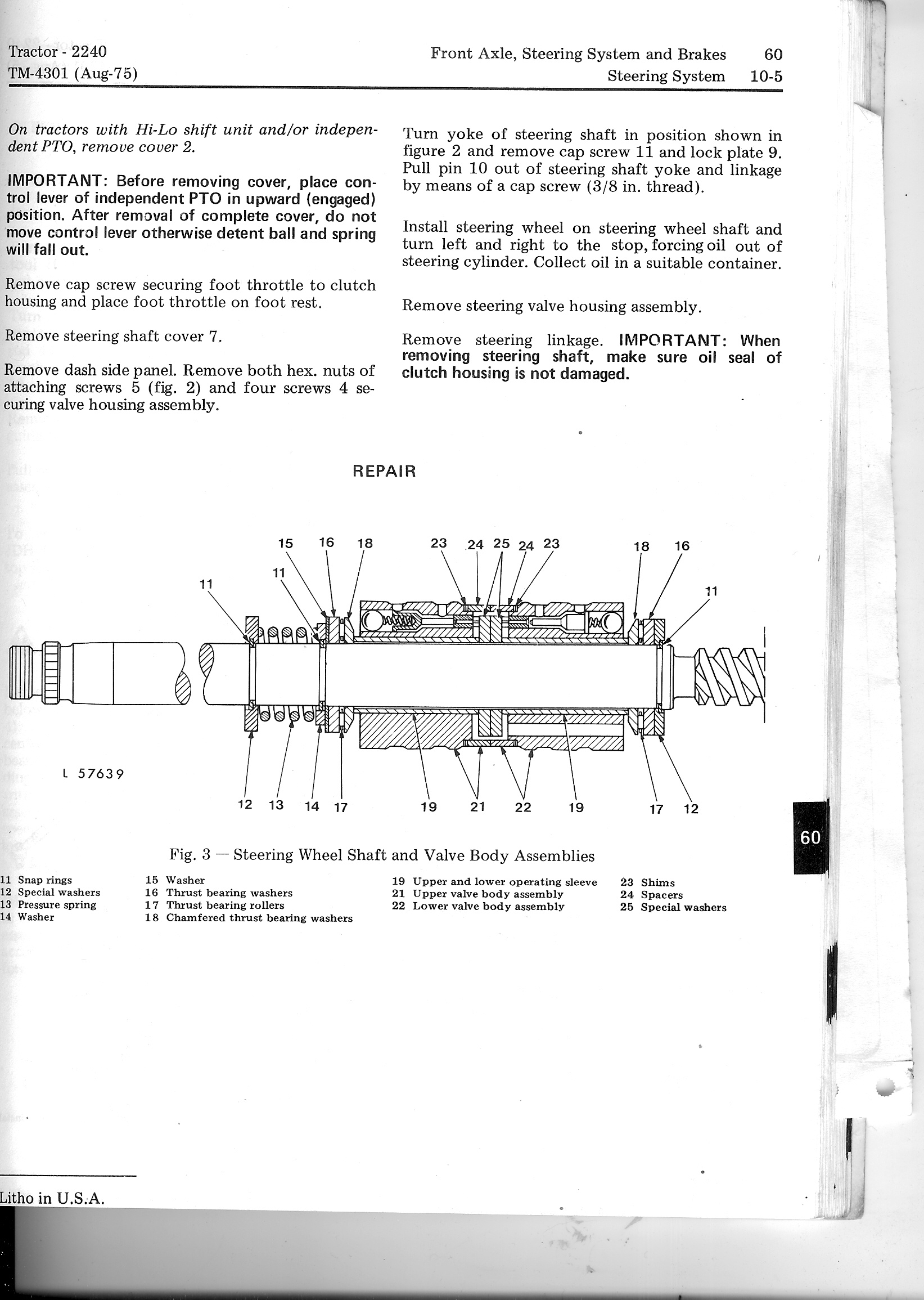

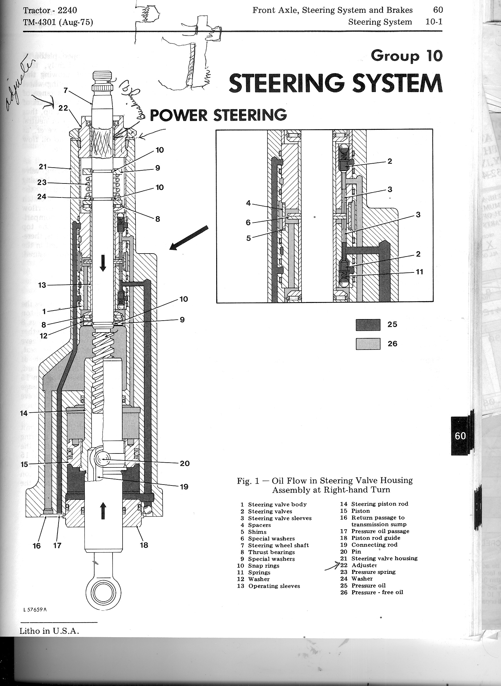

Here is what I have from the tech manual.
/ 2240 Steering rebuild
#12
Let's try this again with the correct picture.

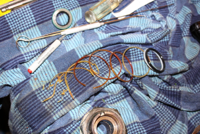

Here's a pic of what I found to be left of the O-rings after I took the steering housing apart. Most of my steering problems should be related to this. I'm going to have to really be careful to make sure I get all the pieces cleaned out before I put it back together.
/ 2240 Steering rebuild #16
Hey, Cyril...just saw your thread. Looks like you are on the right path
toward getting your steering fixed. It looks like you have found your
cause of failure (O-ring). Since a new valve shaft is hundreds of $
from JD, I would reassemble the valve as carefully as you can using all
the new parts, and keep everything super-clean. This means be careful
what kind of rags you use...leaving lint fibers behind is not good. Any
carb-friendly solvent should be OK to clean things...don't use acetone
or some of the other more aggressive solvents on rubber or plastic parts.
As for testing the final assembly, you will most likely find it much easier
and better to test it in the system, not separately. Any external testing
would likely only find external leaks. Internal leaks would not be visible.
None of my JD tractors ever had a PS problem; the only PS system I have
rebuilt (Kubota) was totally different.
I am a big fan of pressure washing BEFORE anything is opened up....its
kind of like disinfecting before you start an operation. I try to avoid
hitting things like switches and guages, however. And greasing/lubing
afterwards.
As for fitting new seals over pitting or rust, that's a tougher call. You
may have to polish up that area before final assembly.
Good luck.

If there are no pits in the shaft, only discoloration a machine shop can chuck the shaft in a lathe and use "Crocus Cloth" to return the shaft to it's original shiny self. I don't think I would use "Emory Paper" on the shaft, it will leave scratches.

I think so. My current thought is that the O-rings leaked bad enough that I didn't get any steering responce until I had the valve body against the thrust washer at each end of the action.
The way my steering works, the steering shaft threads into the steering piston. As you turn right, thread shaft into the piston, you open the valve in the lower valve assembly, allowing high pressure fluid access to the lower side of the steering piston and allowing fluid to escape from the upper side of the piston back to the resivoir. The valve opens proportionate to how far the shaft moves downward. Fluid continues to flow until the steering shaft and valve return to a neutral position, closing the valve. The raising of the steering piston turns the steering shaft and pitman arm causing the wheels to turn right.
Turning left is just the opposite using the upper valve assembly and fluid to the top of the piston as the steering shaft rises.
The O-rings which came out in pieces were the two lowest in the assembly. I found an area in the tech manual which states that "drift is usually caused by steering valve or O-ring leakage in the circuit of the steering direction affected". (It's interesting that each time I go through the manual, I find something I missed before) I didn't drive it much before I got it home and started working on it - never out of 1st gear. While I had it in my shop, and before I removed the steering housing, I did note that it would turn right when you increased throttle. At this point, I suspect that had I driven it much, I would have found alot of drift both directions and right being more common. Close inspection of the O-rings shows the inner surface to be quite worn. The worst of which, on a cross section, have vearly 1/2 of the O-ring worn away.
I think that I had so much leakage that the valve had to be all the way open before I got enough pressure to move the steering piston. Hence, extreme right to extreme left before movement occured either direction.
