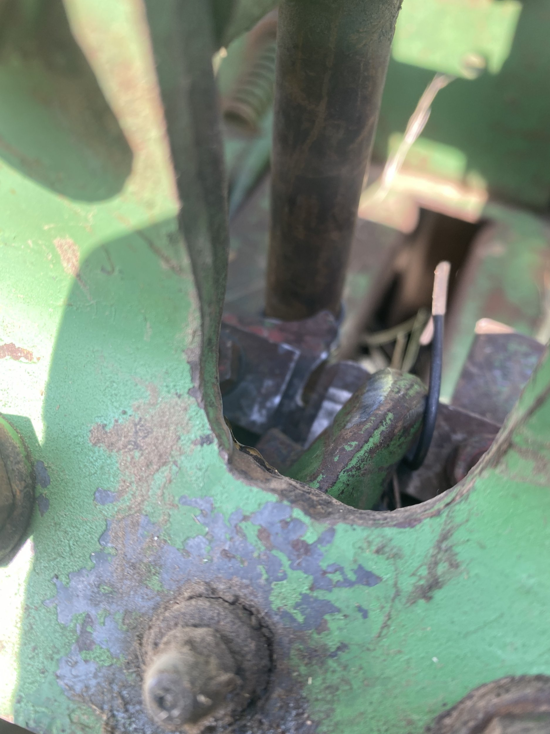

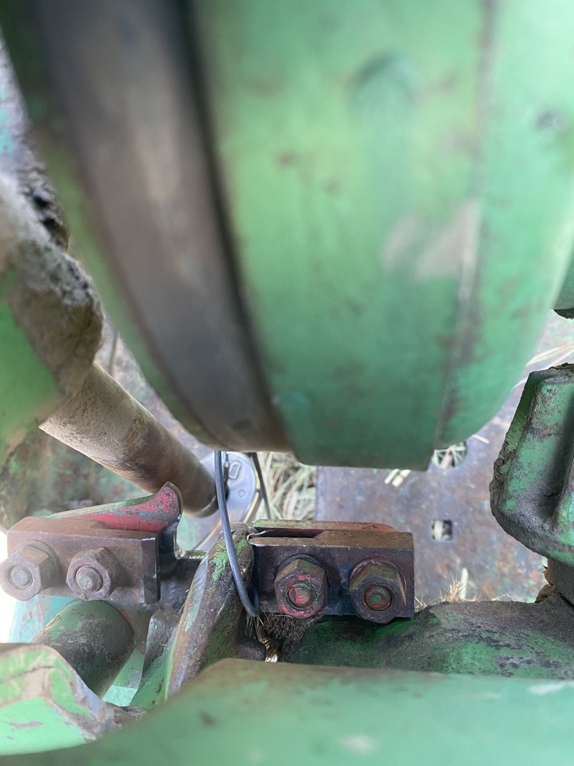

All right this baler giving me headaches again. John Deere 224 wire tie. Anybody see any problems with the knotters?

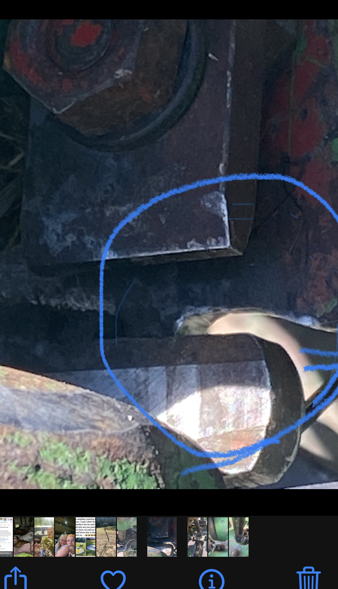

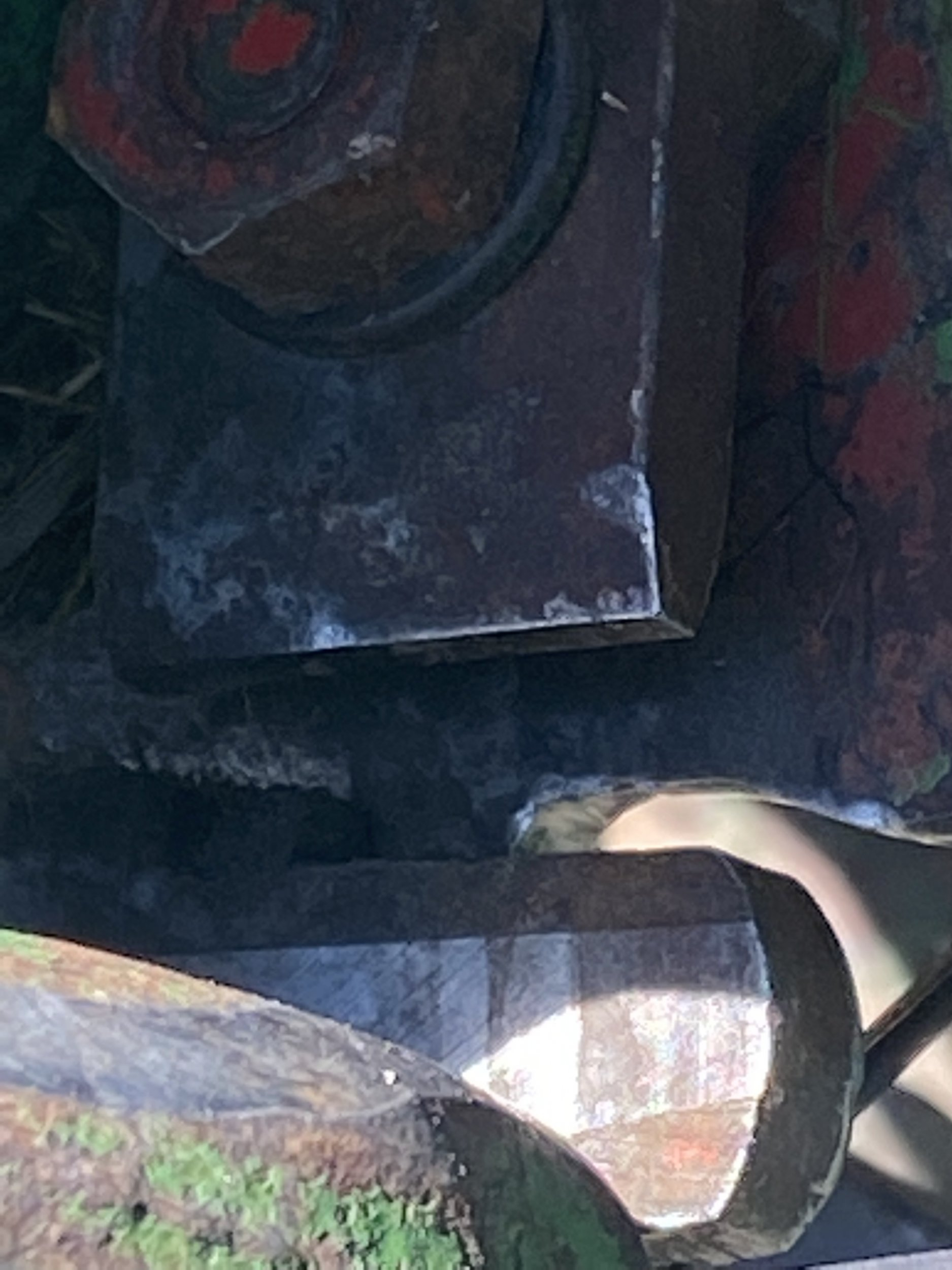

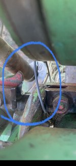

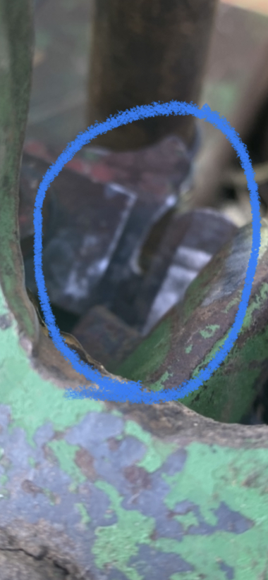

I circle what I might thank could be problematic.

Wire in your photos appears dry. Have you added any oil to the coils of wire in the boxes? With needles in home position where is the point of twister hook located? Point of twister hook in your photo below looks to far towards flywheel side of the baler. Initially point of twister hook should be directly under wire gripper pivot bolt. I can't determine what you're indicating in your last 4 photos. Does twister shaft have a groove or is it smooth?
