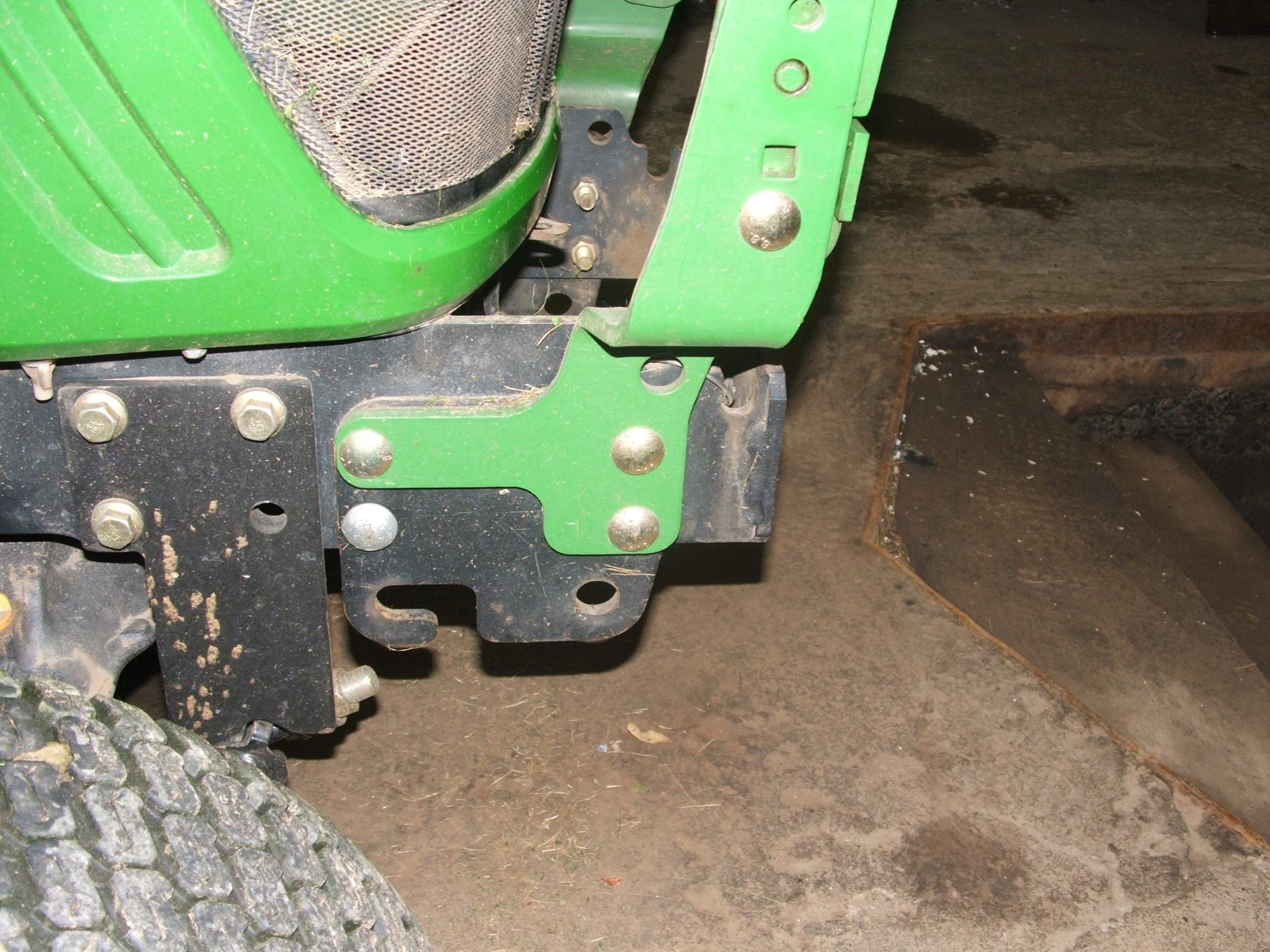

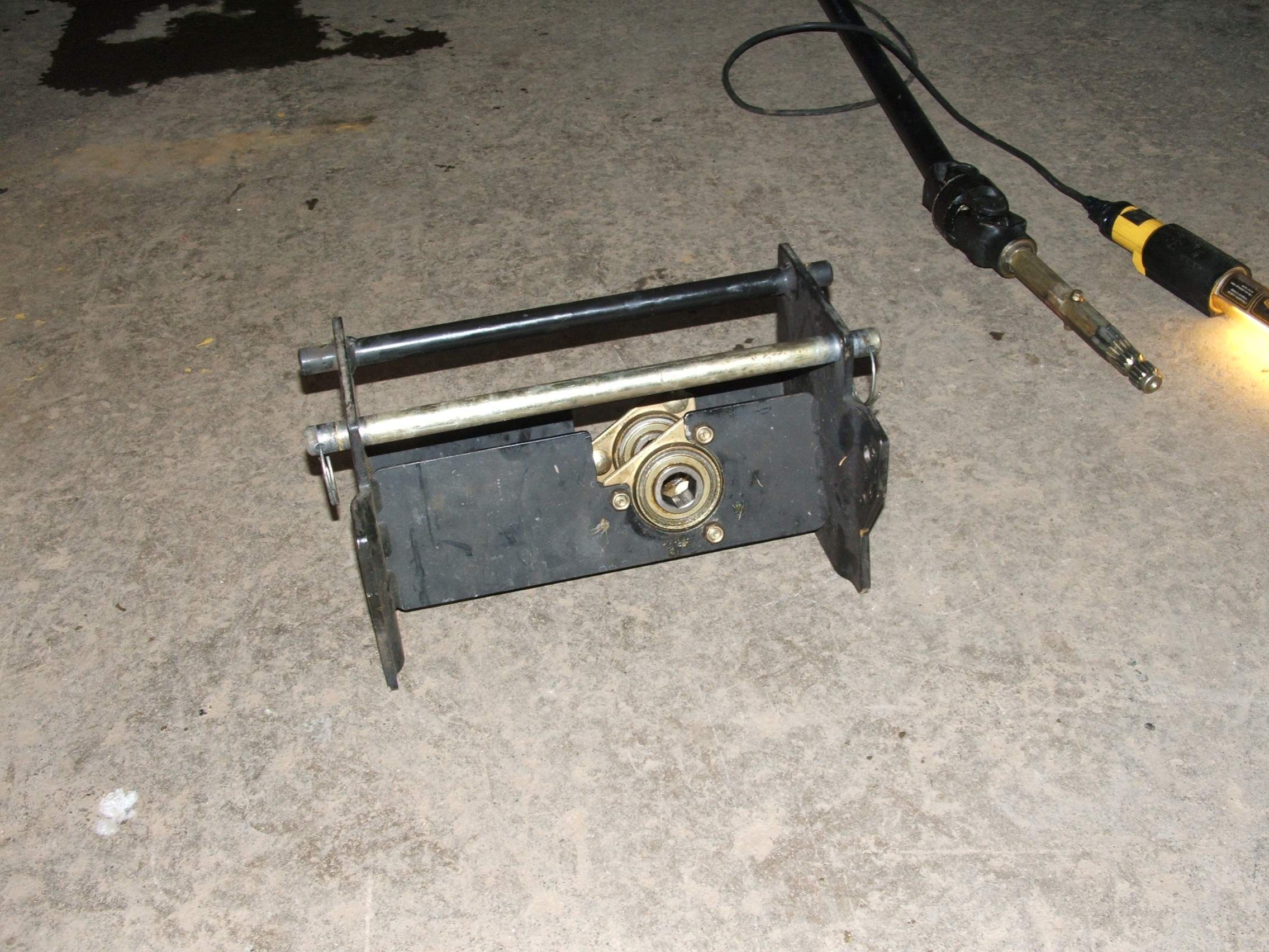

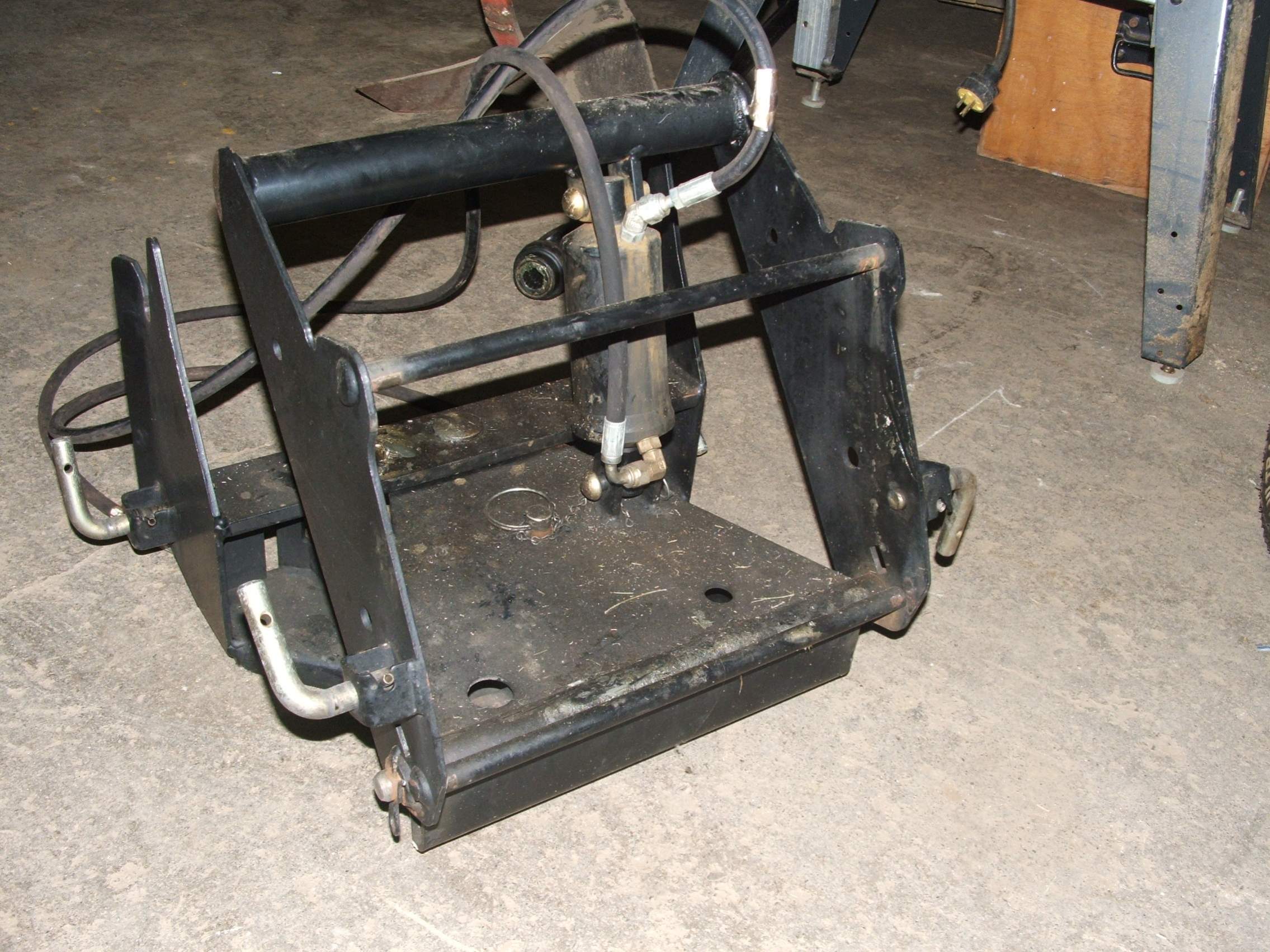

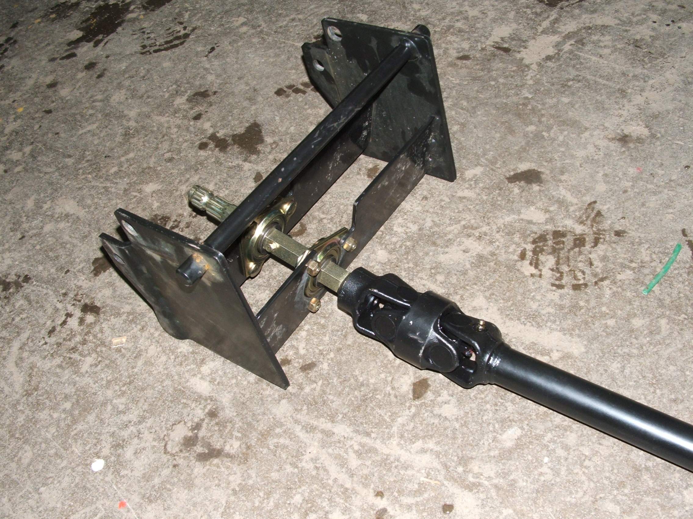

Yes, does are the plates that you need. Pretty sure they are the same for the 2305 and 2320. You also need the drive shaft that connect to the middle PTO. I don't see it in your picture. Here are a few picture of my 2305 snowblower attachment.

If you visit jdparts.com you will see they have different kits and would not be interchangeable.
   / 2305 and 2320 front snowblower quickhitch the same? #7
Hmmm, what makes you think that the 2305 plate mounts would fit? If you look at the link that you post, #14 is the same part number for the 2305, 2320, ect.

The piece you returned is what you want as it allows tool free switching between mower and front hitch. The returned piece would require a mower bracket that is quick release style but it should come with that frame you returned. Check LVB24899. Otherwise item #14 is for the front hitch only and you will be wrenching these brackets on and off along with your mower brackets as you switch between mower and front hitch.
