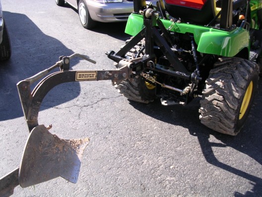

I'm using a 10" Brinly plow I used on my other garden tractor.
it is doin a fine job. I have enough power to pull a larger plow but this is doing a fine job. You can also adj. to for how deep you want to plow. You don't have to full with the three point lift. You drop it all the way and the plow set's the depth.
