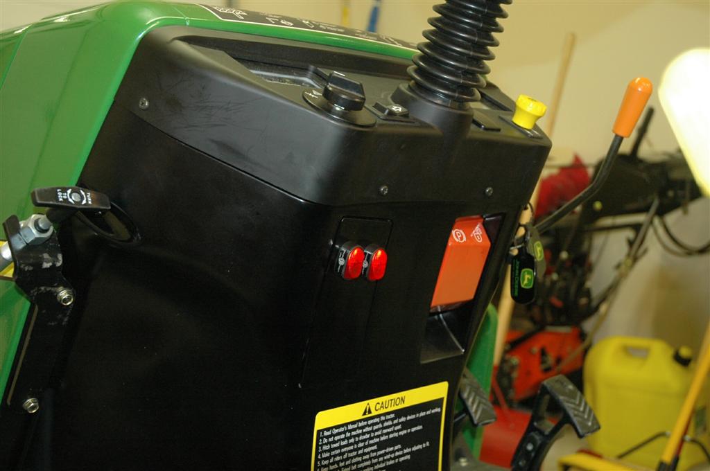

Personally I want my rear light on as well as the flashers when I turn around on the road blowing my drive so I installed two new switches to control my forward and rear lights.

Turbo: I like your idea the best. I thought about putting switches on the forward lights but the only blank in the dash was for the Cruise control (Which I don't have). Originally when I was worried about the load of the lights I was going to switch the front lights (Front headlights) also since with a FEL in use they don't shine too much.
Did you put the switches on the lights or on the dash?
/ 2305 Forward aux. Lighting Problem #7
I mounted them below the dash on the wrap around cowling located just in front of my left knee, I used lighted switches I got from from the local auto parts store. The switch rating was capable of directly powering the lights so I did not need to use a relay. I ran a wire directly from the battery connection on the starter with an inline fuse for protection. I will post a pict tonight.

/ 2305 Forward aux. Lighting Problem #10
This is how I mounted the switches , I figured if I didn't like them here all I had to do was replace the access panel cover and not the dash.

/ 2305 Forward aux. Lighting Problem #11
Turbo,
What is that handle for on the left side of that last picture?
Inquiring minds (and nosey people like me) want to know /forums/images/graemlins/confused.gif
/ 2305 Forward aux. Lighting Problem #12
That controls the angle of the deflector chute on the snowblower, I don't know how I ever got along without one.
/ 2305 Forward aux. Lighting Problem #13
I like those. A nice neat job. /forums/images/graemlins/wink.gif
