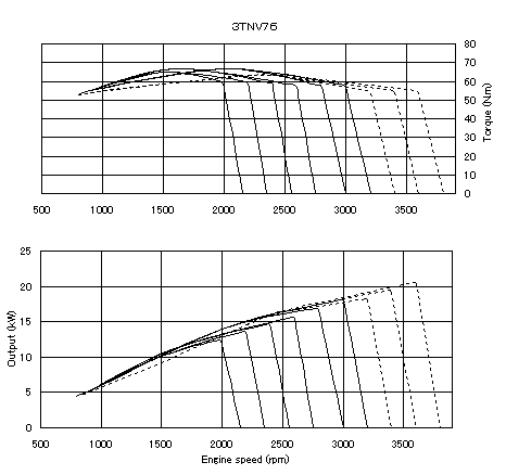

The specs in the manual and the brochure say 17.9kW/24HP but my engine says 18.8kW which I guess would be 25 HP. Anyone else have a 2305 that says something different than 18.8kW on the engine itself?
Not that one horsepower is a big difference but if my engine is really 25HP I'd like to know.
Anyone have any input on why the difference between what the specs in print say and what the engine plate says?

Hp at rpm. Both change with the throttle

Here is Yanmar's performance chart, which may also be out of date...
They rate it at 3600rpm for 19.5Kw(26.1Hp)
