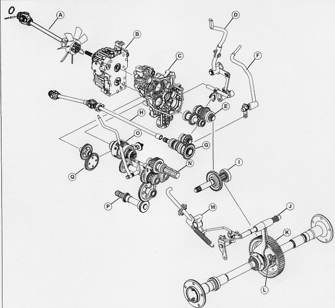

Make sure the cooling fan for the transmission isn't broken.

   / 2305 losing a bit of power. #7
I assume you cleaned the strainer and replaced the filter when you changed the fluid. Others here have more experience then me, but I would expect the low visc. Hy-Gard the thin out out high temperatures and lose some performance. My manual says its operating range is up to 104F air temp.
