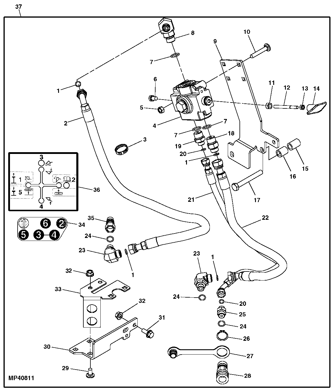

Hi all,
When I bought my JD2305 the MMM hydraulic lift was an optional kit, and unfortunately I was the first one the dealer ever installed; had a H---of time with it. Anyhow, since then, I've seen a couple of posts mentioning a "diverter valve" when talking about the MMM lift. Does anybody have any source of literature, pictures, links, etc. of this diverter valve and whether or not I should even think about installing it. Sounds as if JD has made some changes/improvements since I bought my 2305?

Prince Hydraulics makes the one I purchsed from Northern Tools. Having to switch the hoses when removing the mower deck was the one and only thing I did not like about my 2520. With the diverter valve installed, I am 100% happy.
Prince Hydraulics has a web site were you can look at the manuals for the valves they offer.

JD sells a manual valve, thought about buying one for my Hydrloic Top Link can't get the parts page to paint or I would give you the part #, IIRC the control lever ends up near the 4wd lever. why did you get the indpendent lift? bagger? do you mow with the loader on?
Part number appears to be LVB25822

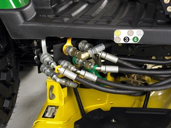

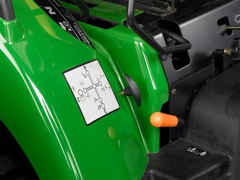

Raykos,
I got the optional diverter valve kit with my 2305 and it was also the first one my dealer had installed. Unfortunately, the brainiac who did the work installed the hydraulic lines backwards and also sloppily ran them right next to the pedal linkage for forward/reverse. This subsequently ate away at the hose jacket and also destroyed a linkage pivot bushing and associated hardware. I discovered it because I was noticing over time that it was getting harder and harder to step on the 'forward' pedal. I got under the machine and there it was so I removed everything and started over again. I'm supposed to bring it back to the dealer to have the linkage and hose fixed, but I'm afraid to let them touch it.
Anyway, in retrospect, I wish I hadn't gotten it. I never put the bucket on the tractor when the mowing deck is installed and vice versa. It's just been an unnecessary complication.
Last, it does nothing whatsoever to keep the mowing deck raised. If you look under the left side of the tractor, you'll see the cylinder that raises the mowing deck. You'll also notice a big long spring attached to it. That spring forces the deck downward without active hydraulic pressure against it. At first, I thought something was wrong with my machine because it would creep down as soon as I shut the engine down. I asked the dealer about it and they told me it was correct. If you want the deck to stay up, you have to rotate the height adjustment knob to the Lock position. That is what I do.
