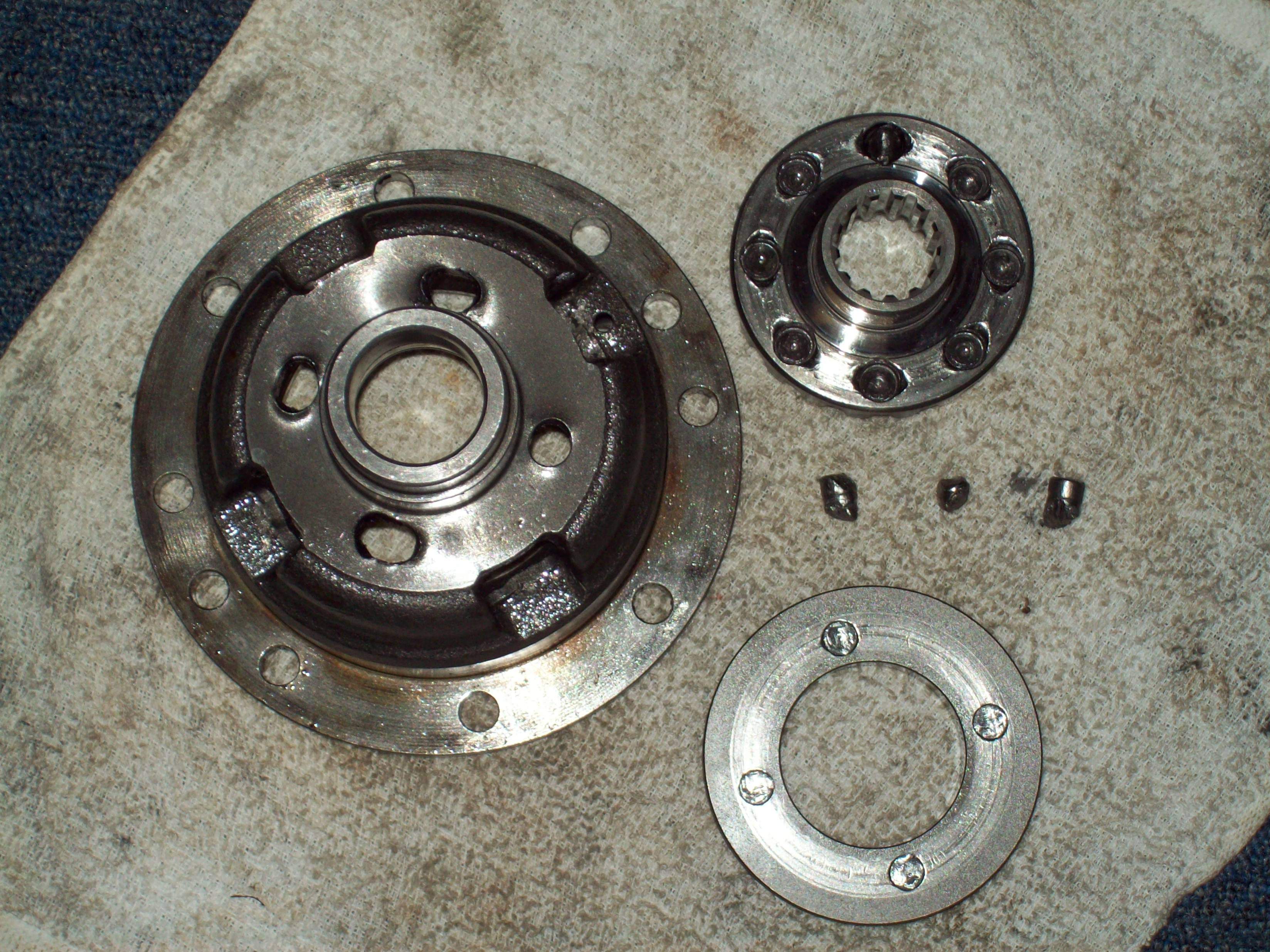

I stop, apply gentle pressure to the lock lever, gently apply hydro pressure and it drops in as soon as one wheel starts to spin. I have a little over 400 hours with much severe, 4 wheelin' type use, no issues with the diff lock.
That is the way it should be engaged.

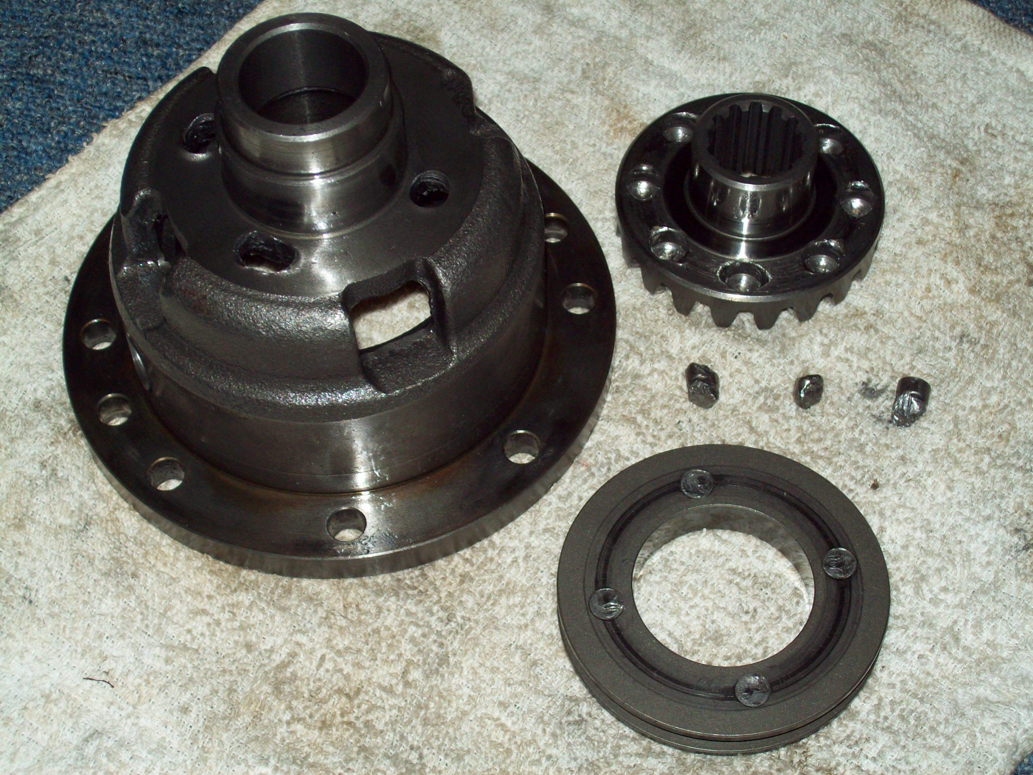

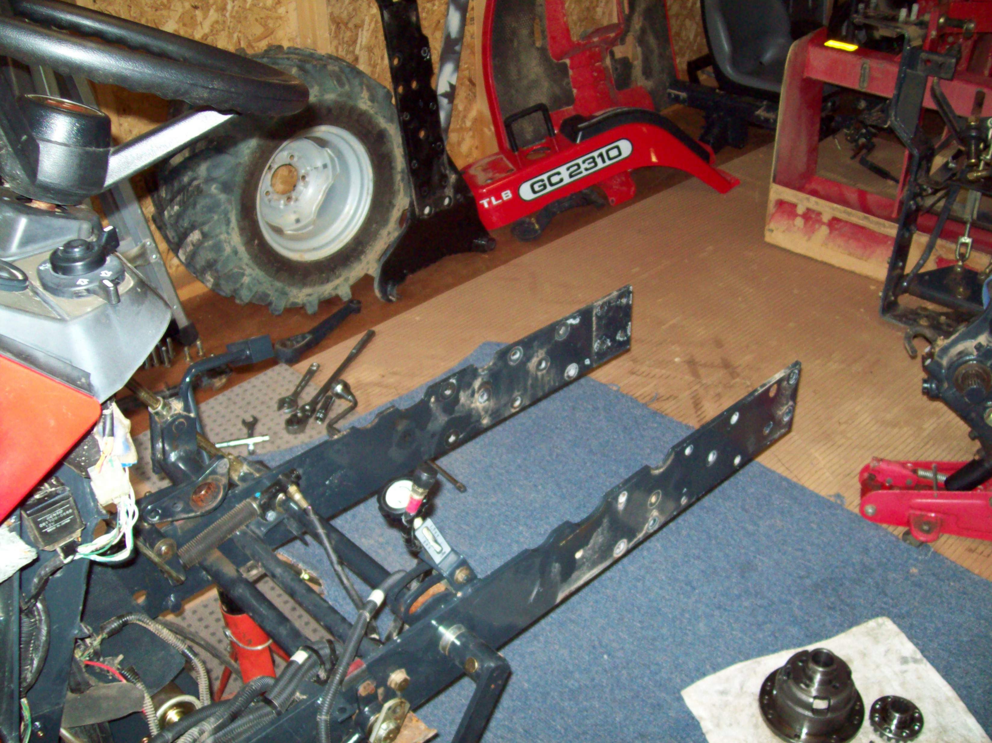

I called the factory and they blew me off to the local dealer and the mf ers at MF said its me, no one has ever called about this before, they have never had to work on one, use the diff lock only in a straight line, never make a turn, never drive any more than a few feet at a time in diff lock, don't even look at the diff pedal or you will be sorry! it took all day to take apart, 1000 parts. It must cost a lot at the dealer
   / 2310 diff-lock broke again #14
ronnierhino, you're lucky you can do that repair; I'm not sure I'd even attempt it! I'll bet you've saved a ton of $$.
My 2310 is just coming up on 500 hrs, and I bet I've not used the diff lock more than a half dozen times since I've had it --just to get myself unstuck-- but never had any trouble with it, other than having to "tickle it" to get it to drop in, using the same method others have posted. OTOH, my tractor has had very little time in the woods.
Sorry you've had trouble with it, but it does sound like maybe you're asking more than these little tractors can deliver. I always figured the diff lock was only for emergencies.
Thanks for the great pics, however! Always enjoy any time I can look inside the thing to see what makes it tick. ijk

I have a 2004 gc2310tlb and the locking rear diff has broken again, the pins on the locking ring have sheared off for the 2nd time and it takes all 3 parts to fix, $500 last time, anybody else have this problem or knows what causes this? I might weld up the 3 parts and have a locked rear all the time I'm all ways in the dirt.
