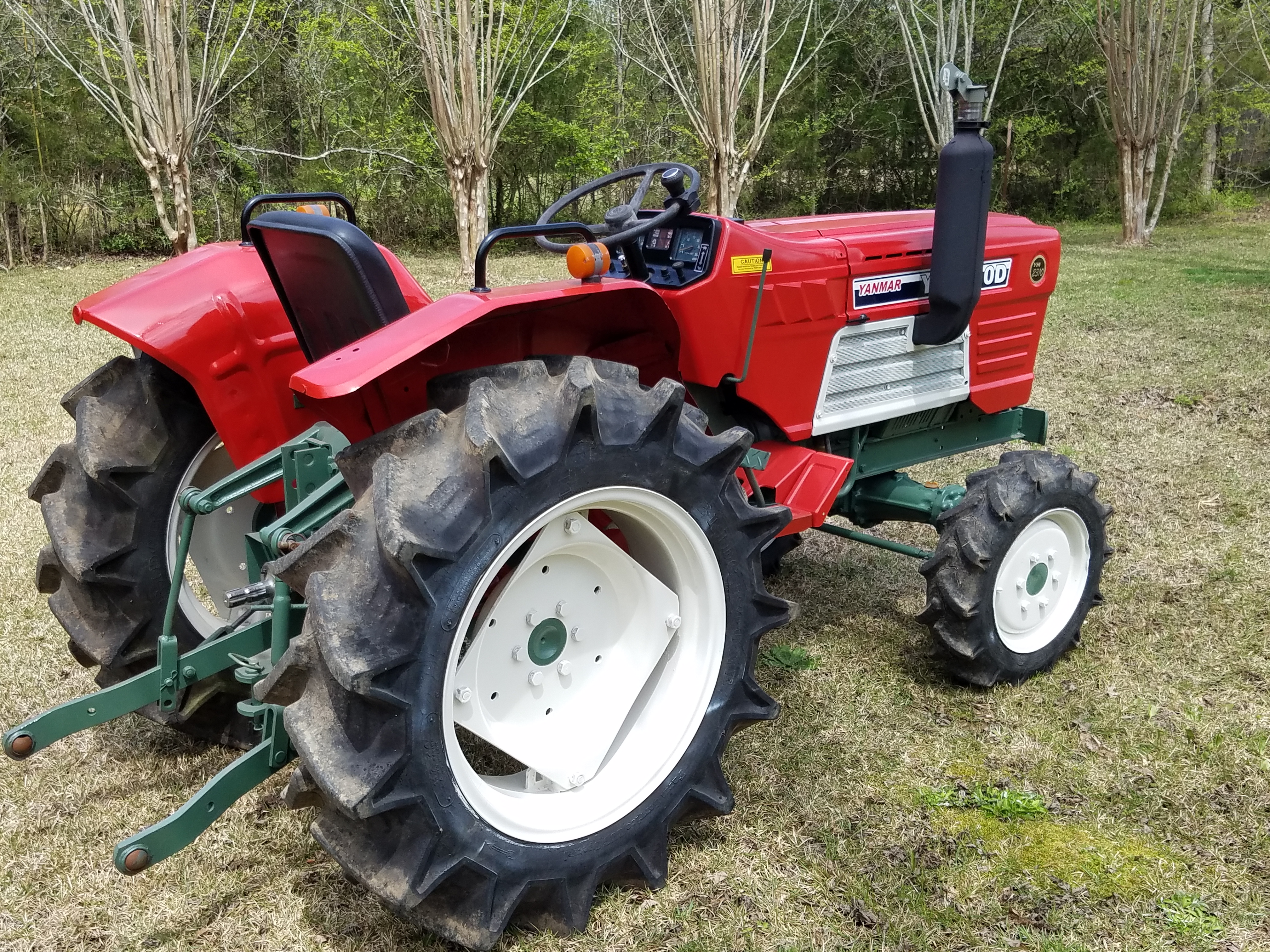

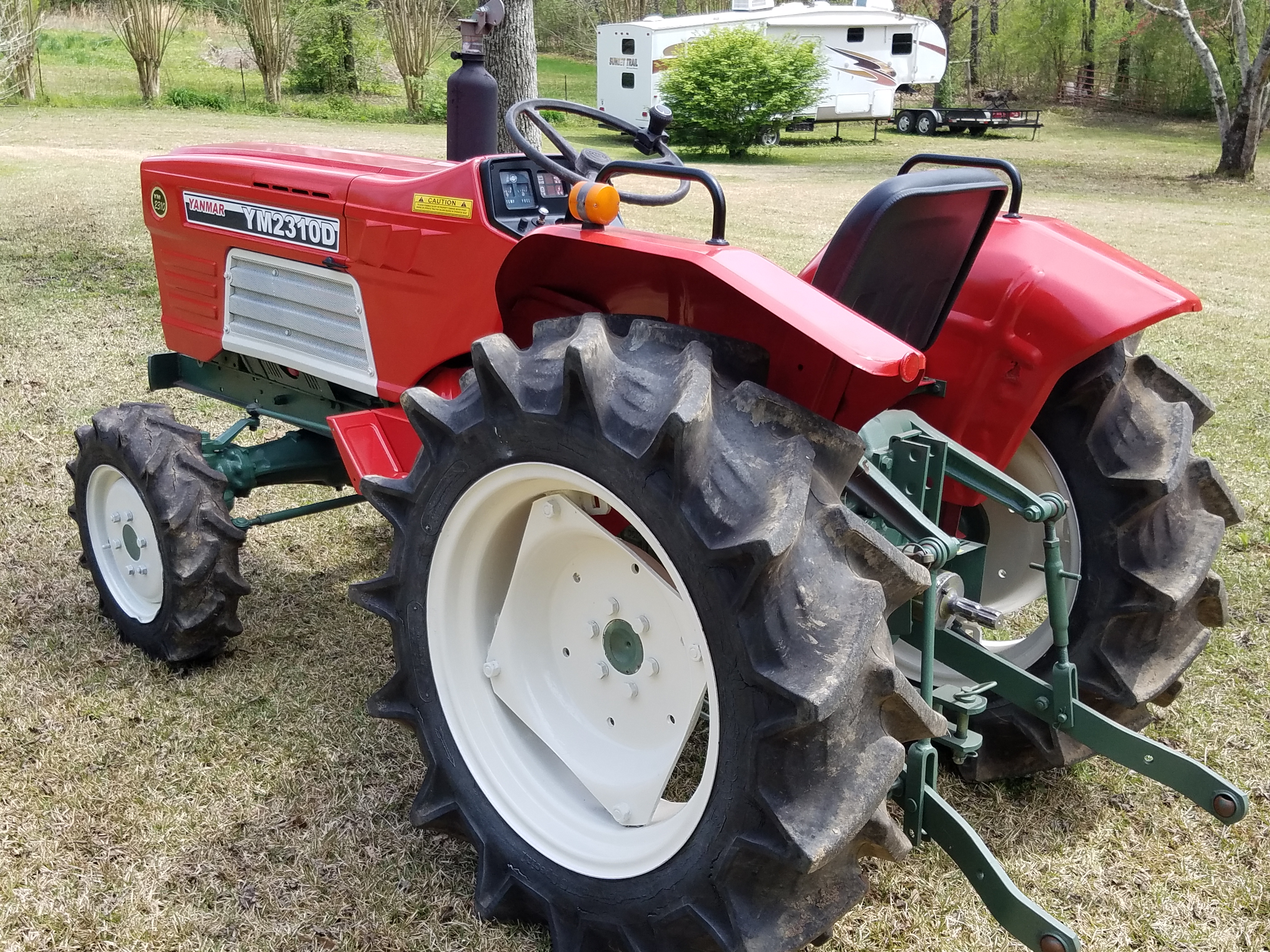

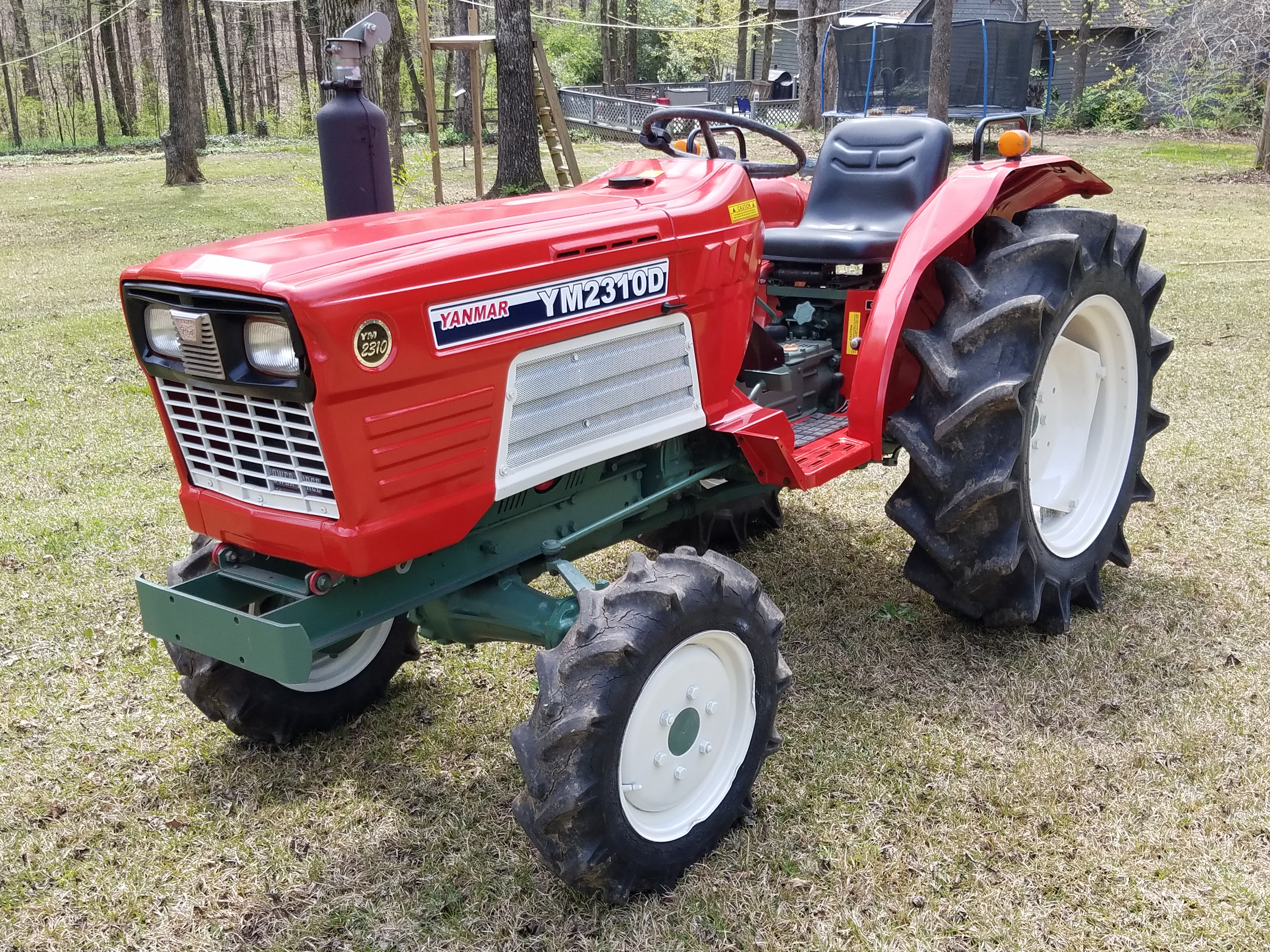

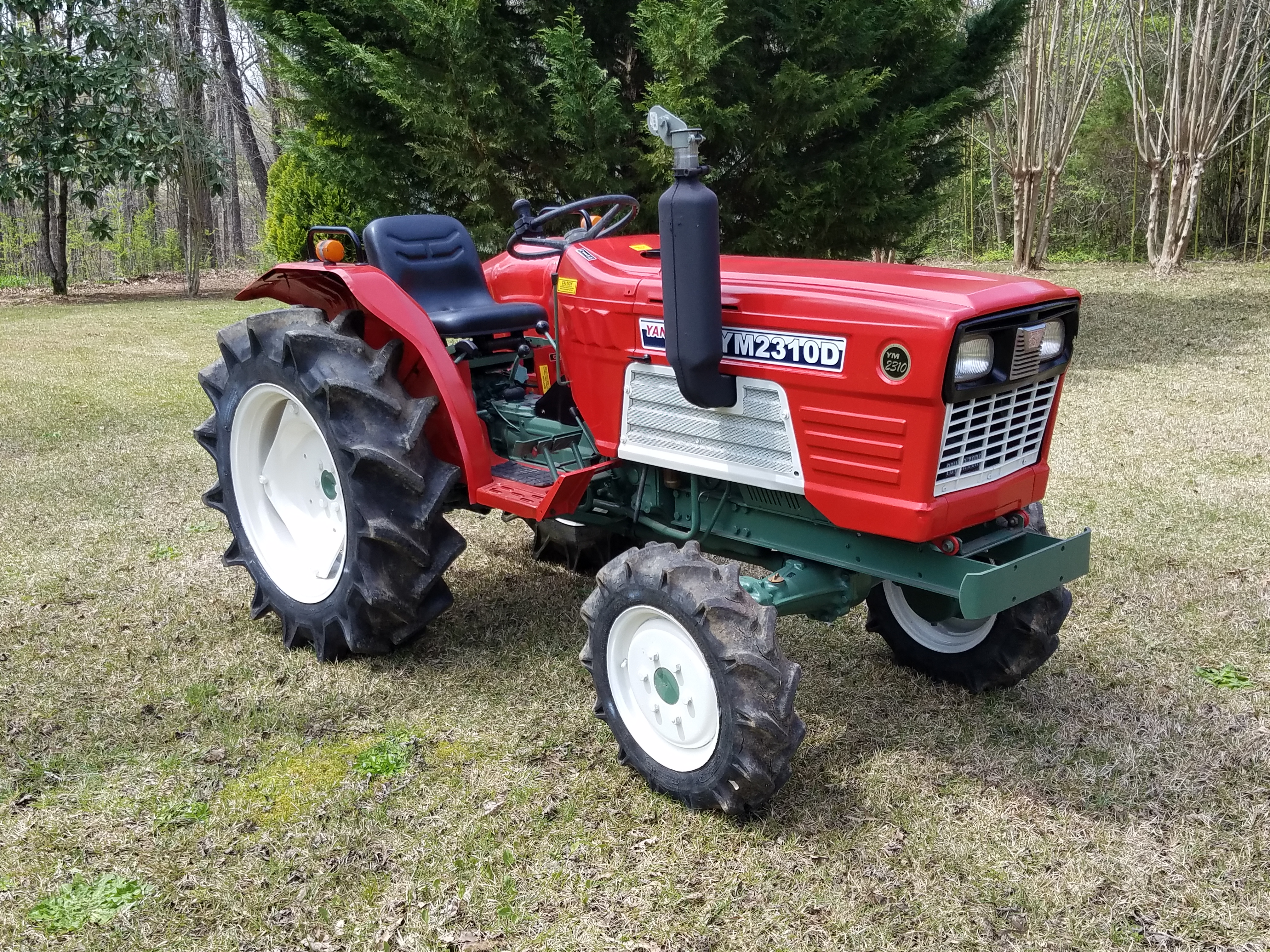

   / 2310D Project Finished Pics #12
I used all rattle can Rustoleum paint:
  • Troy-Bilt Red
  • Spruce Green
  • "Biscuit" Appliance Epoxy on the 'white" stuff.
  • Satin Black
View attachment 548417View attachment 548418
View attachment 548419View attachment 548420
Finally! A stock color that seems to be a perfect match to Yanmar's red. Well done!
Question for anybody: Is Rustoleum sufficiently tough to resit damage from spilled diesel? What about resistance to diesel additives - Power Service etc - that I know will soften plastic over time. ?
