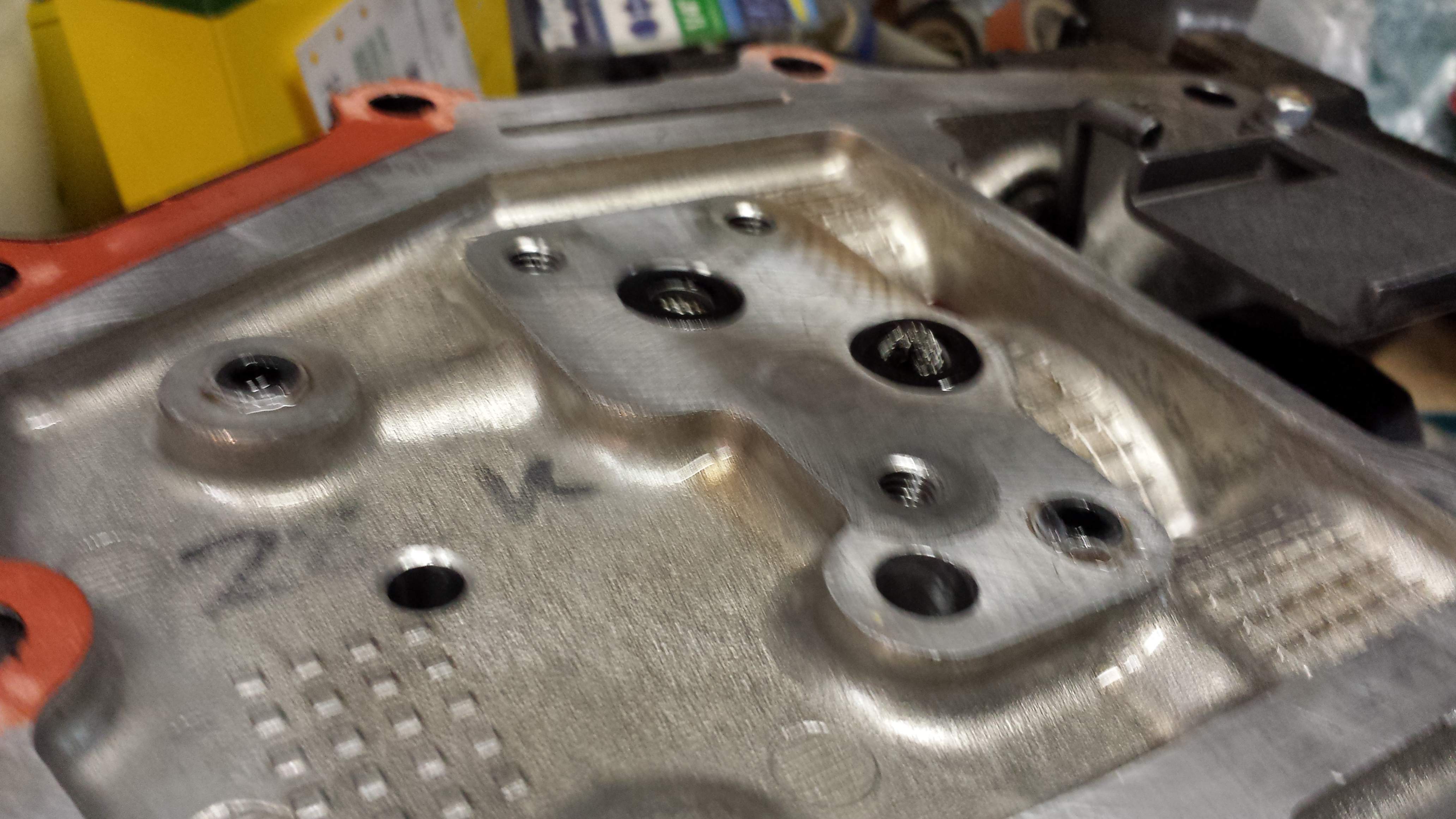

#14
Looks like I found the problem
One of the screens failed, damaged the valve. New screens, o-rings, valve all installed and working properly again.
   / 2320 3 pt hiccups
#15
I should add that I was hopeful when I found the damaged strainer that it was just the o-ring on top of it. I tested the old valve and the new valve on the workbench with the air compressor. Old valve would let air thru where the new one would not, I may attempt disassembling the old valve to see what / where it is damaged. Deere does not offer any of the internal parts for this valve that the parts guy could find.
   / 2320 3 pt hiccups #16
Pic is out of focus, but glad to hear you found the problem.
