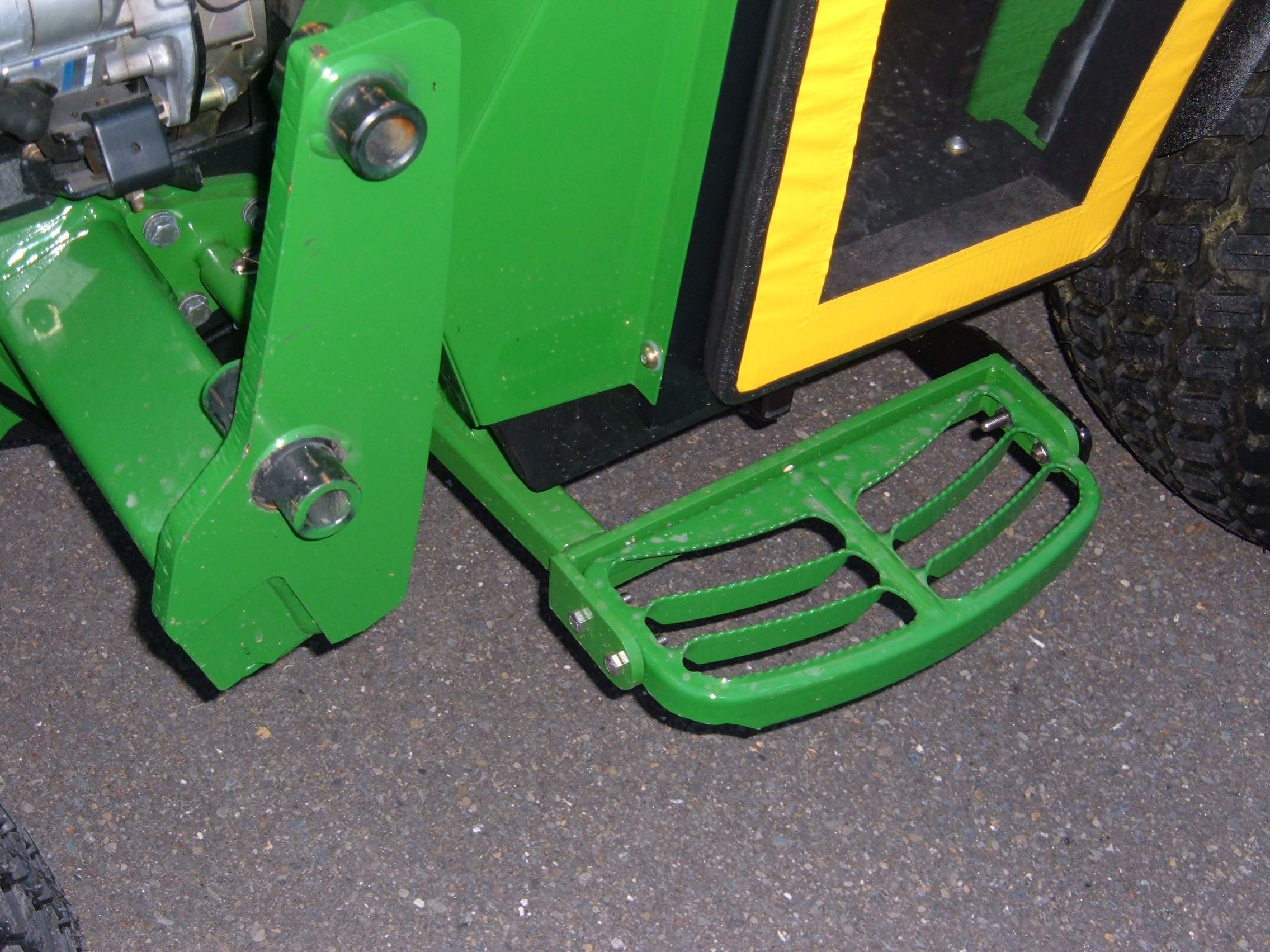

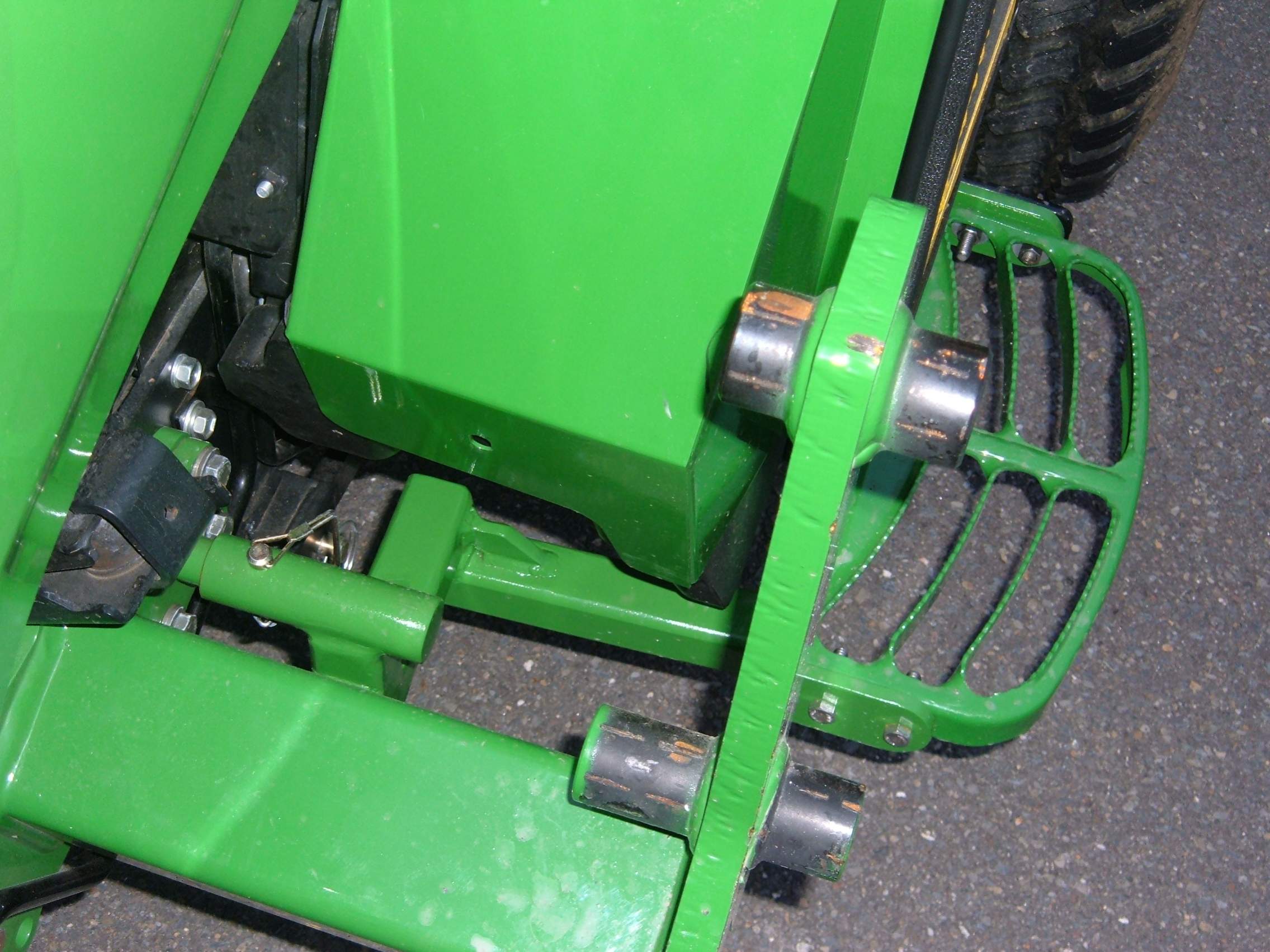

Dale, the step like yours i ordered just came in. Was the flat stock you used to bolt it to 1-1/2 by 1/4''. I've got two bolts in my floor I can use to connect a frame to it without doing any welding on the tractor.
   / 2320 Curtis Cab questions #35
Can't remember exactly what size I used but I think it was 2" by 3/8". I used the 3/8 only because I am a stocky guy and tend to always overbuild things I make. I believe I used 2" because I wanted the sides to be a little taller than the step, I also rounded off the ends of the steel so that I don't hurt myself (and it looks more professional too) I used stainless steel bolts to bolt it all together, so if I ever want to take it apart I can;)

Thanks for the info! I ended up pulling out the plexy glass on the other side and drilling the hole in it. I hope it holds up.... if not I will have top make one out of metal. Can you send me a pick of the bottom side of the step you installed I would like to add it to my machine great idea!
Thanks
Tim
   / 2320 Curtis Cab questions #37
Thanks
Tim
These are the only pictures I have of that step, I hope this helps!;)
