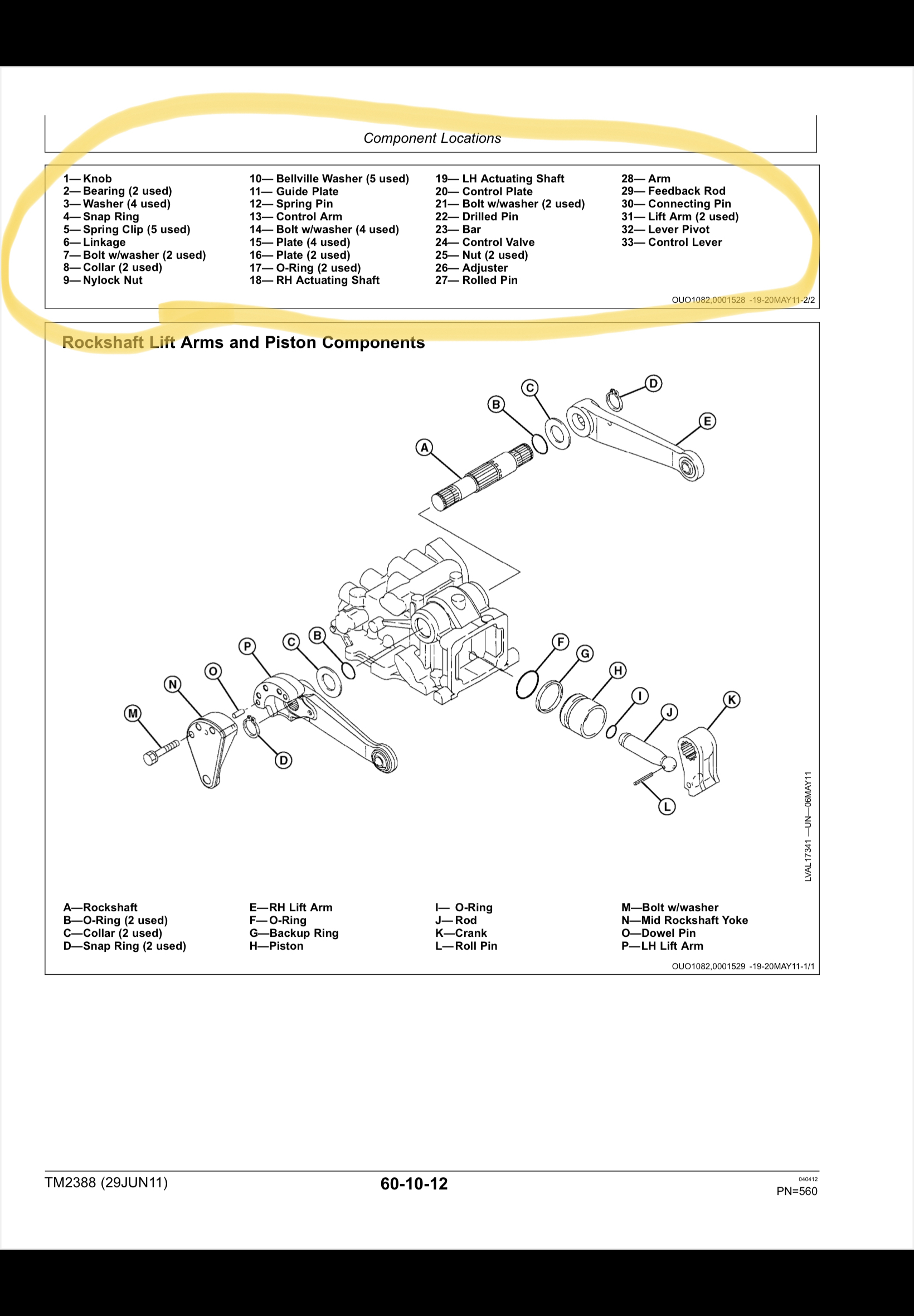

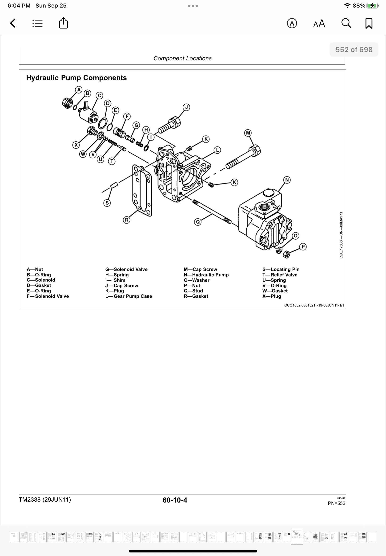

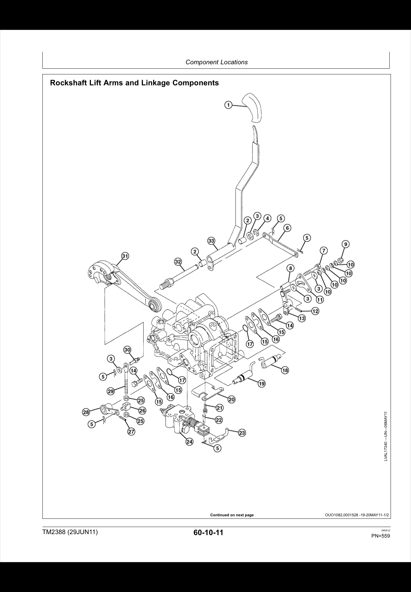

I can’t find any specific images or home for the priority flow control valve. I’ve attached blow up of the hydraulic pump with senenoid. There is control valve below the rock shaft housing (and next page top the number descriptions).

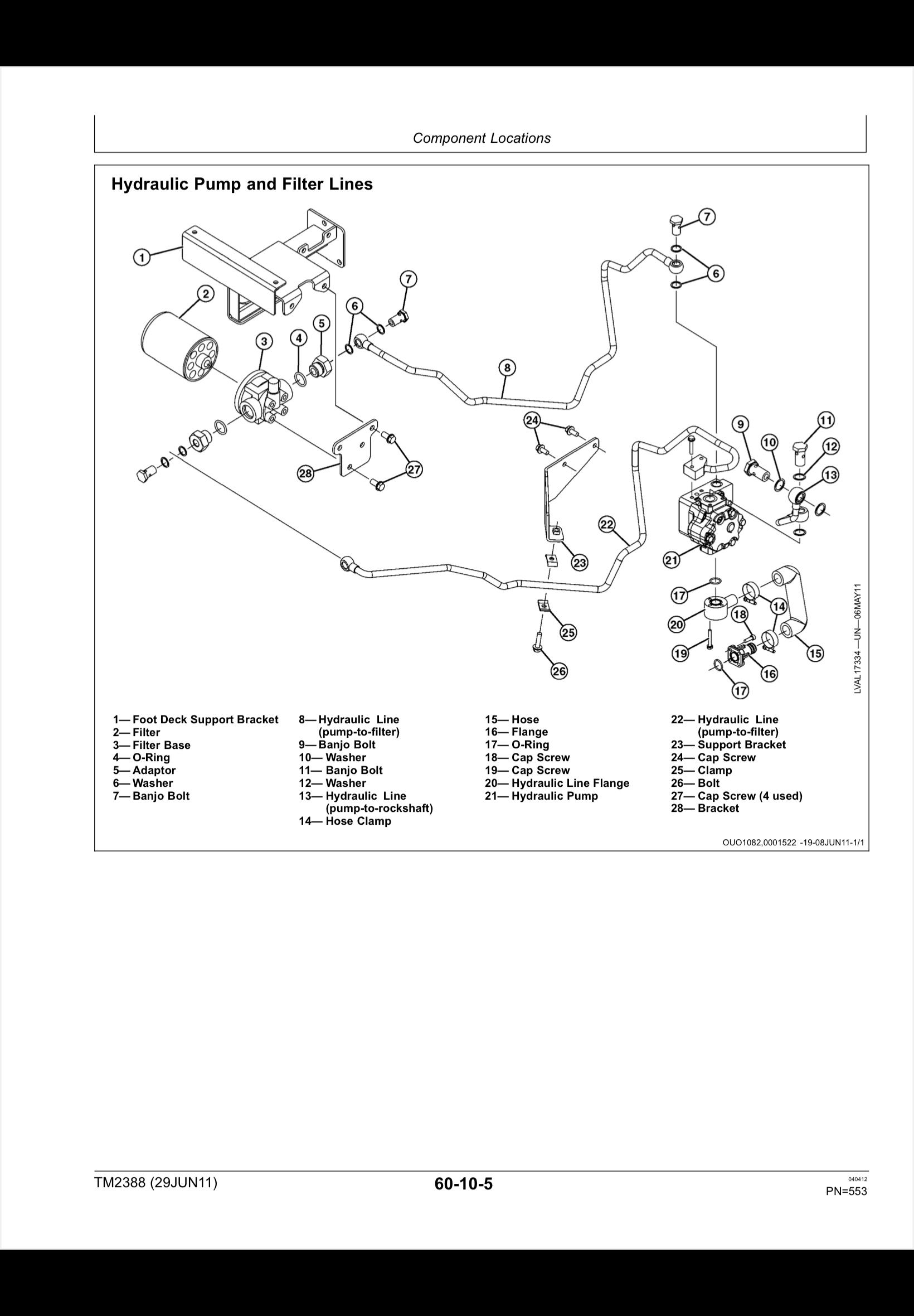

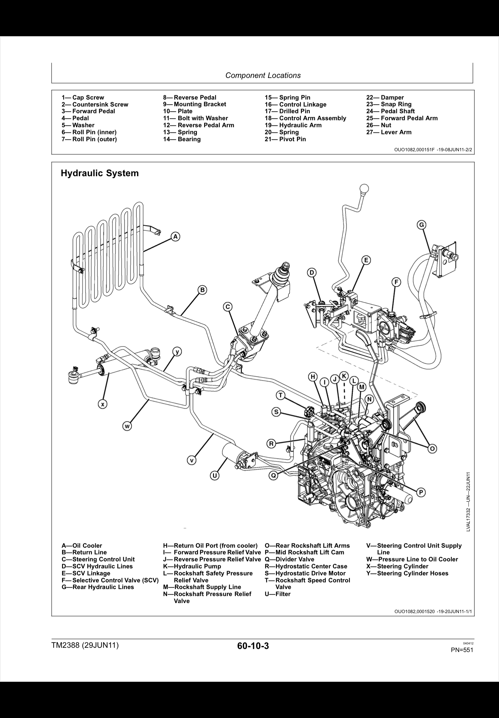

I agree that the priority flow control does appear to be in that housing. Per the schematic there is a double pump on your tractor. One section is for steering and implements the other is charge PTO and brake circuit. Is there anything in the hydraulic section showing lines, filter location etc. Per the schematic the line goes from pump to filter and then to priority valve. I suspect the filter is on the transaxle so possibly priority valve is in same area of transaxle. Sorry not much help on where this valve is.

The strainer is in the lower rear of transaxle. The filter is visible on the attached. Seems on schematic the drive shaft powers hydrostat separately and there is side gear to power charge pump ( although don’t see that “pump”) which feeds the hydraulic motor. I see where the lines circulate to filter. And see now that the hydraulic motor splits one line to rock shaft and other the pto circuit. But I can’t see where the line or passage is that is opened when senenoid opens. It’s a mystery on diagram. I guess directly below or to side given it’s location on transaxle just above pto clutch.
I also don’t see where strainer fits in as it’s quite far and isolated from these lines. I will add more schematics just in case. And you’re very helpful. This is opening up a lot of knowledge for me.

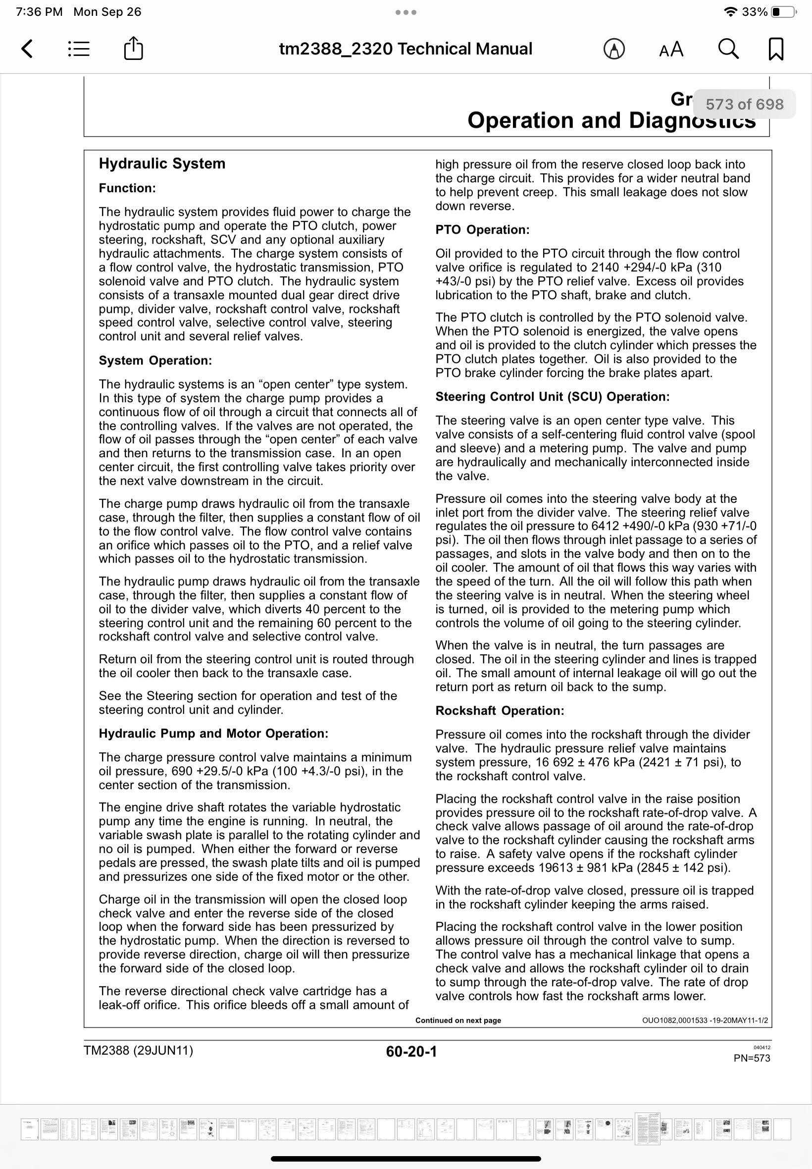

I’ve attached a helpful (to me) operation page. It seems the charge pump is in centre block and feeds oil at lowish 100psi to all. The hydrostat creates really strong pressure for drive (only) in either direction. The hydraulic pump gets oil from charge pump but does actually seem to only feed steering and implements/draft arms. So you seem to already have that figured out. And the pto circuit gets oil from the charge pump through the flow control valve. So yes ….it is separate it seems. I need to find the flow control valve and orifice. It’s a mystery. And in that area there must be a test port.
How does the oil actually compress pto clutch ? In the disassembly pics of centre case gears, bearings, shafts and clutch plates….it’s all open to case. I don’t understand how or what drives the plates together. Is the oil actuating a mechanical arm? In any case I should check charge pressure as first step. And inspect and clean screen.
