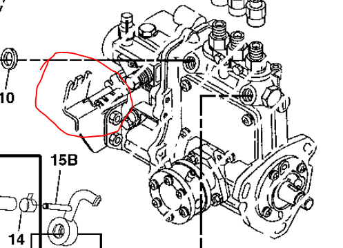

Hello. Just discovered a throttle problem with my 2011 2320. I have slack in my throttle cable under the dash. I checked the cable on the fuel pump and no slack there so it's coming from the lever. Anyone know how this thing's attached? Wanna get some idea before I start tearing into it. It's getting more loose so I need to fix it before my throttle loses highest or lowest speed.

One or the other of the ends of the sheath around the internal cable must have come loose.
/ 2320 Throttle slack #3
Look at inj pump to determine if throttle cable housing to connected to support outline in red. Other end of cable will more than likely be a lot more difficult to view.
I checked the cable on the pump and it looks good there. I think it's under the dash. I pulled up a thread here from 2008 and it showed 2 jam nuts under the throttle lever that came loose. I'll do some more checking before I commit to taking the dash apart again. I usually take it apart every spring to get to the drive shaft grease zerk.
