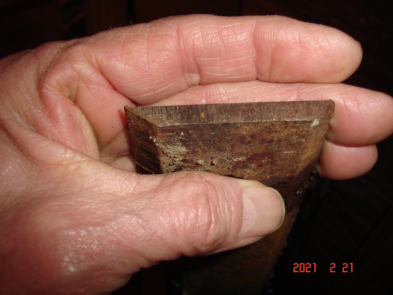

Absolutely!
You might want to get some additional bolts & nuts, as when the edge is worn back --and if you keep the feet retracted so it's scraping on pavement as I do-- you may find that the nuts have been ground down, too.
It's also a very good idea to use an angle grinder to smooth up the old edge. Take my word for it, it can have some VERY sharp areas on it! I find it works best to flip it end-for-end; that way you can have a sloped surface against the backing plate -- makes it easier easier to clean snow out after blowing.
Here's an edge that's all done -- (PS - the old edge can be cut up for those welding projects that need smallish pieces --)

Thanks! Switched it around, and ground the fold over off. You can see how worn it was.
I did get lucky on the bolts, all but one were fine and that one had enough meat left.

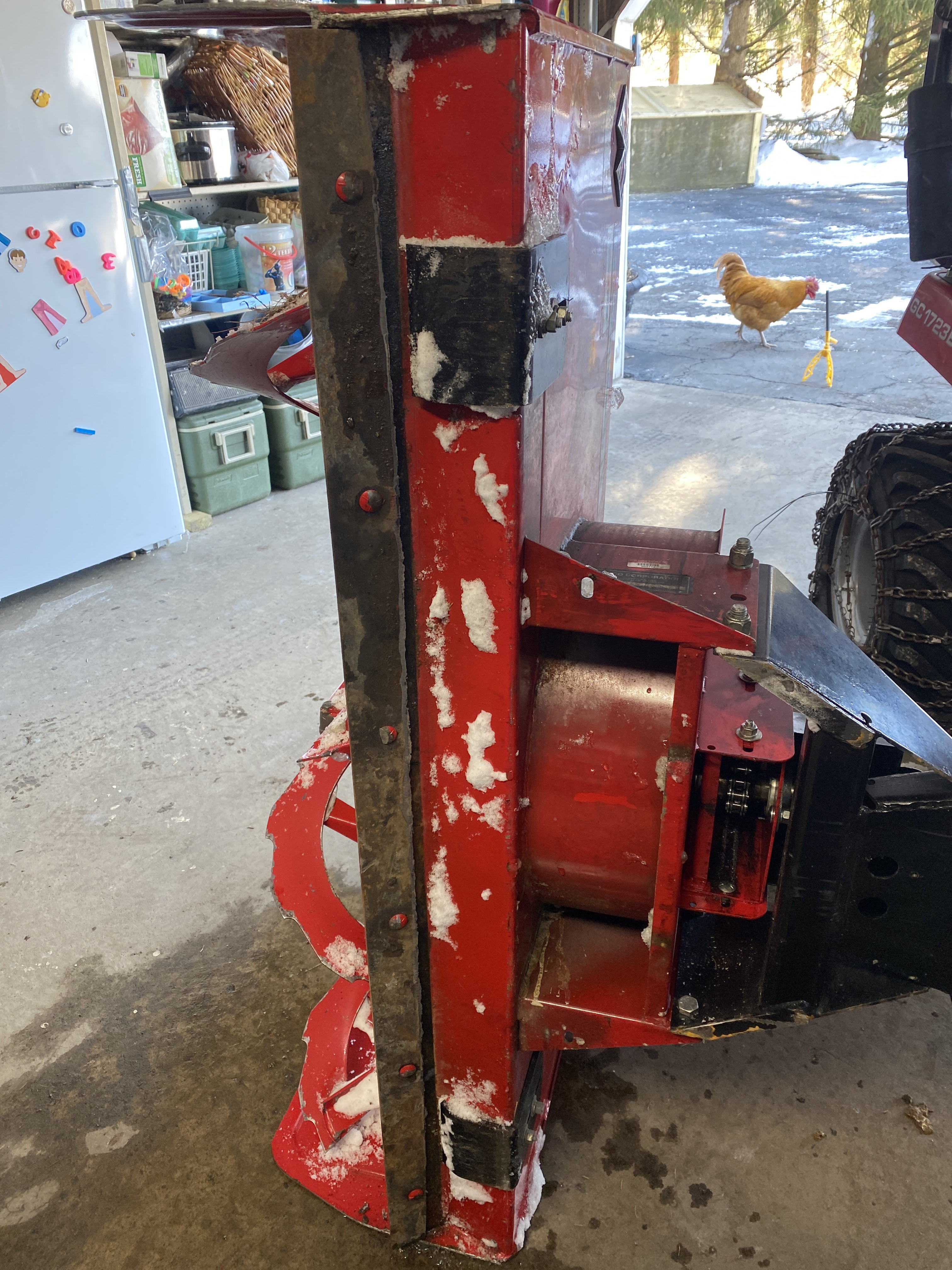

I’ll add, my 2360 was bought used off of a 2006 GC23xx machine so believe it’s at least 15 years old and the original cutting edge.
   / 2360 cutting edge reversible? #7

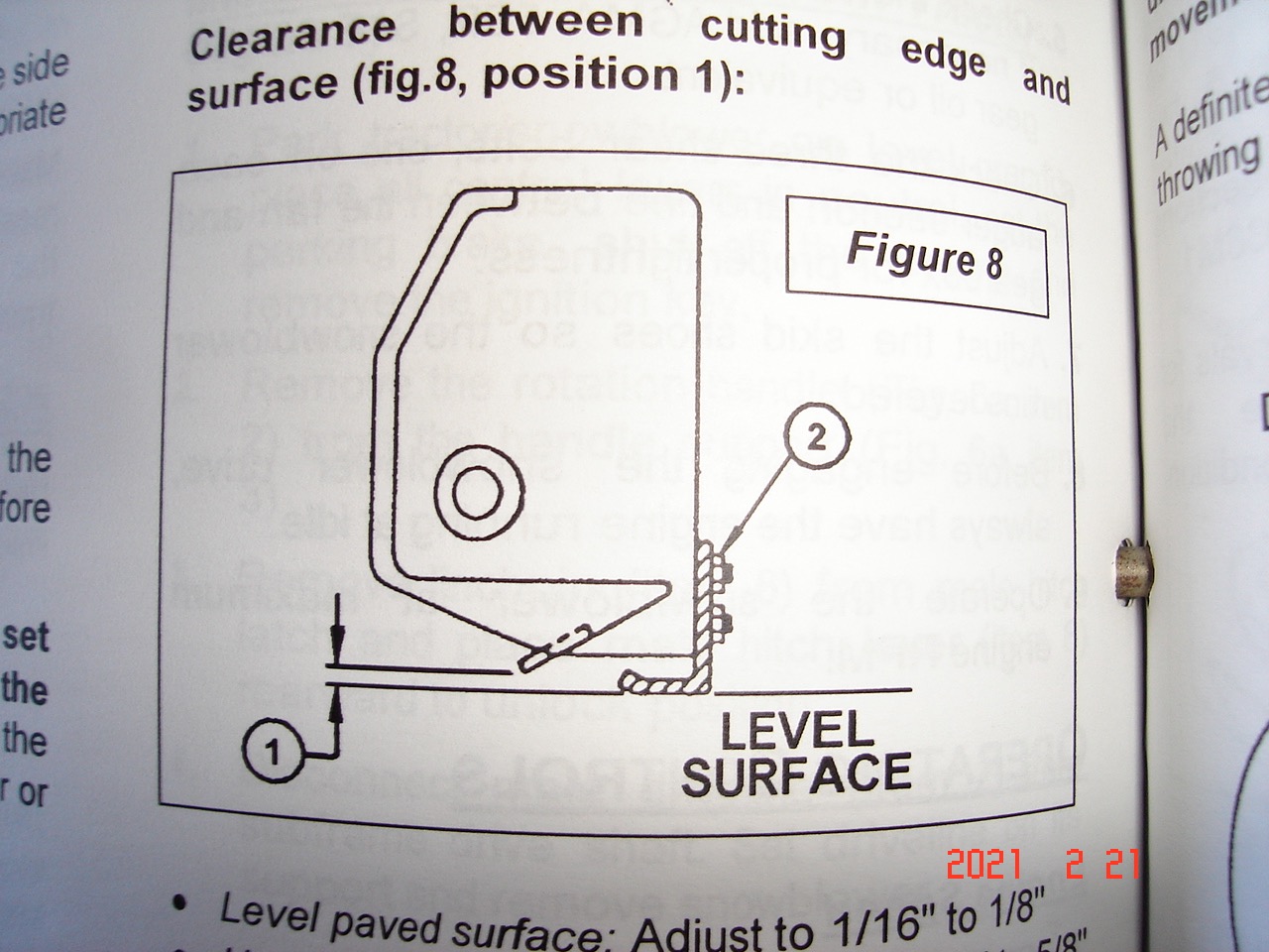

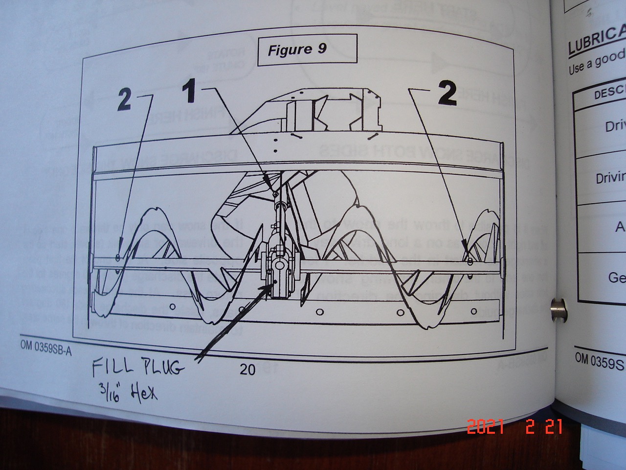

Well, that's interesting! On mine (and others I've seen), the cutting edge is on the INSIDE of the blower, not on the underside as yours is. The rounded tops of the carriage bolts are also on the inside.... Unless I'm not looking at yours correctly? That works OK?

Yup, works fine. I would believe that it came like that due to the paint. The side that was down is painted and you can see where it was mounted. That’s at least how it was when I acquired it.

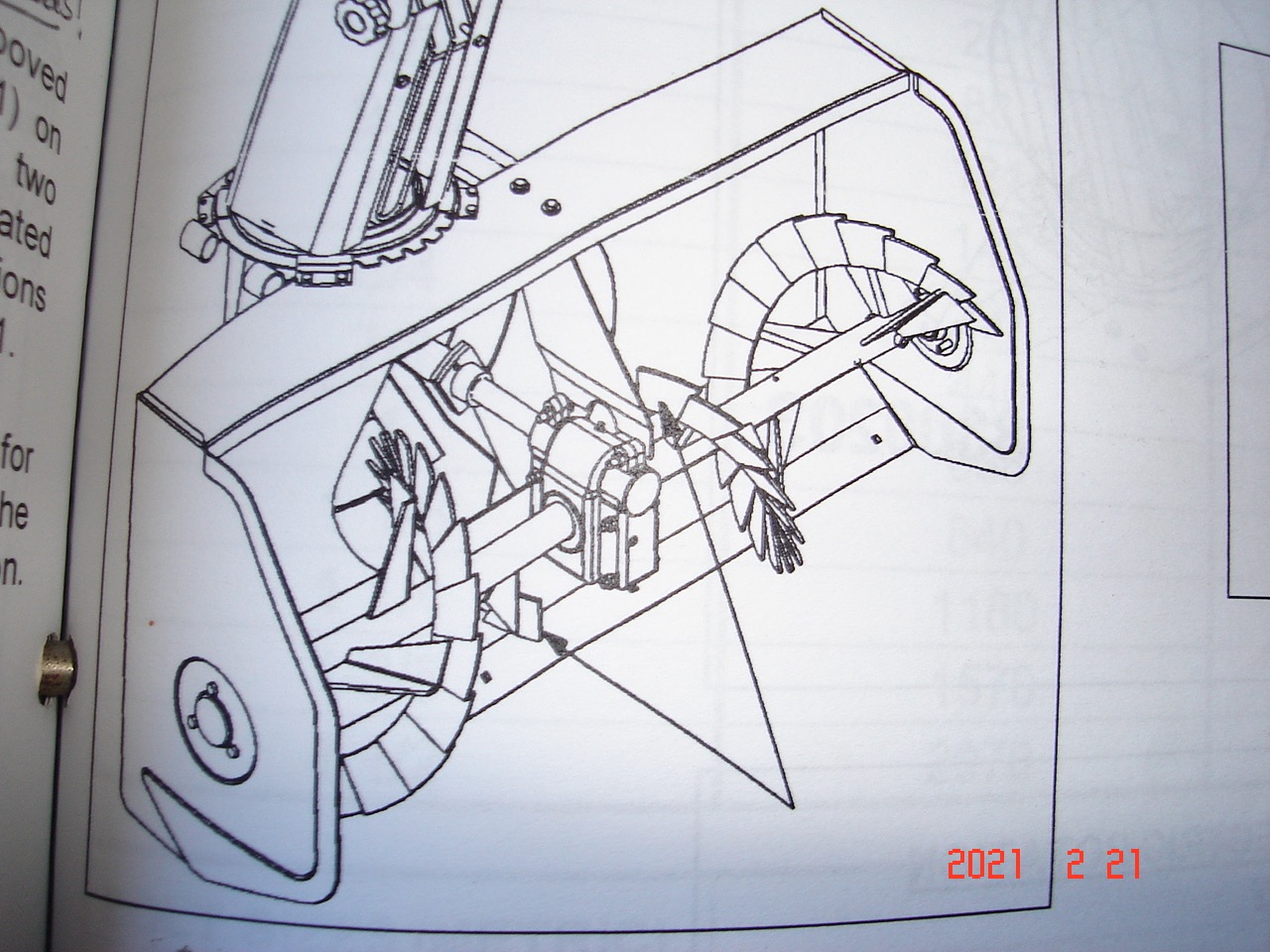

Well I'll be darned. Never thought of mounting it that way.
Just went and looked in my parts book and operator's manual and finally found a drawing that definitely shows it on the inside. I got mine new from the factory when I ordered my 2310 -- the blower was my MAIN reason for getting the tractor-- and it came on the inside, so I've always put it back the same way. I can see where mounting it beneath might give it more wear area (and maybe last longer?).... Interesting.

That definitely shows it on the inside. Maybe mine was a Friday afternoon blower, lol
I would think on the bottom would provide a bit more protection to the housing?
   / 2360 cutting edge reversible? #11
Not sure -- I've been thinking about the stresses that might create, as opposed to mounting it on the inside. Not sure if it makes a huge difference, but it certainly would seem that you could get more "miles" out of the scraper that way.

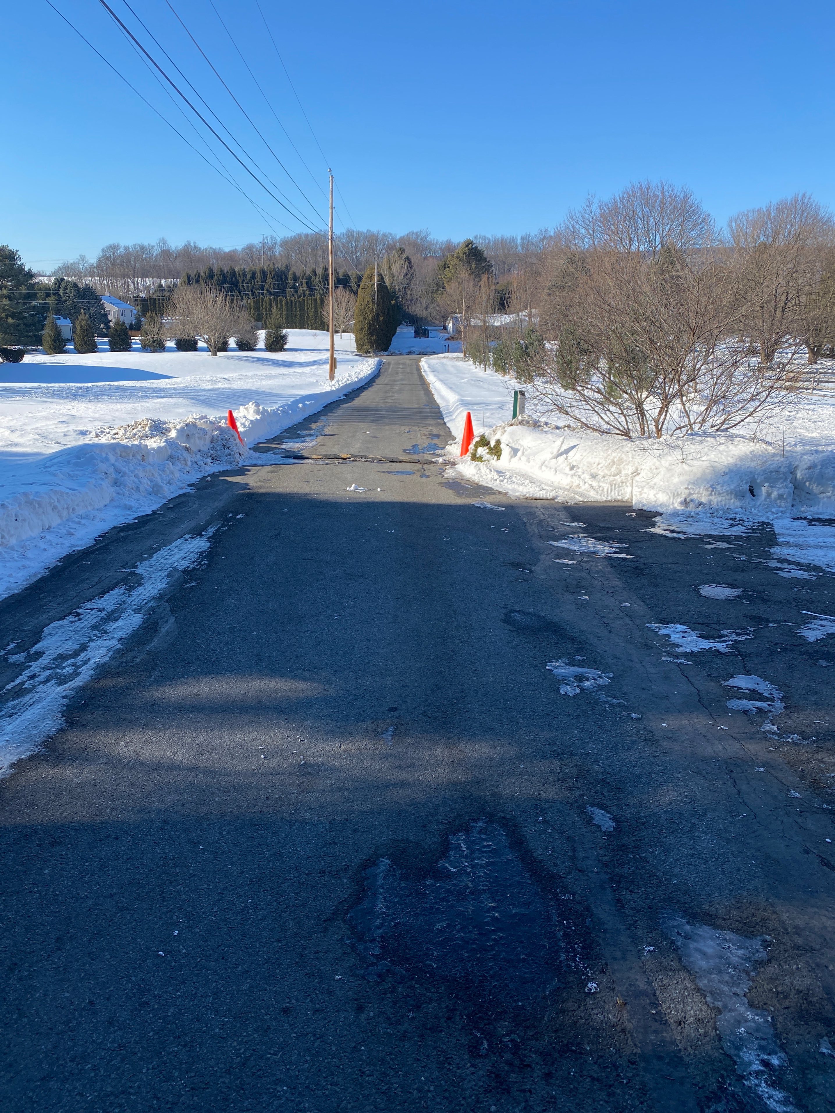

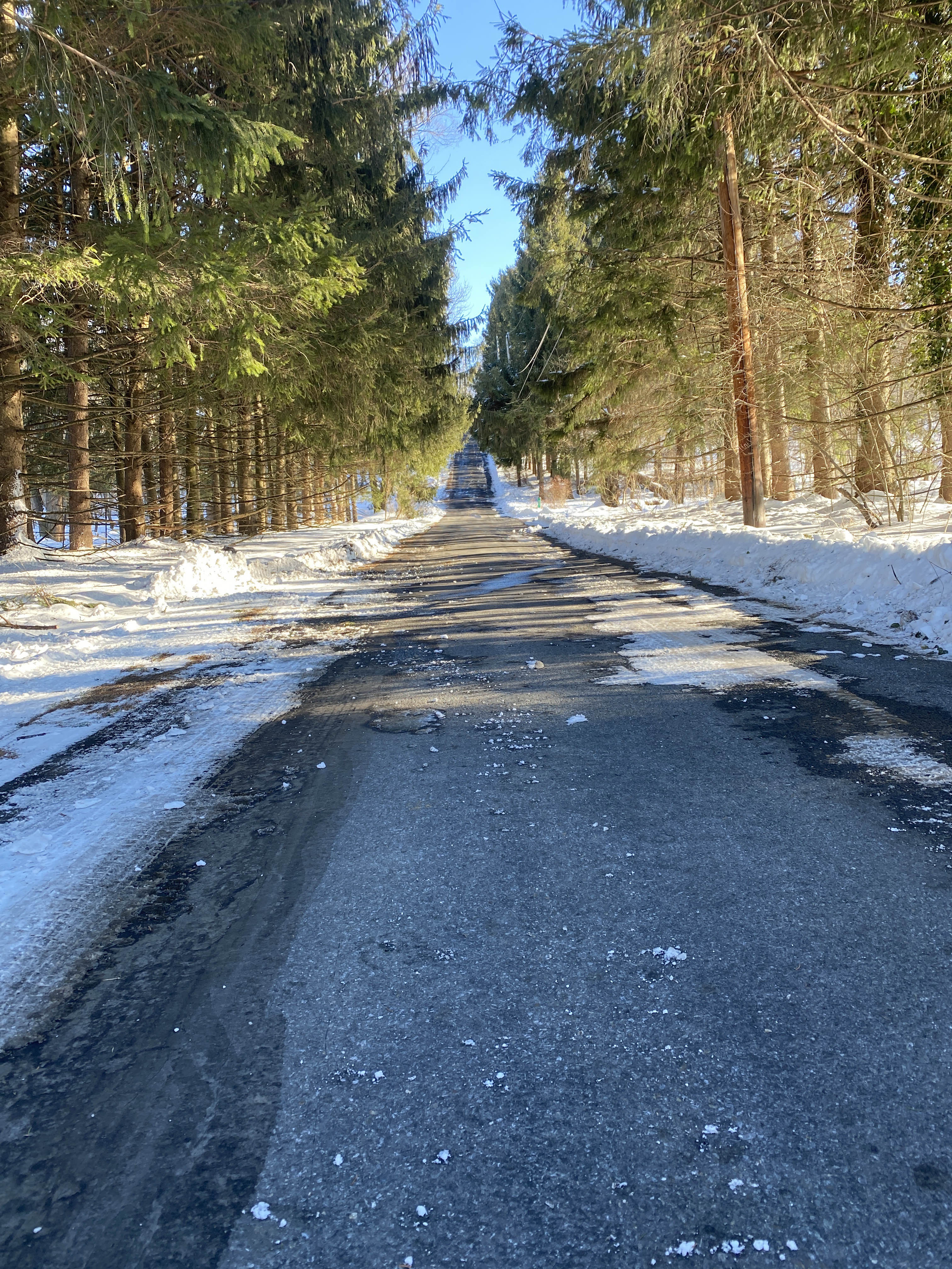

We are almost identical in circumstance, I do about a mile and a half of private road. It’s called Up Hill Rd for a reason. Also north facing, lol.
From my driveway down
From my driveway up
It’s near 45 degrees for the top half.

Notice that in Fig. 8 there is a skid of some kind that should (on the level at least) keep the cutting edge from ground or pavement contact. I realize that is going to vary and there will be ground contact at times. Several of these guys must use the heck out of their snowblowers (where my use is very little and far between compared to them.) I will comment that I have found I pick up a lot less gravel by fine tuning the angle of the blower so the edge is NOT digging down into the pavement or gravel. I use an Agro-Trend 5ft blower on a Kubota B2150. Great combo esp with the creeper gear on the Kubota and a nice FEL on the other end. Nearly all the blowers I found are Canadian made. I am attracted to the idea of a replaceable skid rather replacing the knife edge if mine ever got worn that much.

So development, we had about 4” or so today and I got to try it out with the cutting edge “new”. Twice it got caught and bended 1 end down. After hammering it back into shape, I mounted it on the inside as the manual shows.
It was on the most wore end, I surmise that with all of the material gone it wasn’t strong enough to fight that force.
