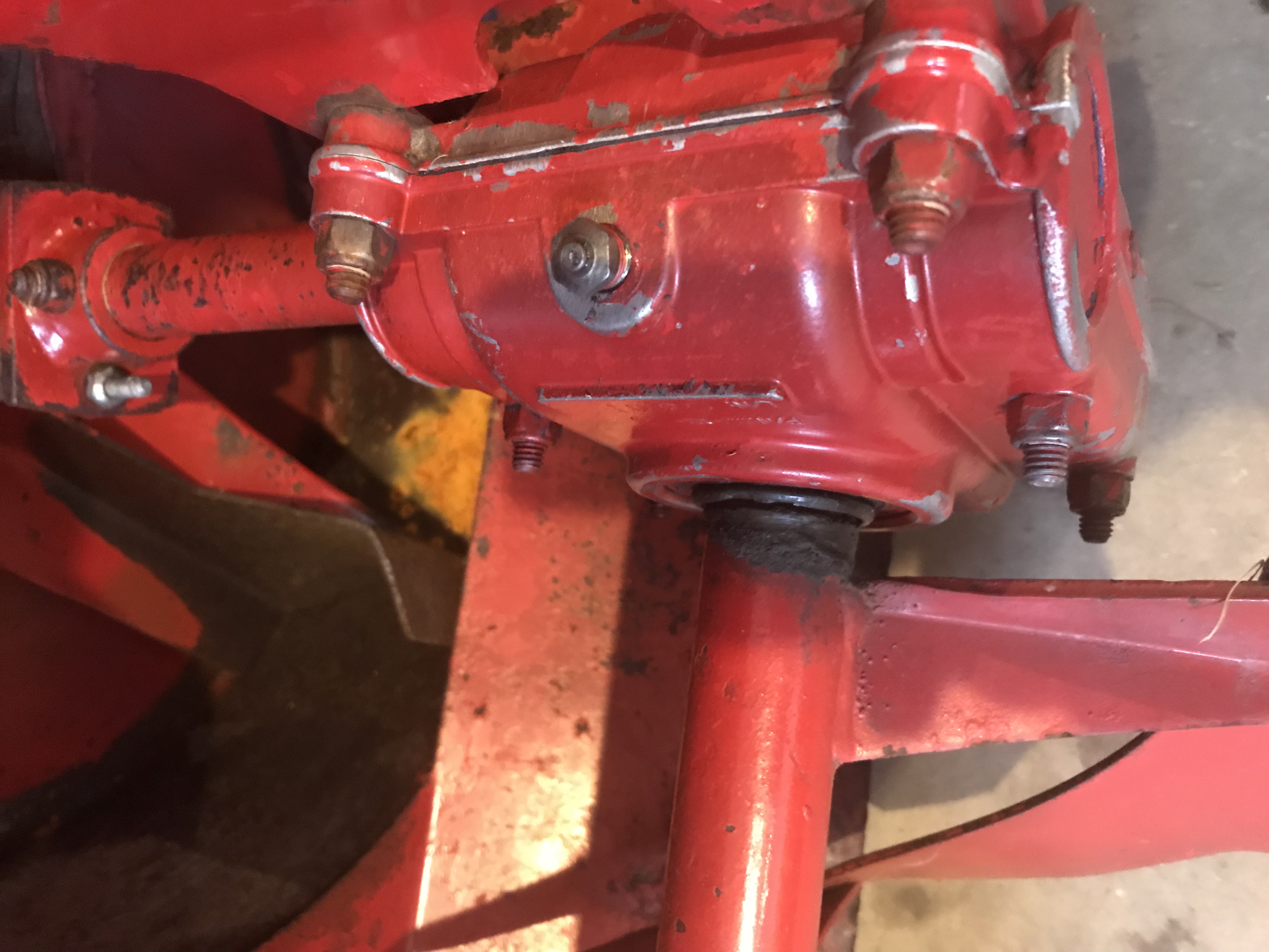

Any good gear lube will work.
I have some left from filling my tiller, will probably just use that. I'm sure any clean gear oil will be better than what is probably 12 year old oil...
   / 2360 Snowblower gearbox lubrication #12
Many of the attachments are made in Canada (definitely the snowblower, RAD Technologies EN - RAD Technologies Inc. – RAD Technologies Inc.), but I believe the basic tractor, although assembled in... maybe Alabama?... is Japanese design. I've encountered both metric and "English" measurement bolts & such. Nice to be so confusing.
#13
Well I'm very glad I decided to change the gearbox oil. When I finally got the drain plug out (had to use a ratchet with allen adapter) I got probably 1/4 to 1/3 cup of water, followed by absolute sludge. Ran about 6 oz of new oil through before filling it up. Probably should have run it for a few minutes before draining the "flush oil" but it wasn't running at the time and wanted to get through stuff. If I think of it I'll change it again in the spring.
   / 2360 Snowblower gearbox lubrication #14
Changed mine today - when I pulled the level indicator plug the oil was black so i decided to change it. Funny thing - when I pulled the drain plug the oil coming out the bottom first was clean.
#15
Yeah, interesting how it stratifies. When I pulled my level plug what came out was moderately clean. Then I had the water on the bottom and sludge in the middle. But I haven't actually "run" the blower since April 1. I did manually rotate it to see if that would help push stuff out (made a little difference but probably not substantial).
