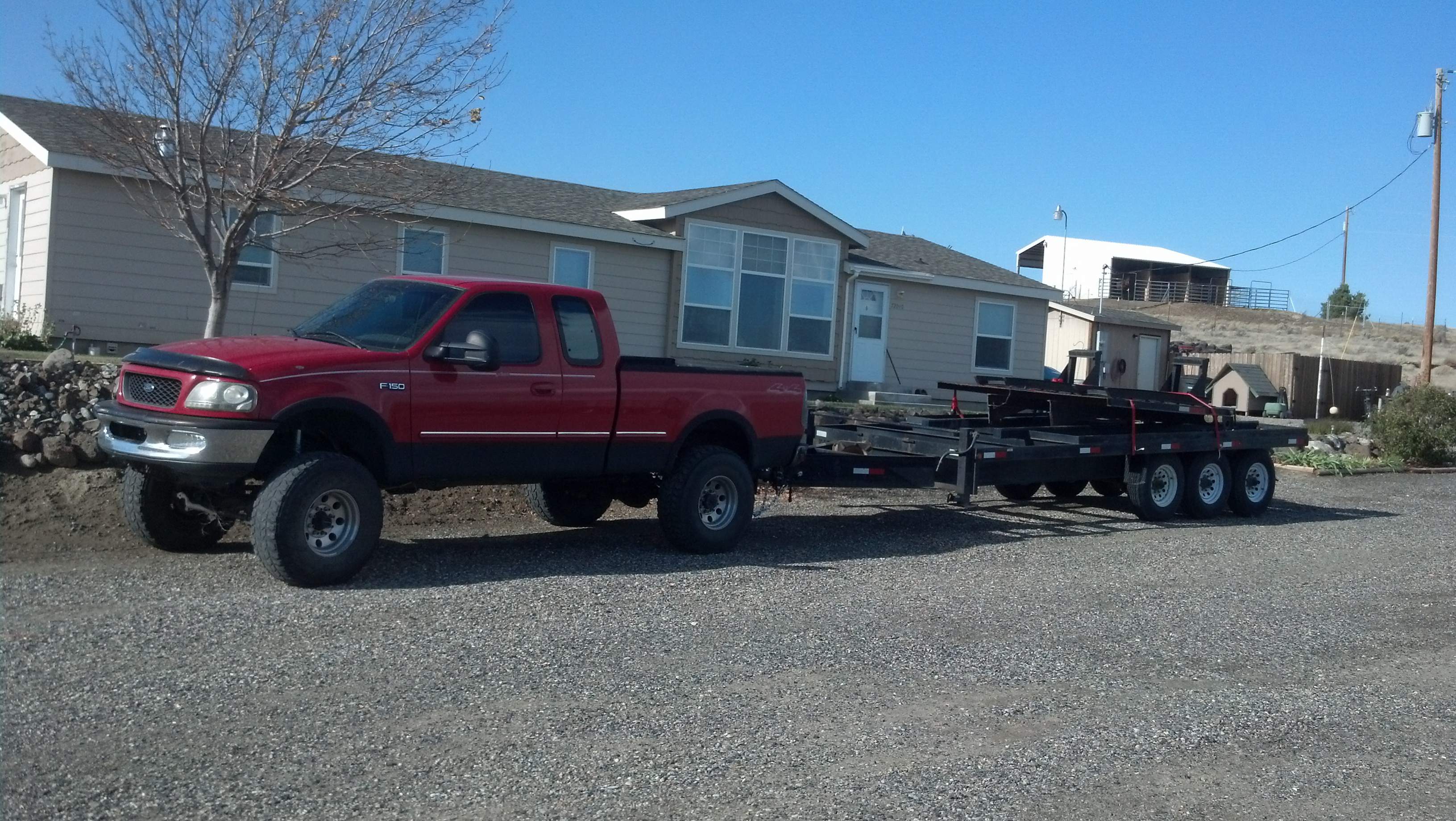

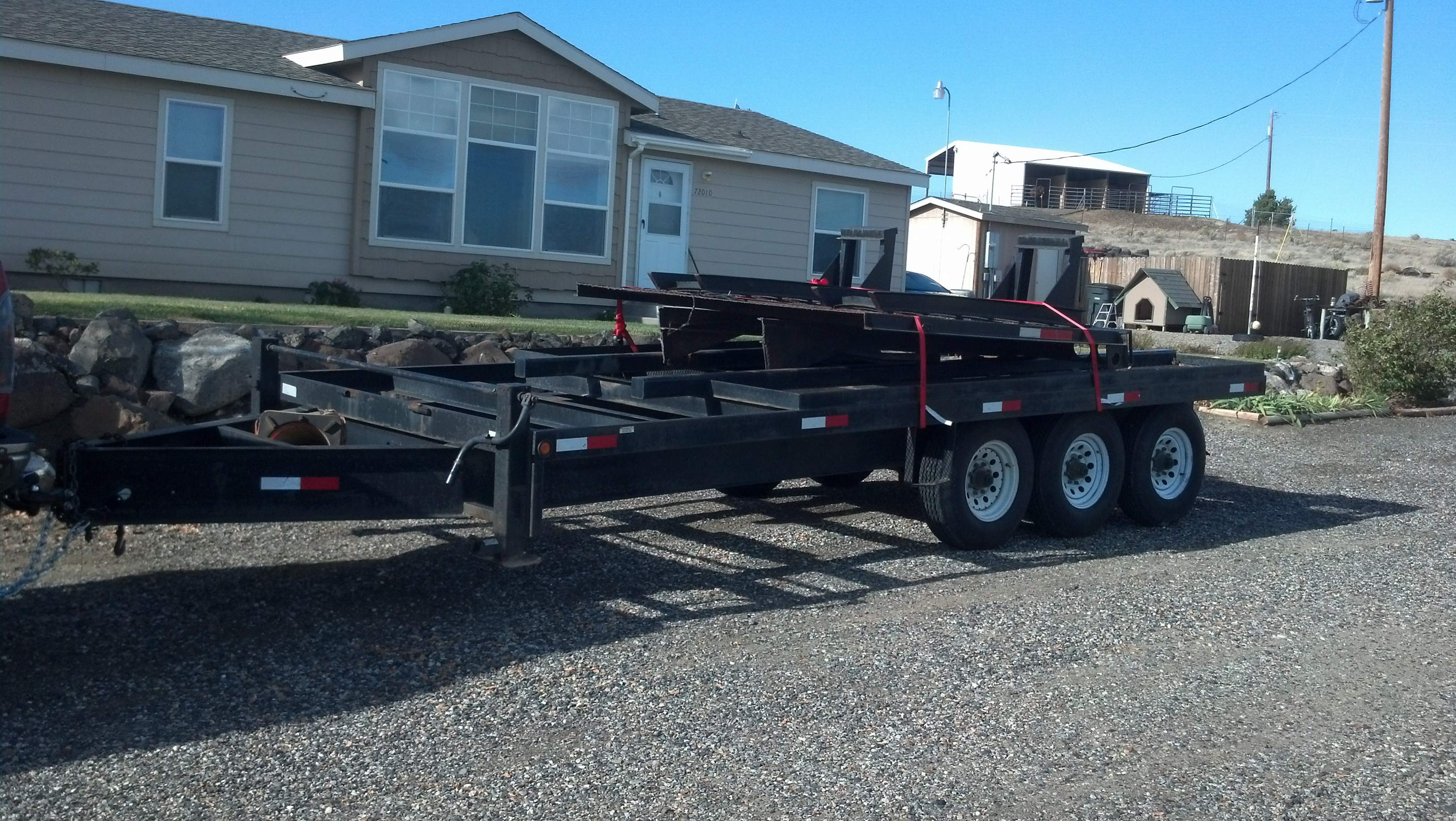

Found a deal I cant turn down, $2500 for a triple axle 7k lbs each axle, for $2500, needs beavertail and decking. appx 20' deck frame already on it.

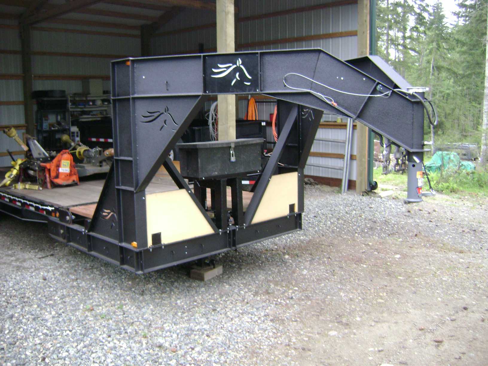

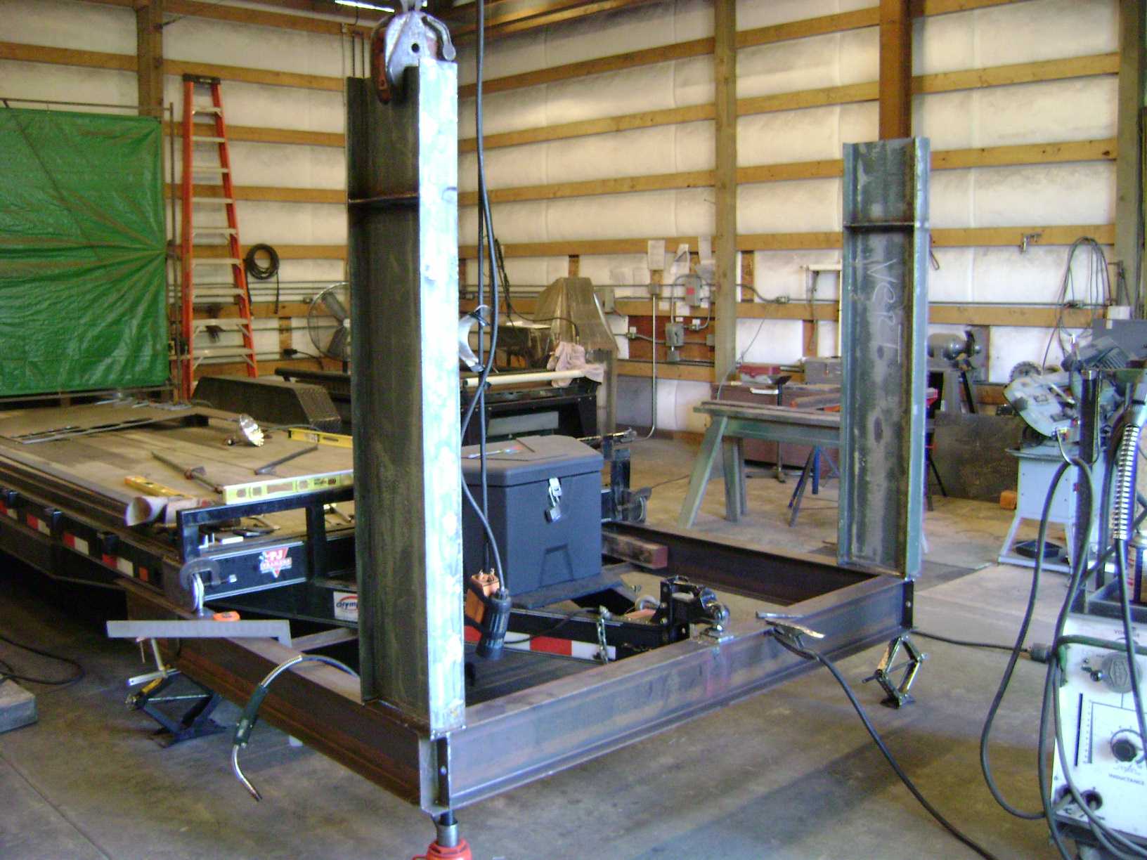

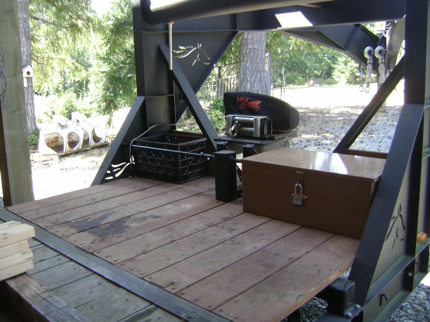

That is a great deal:thumbsup:! While you're in the building mode, go ahead and build a gooseneck adapter.;)
   / 24' Deck over plans, or start drawing my own?
Trailer I hauled home
   / 24' Deck over plans, or start drawing my own? #8
Boy that was a deal!:cool: What's on top of it?
#9
trailer deck is 18' and that's a 7 ft beaver tail sitting on top. it needs decked and the tail attached
   / 24' Deck over plans, or start drawing my own? #10
Oh OK! I could see the ramps on top, but couldn't tell what was under the ramps. So now you have a little welding job to do.
Years ago I use to work with a guy who lived in Benton City. Most likely dead by now. Good ol boy. Quite the silver smith!:cool:
