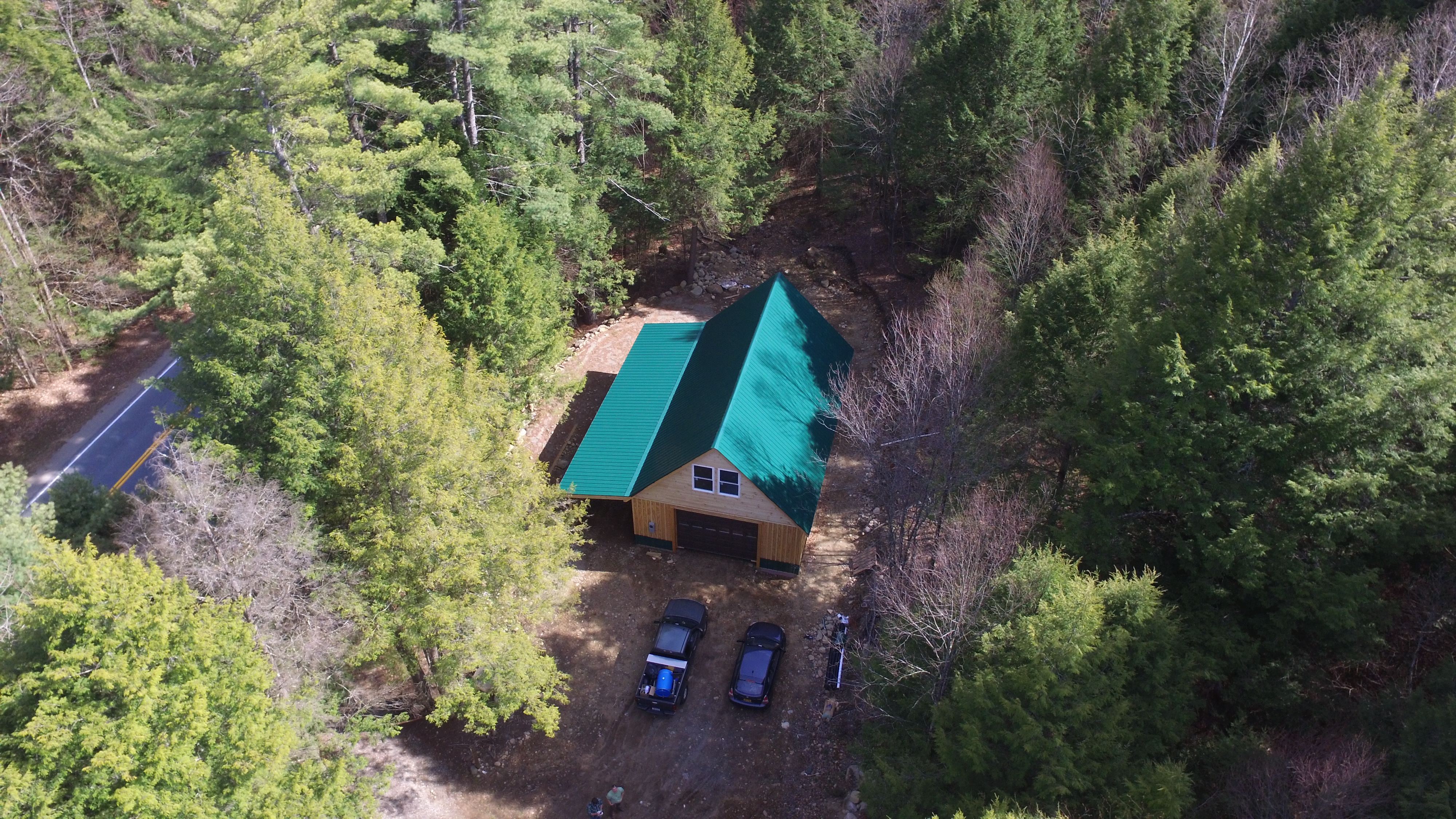

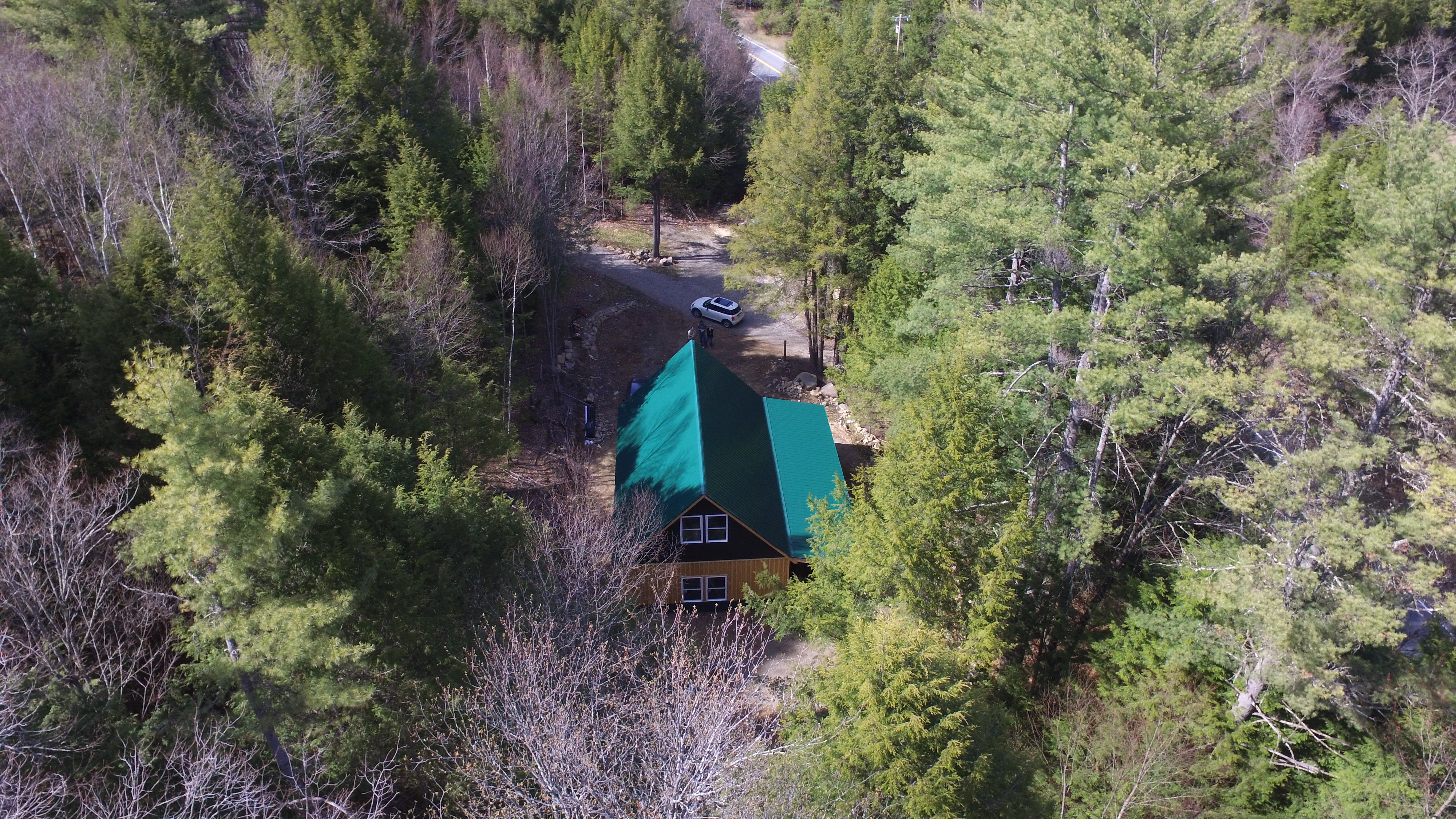

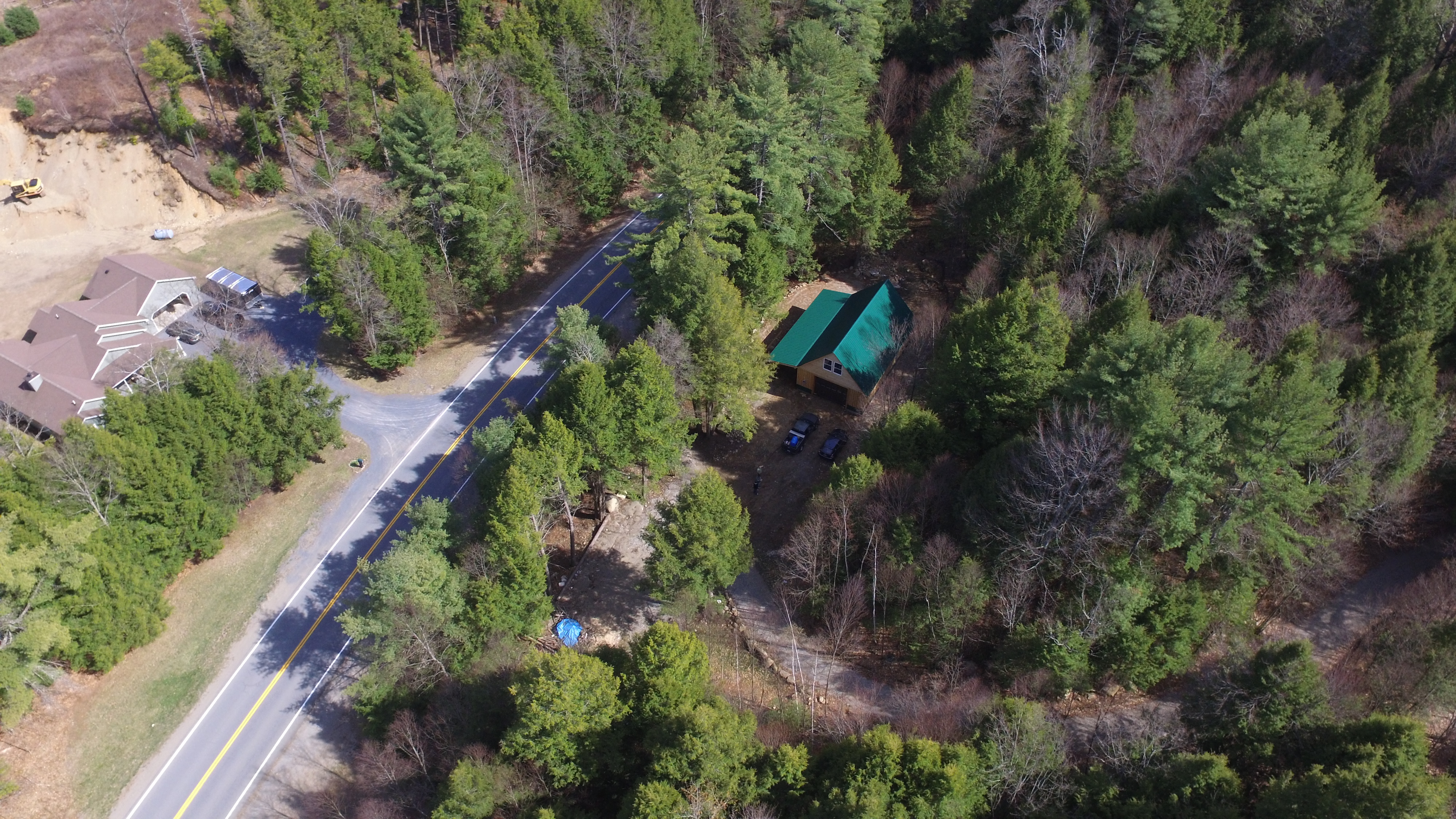

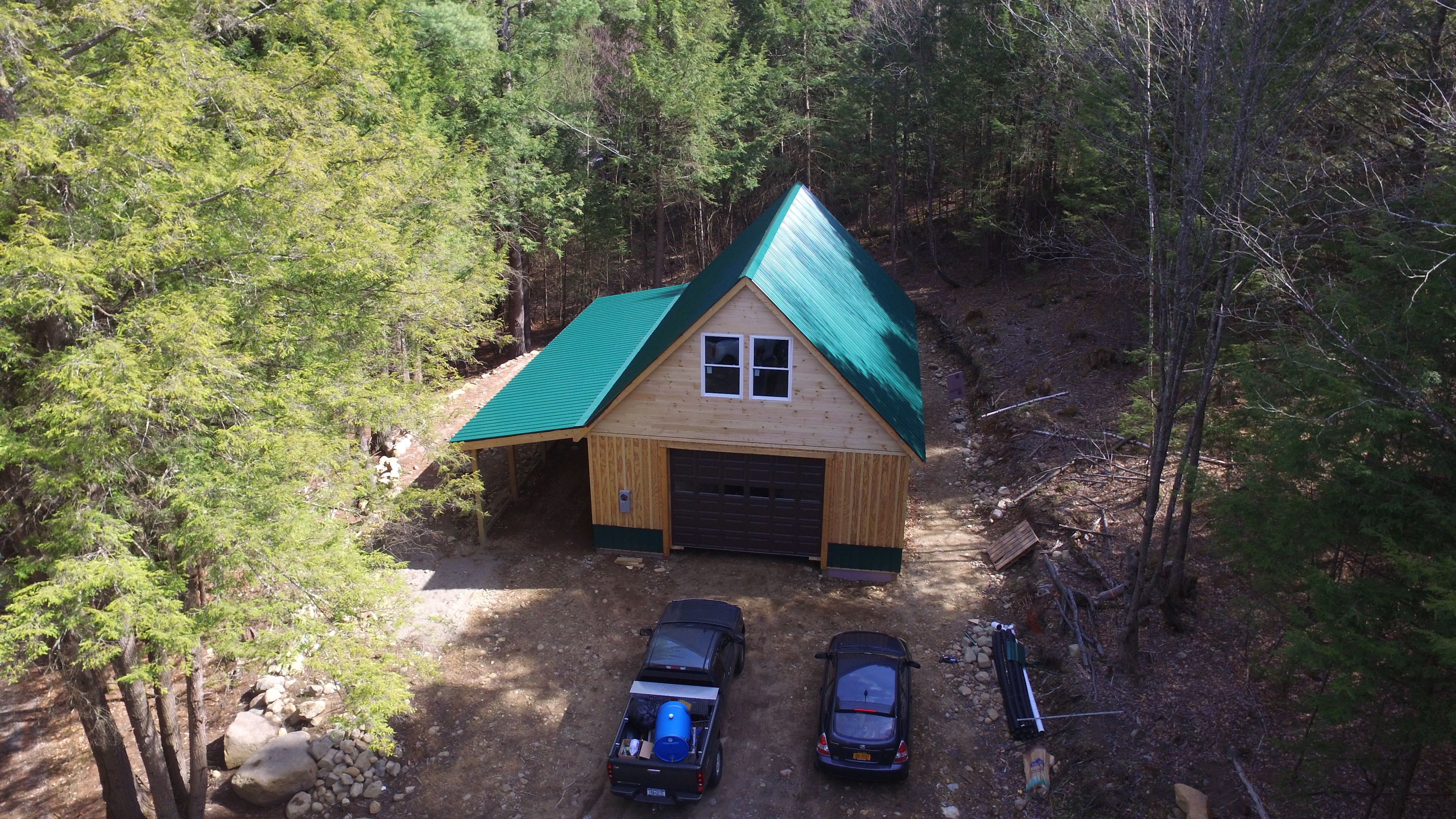

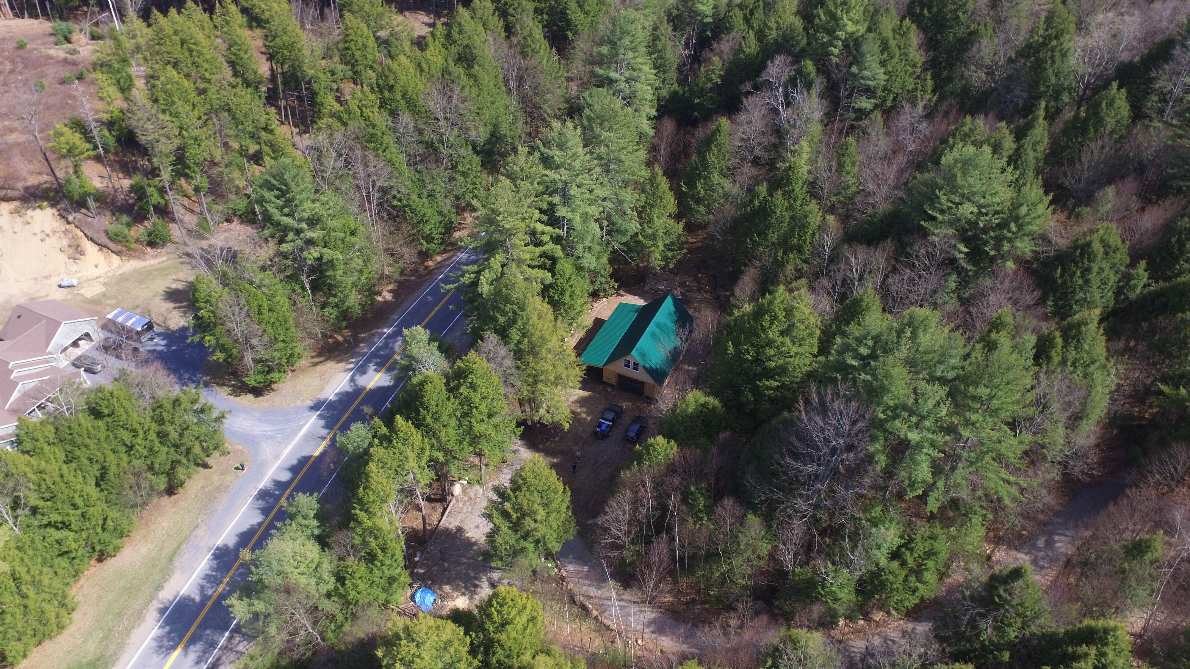

some "drone" footage

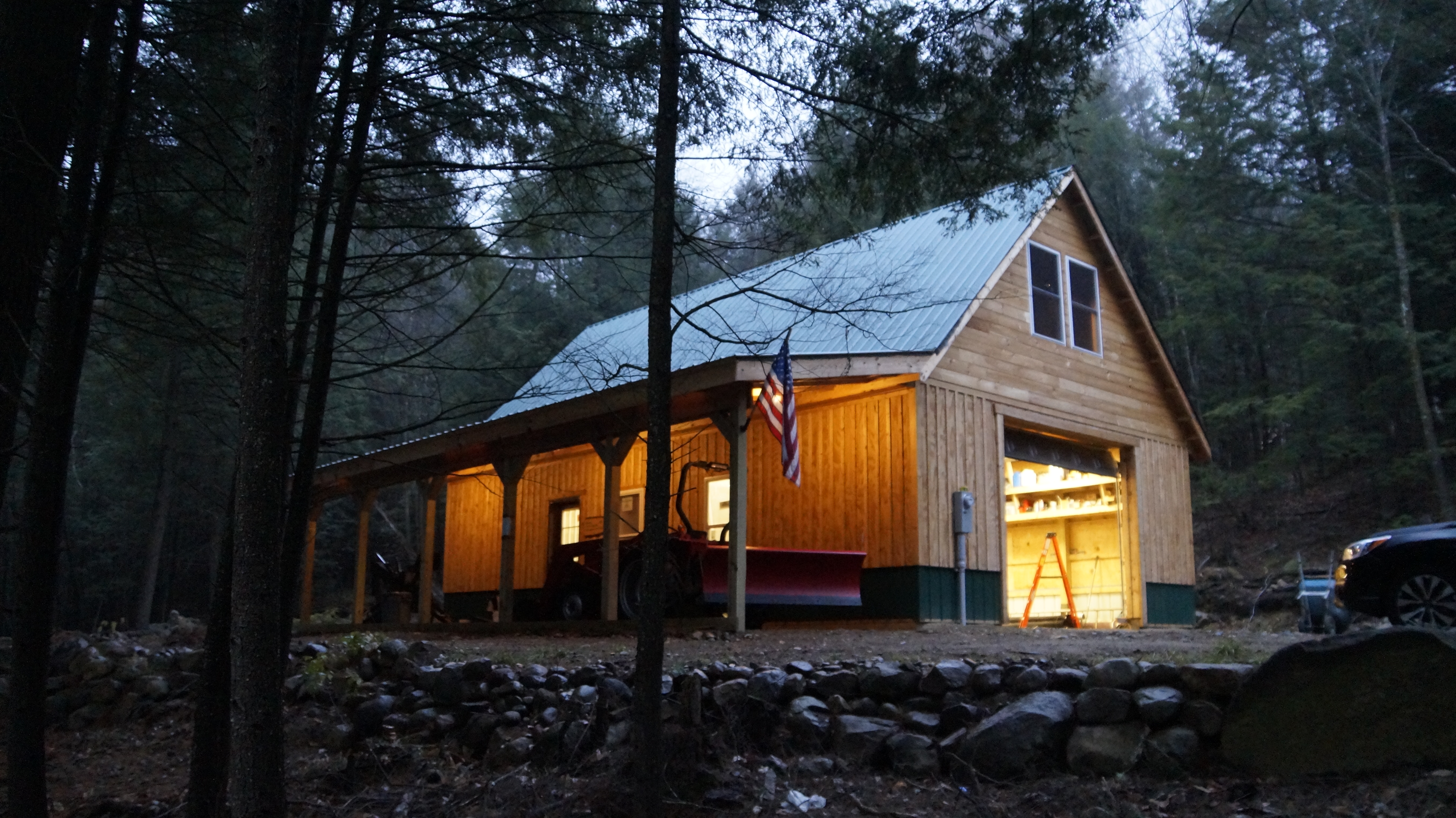

Let there be light! Successfully completed my first underground Service entrance with no sparks flying!

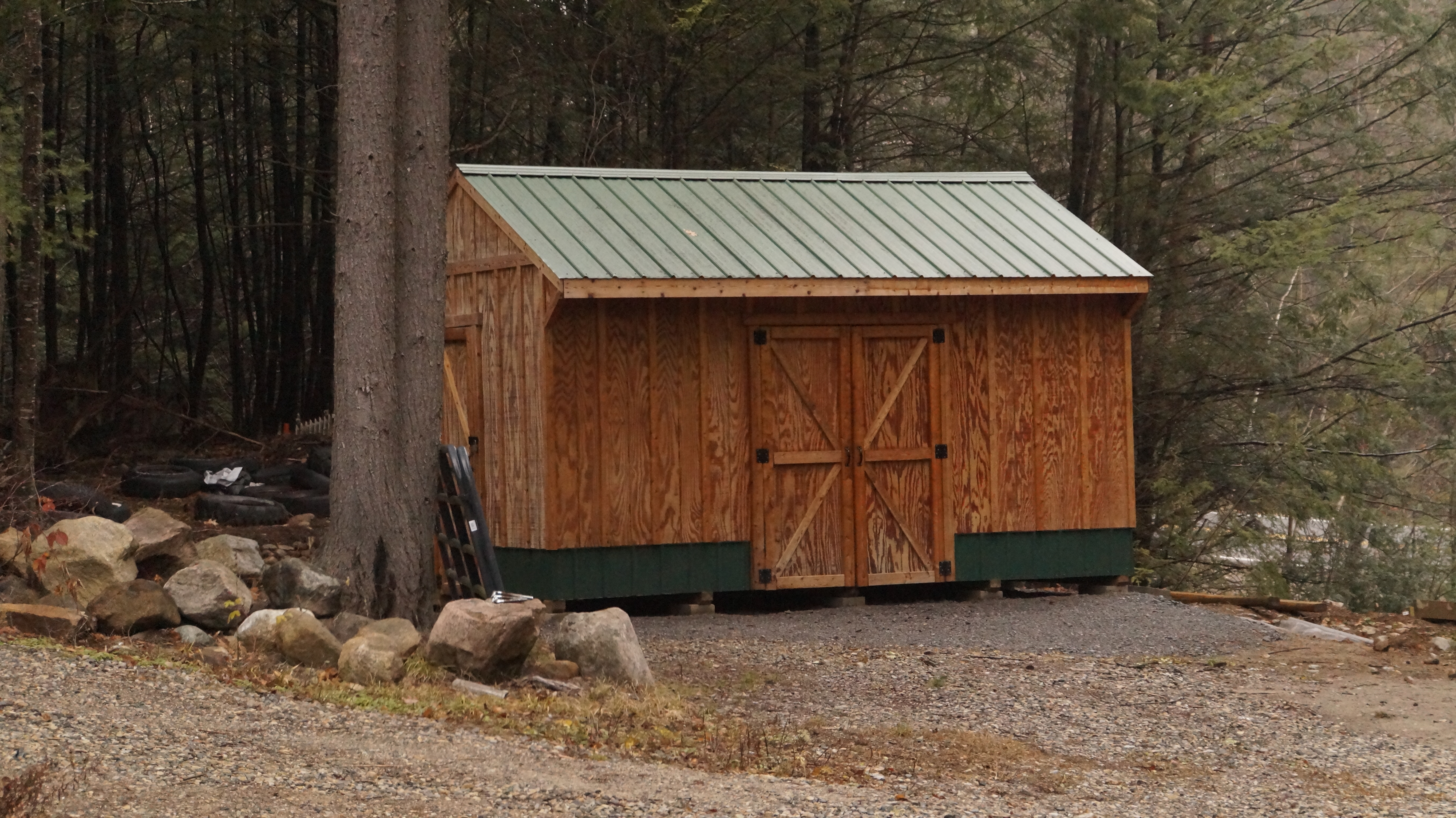

12x16 shed I built, and subsequently moved 300+' down my driveway. It's good to have a tractor.

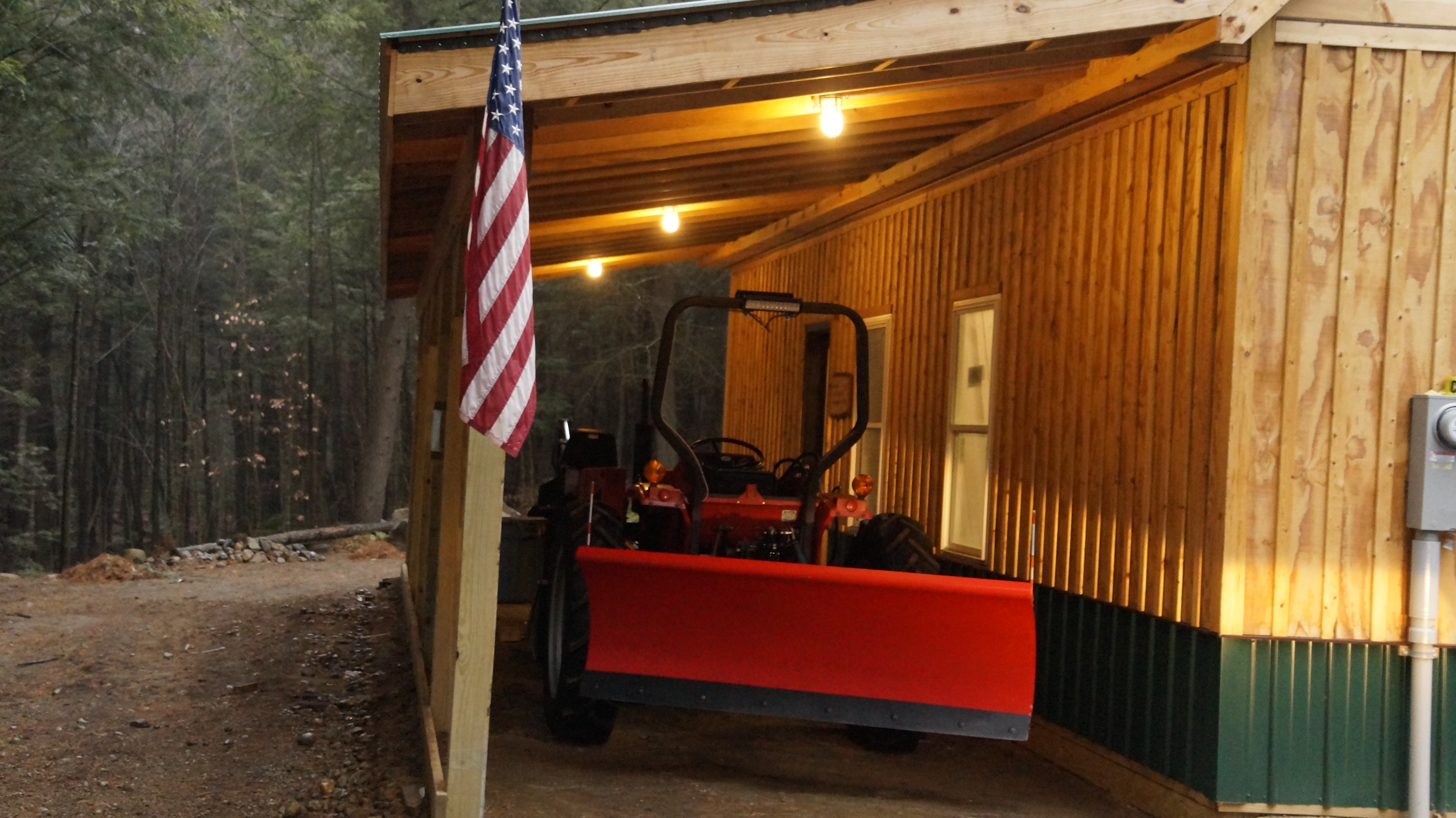

What did you sleeve the 6x6's in and did you anchor them to the piers? Also, what is the buried depth of the 6x6? Being in Upstate NY I am guessing you are down 4' or so? I am going to start digging for mine in the spring and this is pretty much the exact plan I had for mine.
   / 24 x 40 Pole Barn W/Carport Construction #18
Good question. Looks like you sealed the top of the sleeves? Maybe with Zip tape?
#19
Sorry, been off here a while. The posts are sleeved with a product called Post Protector. It runs all the way down to the footing and caps the subterraneal portion of the post like a boot. It is available for 6x6 or for thinner 3-ply 2x6 laminate posts. The duck tape was just on there to keep rain out during construction. Yes my frost depth is 4' so thats where the base of my footings are at.
#20
Ps. For what they are, the post protectors are EXPENSIVE. Dont remember what i paid, but i remember being unhappy about it. But... you know the posts wont rot for a VERY long time.
