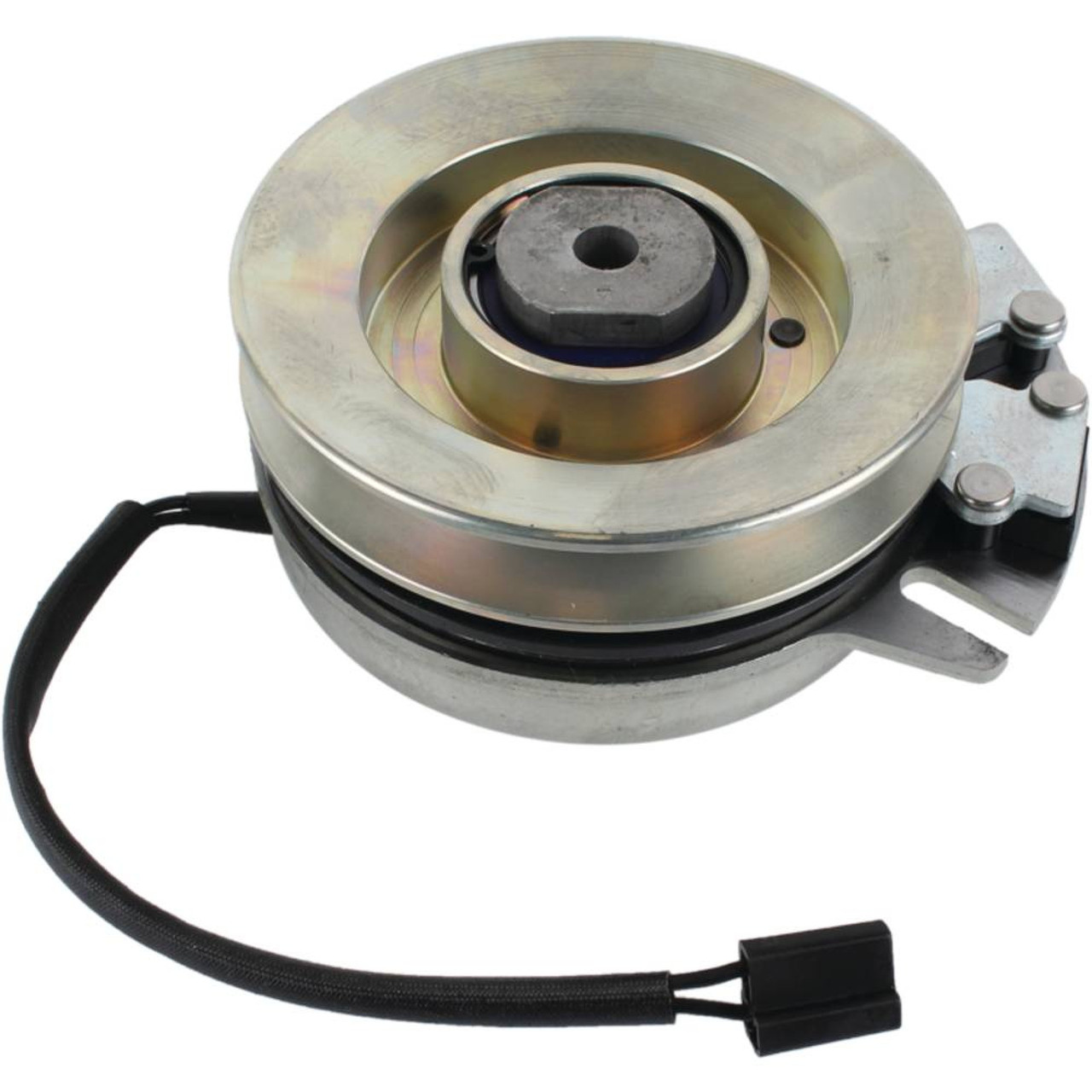

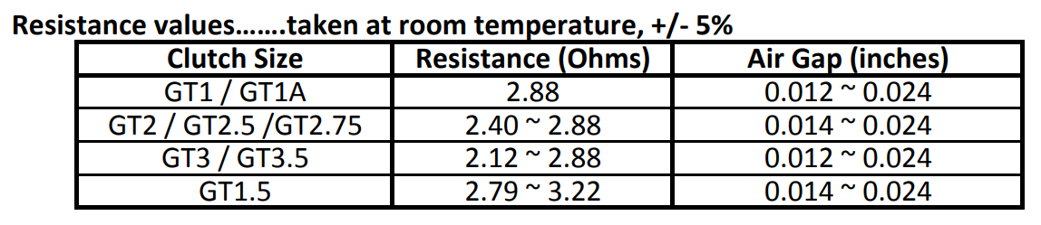

Son was mowing, when done told me blades stopped turning on. The PTO switch ohms out OK, but feels a bit flakey. Since it is late, I'm probably not doing much more tonight, such as checking the seat switch or PTO relay but figured to also need the static resistance for the PTO clutch.
Anyone know what it should be?
Way older 240 GT with Kawasaki engine.

Here is a link to some trouble shooting ideas:
Sorry I haven't yet found what the clutch coil resistance should be.
This may help:
