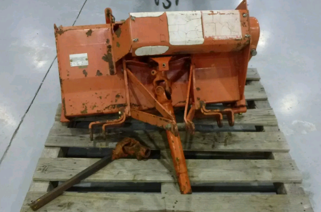

Ok, got my eye on a maschio Italian gently used W 85 .... Problem is shipping is gonna bleed me out... Still though, is 1700 to my door that bad for a 33inch vineyard type Great tiller... Heard these are 3k new? I could get a 1300 dollar new American one.... But heard euro or Asian is better... Thoughts?Screenshot_2018-01-08-23-41-40.pngScreenshot_2018-01-08-23-41-40.png

If it were me I would keep looking. That Maschio looks to be top quality but at 33 inches, its too specialized. Two strikes against it: 1) you need a wider tiller, 2) the price reflects quality that would stand up to service as a rental or a contract farmer who runs it hundreds of hours per year but for you, paying a substantial premium for that durability doesn't gain you anything in the few hours you would use it in a year.
This time of year there aren't many tillers advertised. You shouldn't need to have a distant and untested unit shipped in. Wait for spring and get something you can inspect before buying.
A Wanted ad in the farm section of Craigslist might bring you something local and fairly priced. This time of year, some people are overwhelmed with Christmas debt so unloading something they never got around to using might look attractive to someone who hadn't thought of selling. List an offer of $800 and see what turns up.

I was worried about a wider tiller with how small my tractor is... great advice though I will check you ship as well . I just don't want a piece of crap. I'm gaining patience but still not my strong suit they say I'm supposed to till a month before I plant
