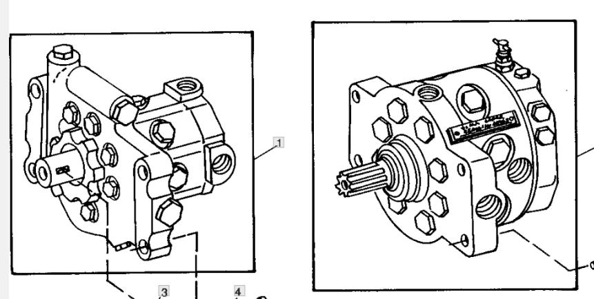

Is your tractor serial # below or above 341,000?
   / 2440 Pressure line leak #13
Which hyd pump does your tractor have? Pump on left is 1.38 in.3 & pump on the right is a 2.4 in.3
Pump on right and now I understand.. LOL.....all the other numbers in the listing are related to pump! You da man Jim! If ever you are up MT way I owe ya a few beers!
