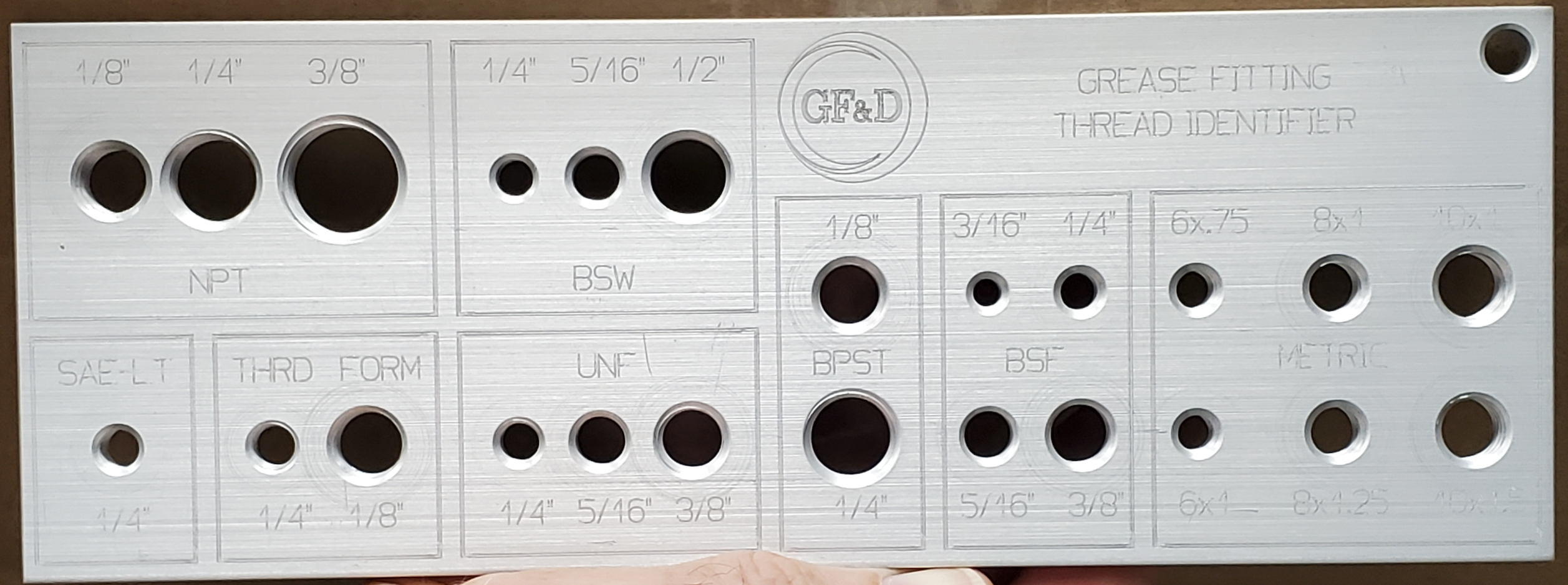

We use 55 degree Whitworth threads on microscope objective adapters .8 x36 tpi.
Very interesting. I would have thought metric would be go to unit, given Germany and Japan make the high end stuff, so is the Whitworth thread common in the microscope sector or just in one supplier. Which microscope producers use Whitworth thread?
What is the unit on the "0.8"?
Always looking for quality British standard tools - gauges, tapes & dies. Koken, Stahlwille, and Gedore are my go to for quality British standard tools still being produced. Who are you aware of?

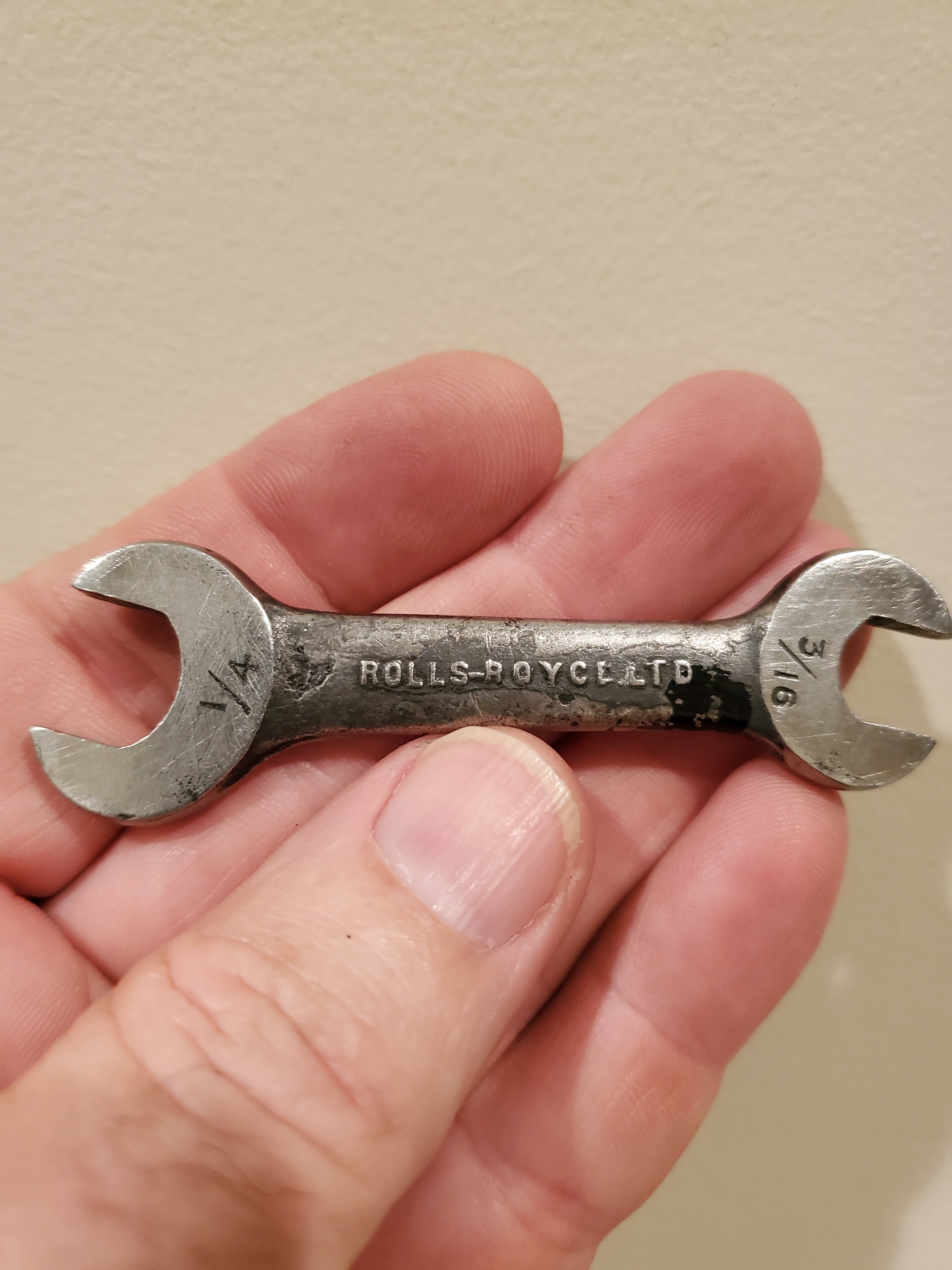

The photo of the 2 spanners cleverly demonstrates our mutual understanding of the sizing.
An unusual spanner ;)
