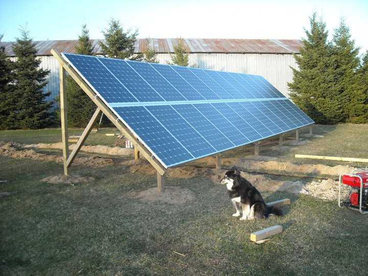

Thanks for the suggestions. My idea is to make the racking out of wood bolted together by carriage bolts. Then on the top will be two solar rails for each column containing four panels each in landscape position. I found mounting rails 164" long for 41.85 plus shipping at CivicSolar. I was originally considering Unirac but it was way too expensive (10k without supporting structure). I will build it with fixed tilt and if there is an issue with snow accumulation I will redo it later to variable tilt. Based on "what if" using PV watts there is only marginal power gain changing the angle.
Edit:
I have redone the PV watt "what if" and found that the variable tilt has larger impact that I originally thought. I think I will still do it fixed for now but in two column sections so in the future each could be tilted indpendently.
That's pretty much what I wound up doing. My cross bracing is Architectural Al C channel. Structural C channel would be stronger, but you don't get the nice flat bolting surfaces.
