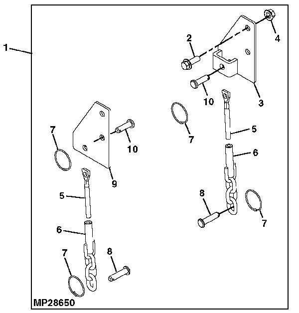

Here is what the JD lock-up kit looks like:

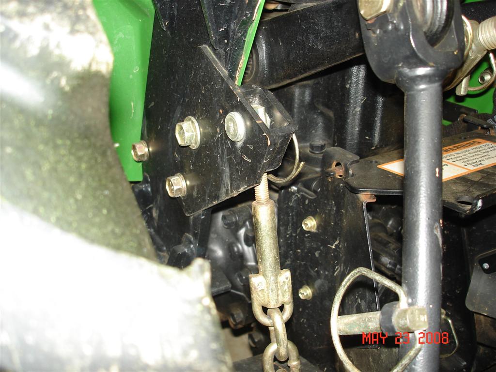

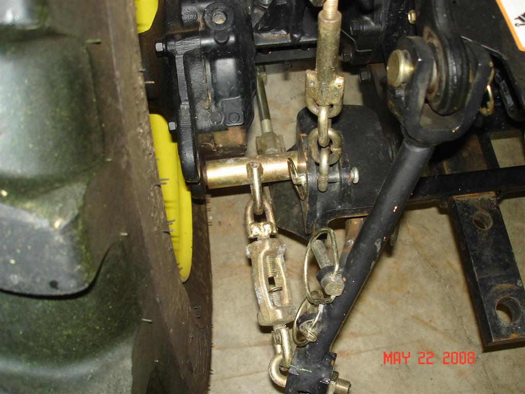

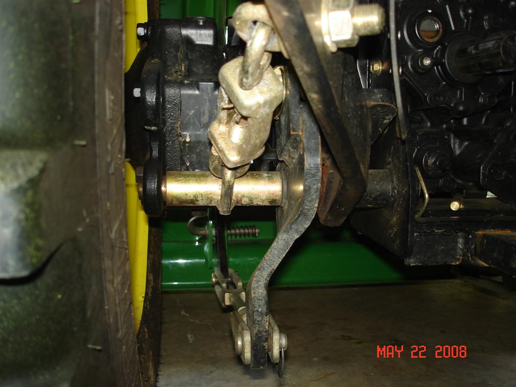

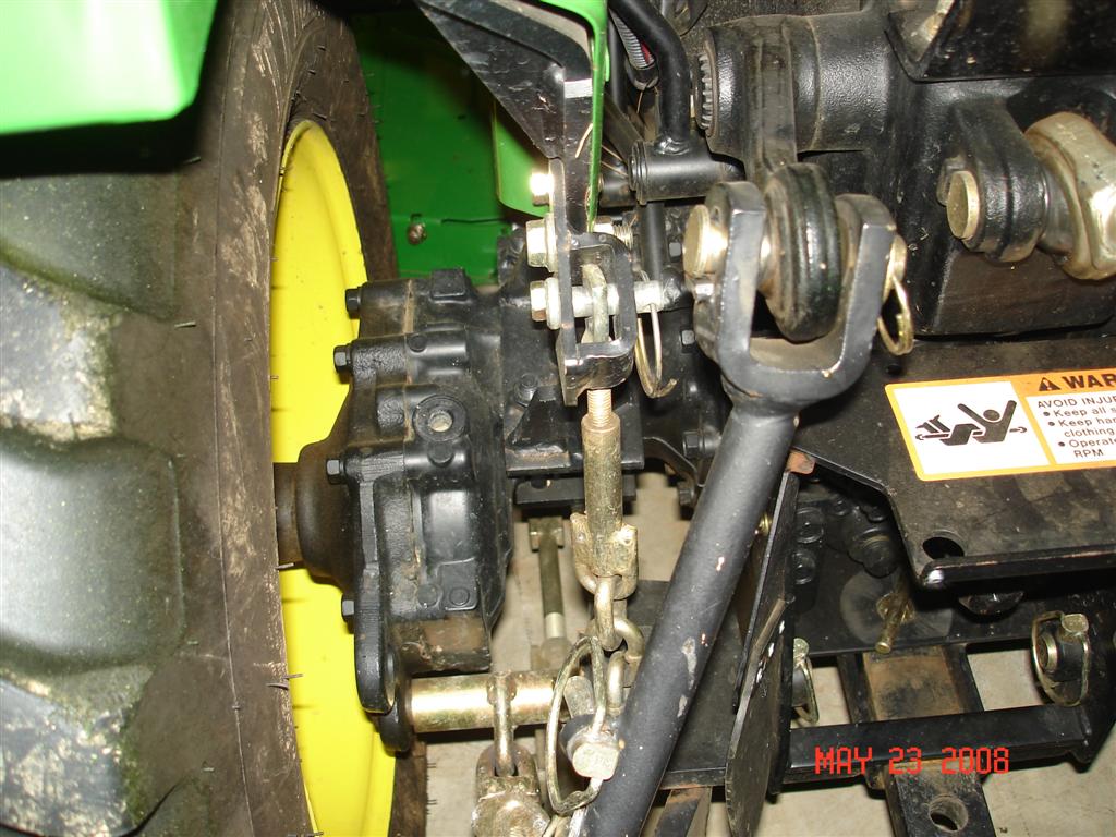

   / 2520 62d mower lift arms drag #13
   / 2520 62d mower lift arms drag #14
Question Kenny, what do you do with the turn buckles and chains when they are not holding up the deck? Do owners have to take them on and off? Ihad not seen this set-up before so I do not know that system works. Thanks for the pics....
Also Kenny your deck is quite glossy, do you mow with that?:laughing:
   / 2520 62d mower lift arms drag #15
I don't use them to hold the deck up...but rather to set the lowest cutting height (3.5" for me) in case the stop on the rockshaft lever moves. I never have the deck on when doing any 3PH work so I don't need them to hold it up. I remove the deck and use cable/zip ties to hold the arms up.
But you are supposed to have the turnbuckles set for the max lift height so you would raise the deck then install the pins to hold the deck up.
Oh, and those pics are old...not glossy anymore!

Yep.......that adjuster knob on the 2520 series is only there, if you have the independent lift cylinder. If you use the 3pth to lift the MMM, there is nothing that comes standard with the tractor to lock up the deck, or the lift arms when the deck is removed. Only option in that case is the "bracket & chain" lockup kit that JD offers. Or.....go with the bungee's or tie-wraps.
As I said before, when not using the lock-up chains you better take them off. One of mine threaded itself all the way out, and it dropped on the ground. Luckily I found the @#&# thing. Don't know if I could have bought just one chain from JD or not. Sure wouldn't have wanted to buy the whole kit again. No big deal to put the chains on or off, just a couple of minutes.
