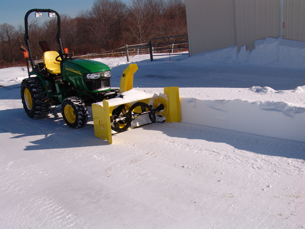

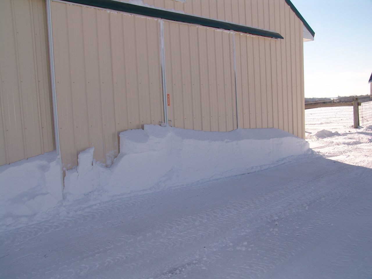

Tom - The wing opening is 54 inches. I got two pieces of 11 ga. steel (approx 1/8"). I don't know the grade, but it is quite rigid. I figured that was the max for bending, so worth a try.
Sunday's nor'easter gave it a good test. Don't have any idea how much snow we got - 850' double wide drive had anywhere from a couple of inches to over two feet when the wind got done. We had no local TV (no football) Sunday because all the antennas blew down - for real.
Blower and wings did a great job. Those hard packed drifts gave the motor all it could handle, if I took a full bite. The only problem was, on a smaller bite, with ice underneath, the wings would pull the tractor into the drift - loss of steering. Had to back-up and straighten out a few times. There is another interesting thread going about getting rid of rear ballast to reclaim steering. Wings did not get damaged or bent at all. All in all, I'm pleased. Probably will change the relief curve (bigger radius) on the bottom fronts in the spring.
I picked-up the blower this fall, assembled it, installed it and made the wings. I never used it without the wings so I have no comparison.

Nice work on the wings. Are you blowing on asphalt or gravel? Also, how do you have your skid shoes adjusted? I put mine all the way up so only the bottom edge of the blower is contacting the asphalt. The dealer left them down a bit (they told me it was all set up for an asphalt driveway) and it didn't do a great job cleaning up all the snow. Now it seems to scrape the asphalt and the edge somewhat, but I'm not sure if I'm beating up that bottom edge too much. It makes for a super clean asphalt driveway though. I just don't want to have to replace that edge every couple of years as I'm not sure how long it would take do beat it up beyond good use. I was just curious what others are doing. Thanks
