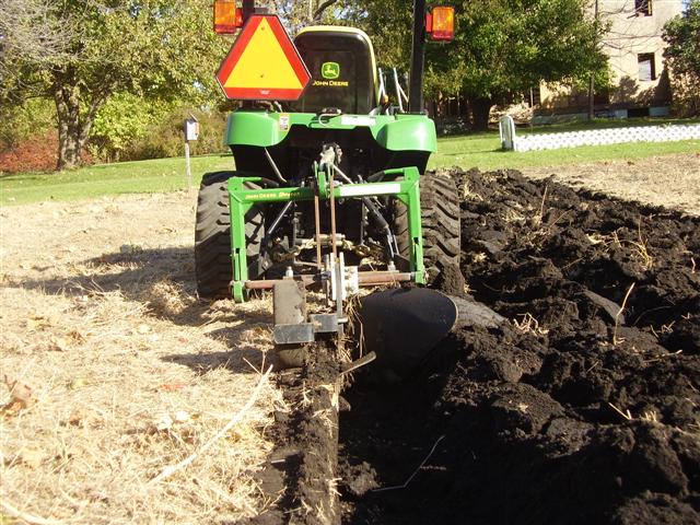

I have a Sitrex RH 4125 for my JD2305, it's a 50" tiller, my tractor handles it just fine, but it will push me along if I don't stay on top of things. I think the 2520 should handle a 4 ft tiller with no problem

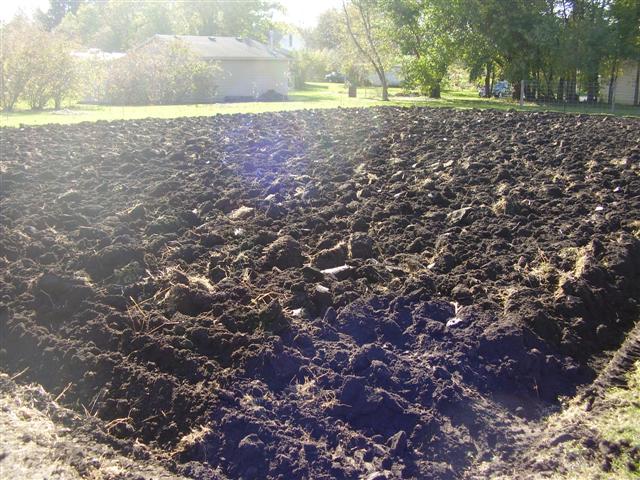

The tiller would be just fine for fall work but if you have a chance to buy a 12" plow then do it. The farmers around here would rather have there gardens fall plowed and spring tilled. Becides, plowing is just a lot of fun!

bigtiller ---- Thanks very much for the feedback and the pics. What a great job and appears you are using a 2305 with 12" plow as well.
I do have one other problem... The Brinly I purchased has a "sleeve hitch" and need someway to connect to either my JD imatch or the 3ph. Any suggestions? Appears in your pic that maybe you had to make a hitch? How did you make it and out of what? Maybe I could get someone to make an A-frame to fit. I checked with Brinly and they no longer make a sleeve hitch to 3ph conversion unit. thanks again.
