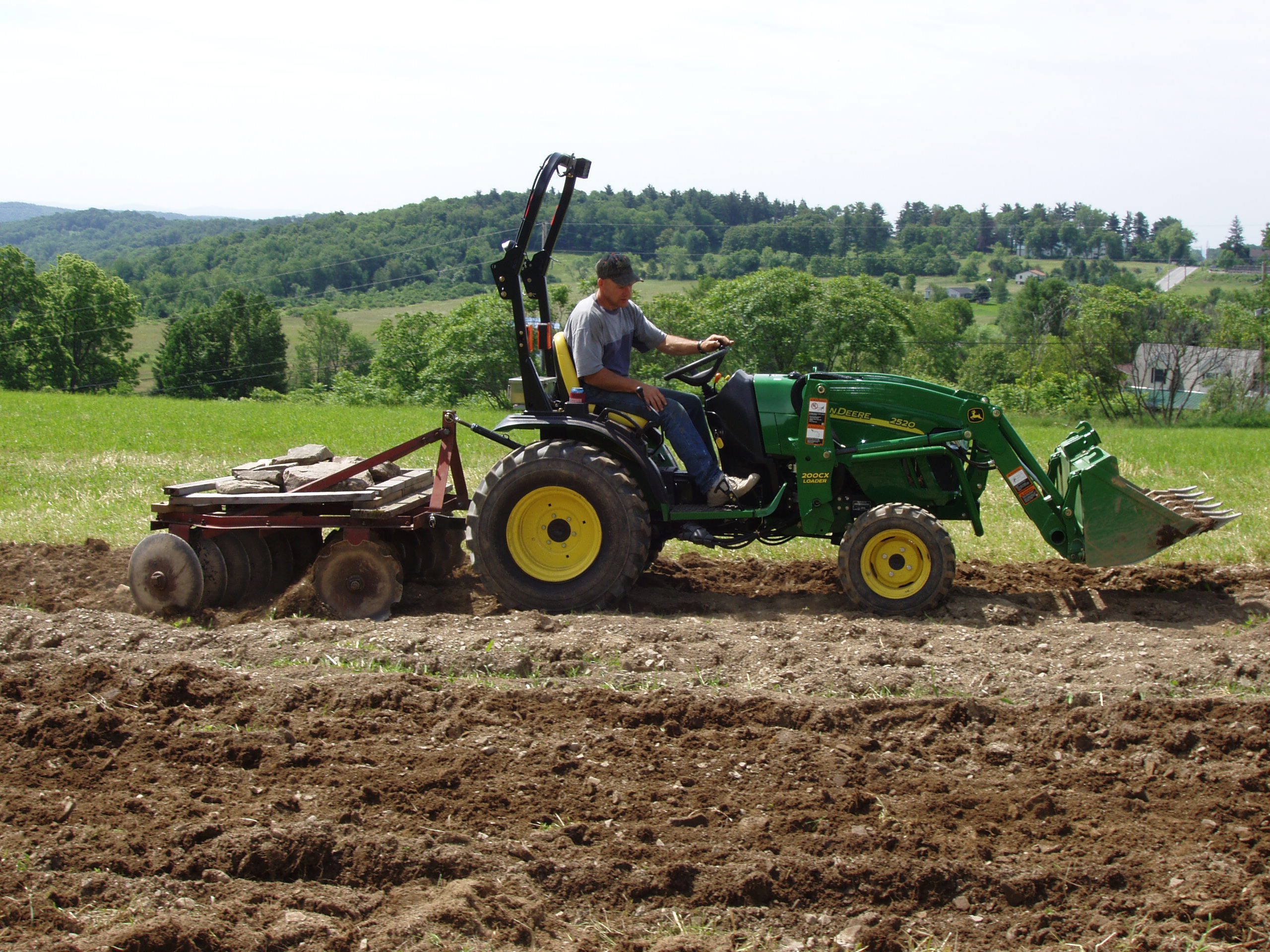

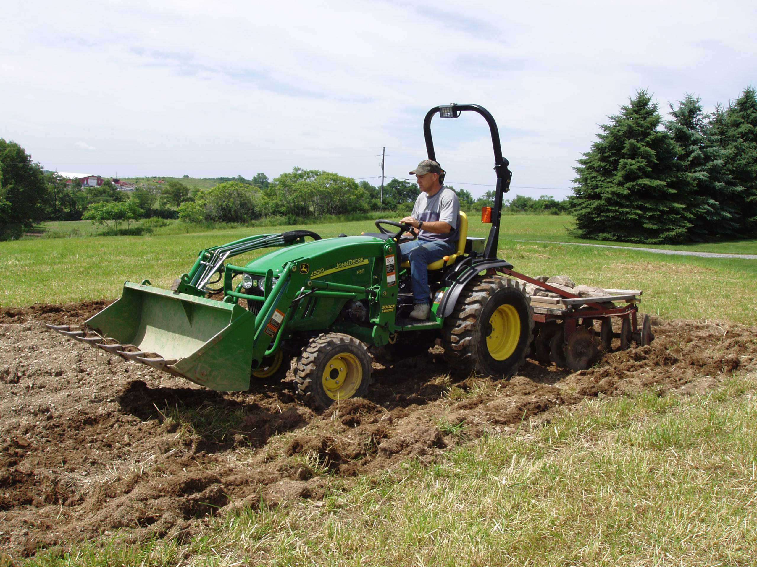

Soon after buying my 2520 in May 2011 I opened up a new garden site. My neighbor had a single bottom plow that I borrowed and a month after plowing I borrowed his disc harrow. I don't know the specifics of this harrow but by judging from the pics my guess is 66"-72"? I had no problem pulling it in 4wd, lo range. My rear tires are loaded.
/ 2520, what size disc #6
I wouldn't go over a 66-72". Just enough to cut out your tracks because your tires aren't filled. Weight is your friend when plowing and disking.
