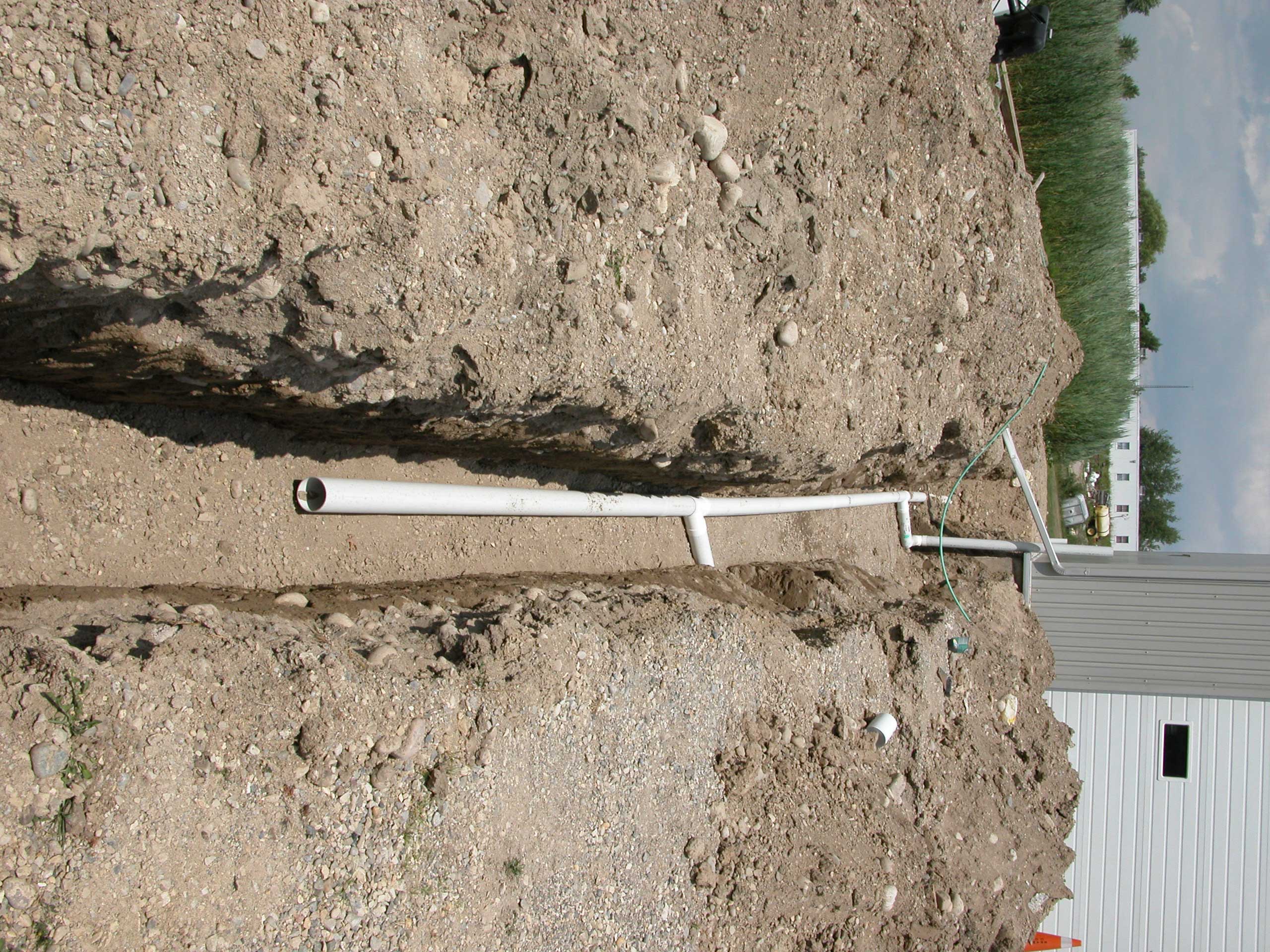

I already had plans to post pictures from start to finish. It has been a quality job so far, just alot of work. I have not had the time to complete everything. After the hours I have logged I got the backhoe on lockdown. Things really picked up once I learned to move myself still sitting in the back seat with the backhoe. Once I figured that out it saved me alot of time from having to jumping back and fourth to move the machine. On the bright side of this job I caught a **** of a tan.
Took a bunch of photos so should get a couple good ones that give a good idea.
Here is a quick photo to give you an idea.
