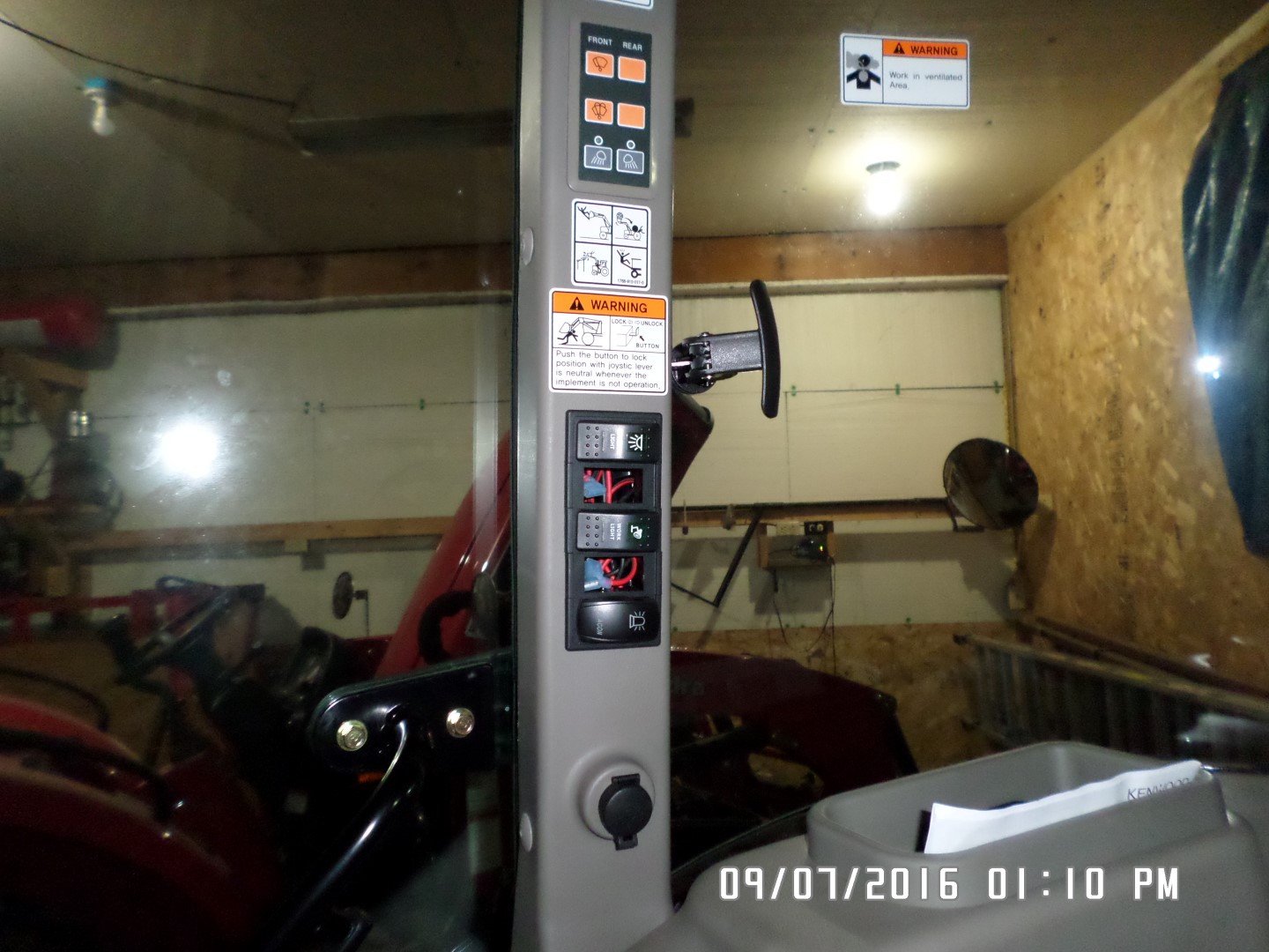

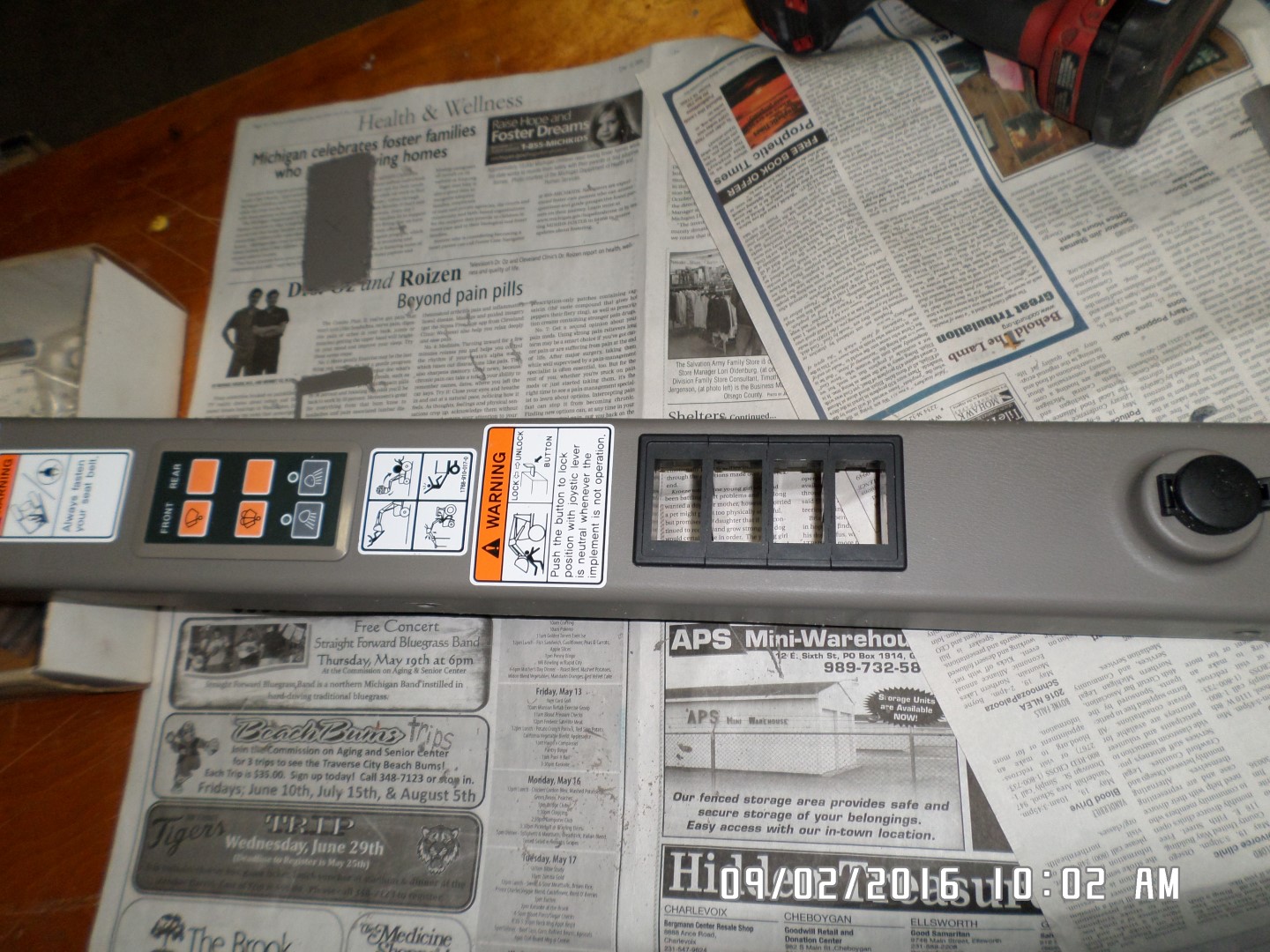

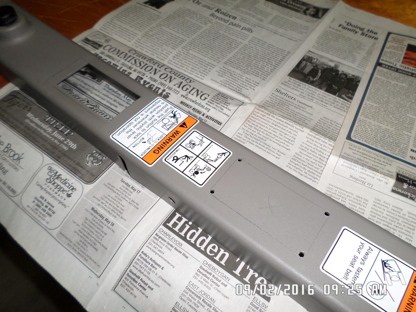

Relocated the stock wiper/work lamp control up on the pillar, and added room for 5 ARB/Carling Jeep type rocker switches. Top switch turns on the dome lamp [ lazy, don't have to lean forward/reach up to turn on ] which now contain a bright LED COB light. Middle switch turns on both front and rear work lamps. Bottom switch controls the rotary beacon. The wires you see in between are grounds and power for future switches. Have blank covers coming to fill those spots for now. Wired up the switches so the bottom LED's light up when the ignition sw is ON. And each large LED light switch logo is lite when that function is on. Have most of the wiring done, but still need to mount 4 amber 18 watt LED floods which will work with the hazard flashers or turns.... Retain the stock switch assy to control wiper/washer functions.. old F/R work lights switches only turn on/off the little green LED's next to them.... if you feel like it...
Were you able to steal a power source in that pillar or did you have to run a new source of power for your rocker switches?
   / 2555 HST Cab Jeep rocker switches....
#48
I took some power from the stock push button panel that I relocated up on the column. That power is hot when the key is ON and I used it to power the LED's within the switches that light up the switch lettering/icon and some of the other LED's in various positions. And the new LED work lamps are still powered from this stock circuit, just like the removed stock work lamps were. I ran a #8 wire straight off the battery with a 10 amp fuse [ can go bigger if needed ] in an inline fuse holder tyraped right to the right of the battery. Ran this wire in black corrugated split loom from there up thru the stock rubber wire gasket right beside the stock wiring up into the new switch area. I made a new ground point just above the switch area to hook all grounds onto the cab frame. On the left rear cab rubber mount, I bridged the frame of the cab to the axle steel with one of those old timey flexible copper grounds that they used to use on hoods, from body to frame, etc. It is just about a 8-10" of woven copper mesh that has a heavy duty stakon on each end. Put another piece of that loom over it, and bolted down to the cab steel and rear end steel with stainless bolts. With a shot of semigloss black paint to make it look stock. That way I know the cab is well grounded. The beacon and new led overhead light [ stock dome light with LED panels added ] is powered straight from the battery just like the stock warning flashers. That way I can turn the overhead cab light on even with the key off via the top new rocker switch. I left the wiper control alone in the stock control pad that I relocated up higher.
