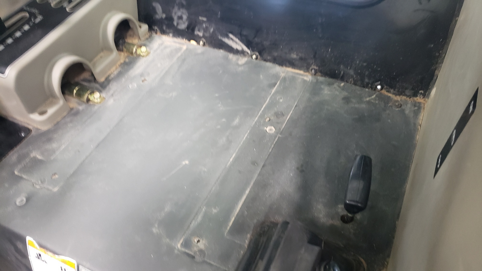

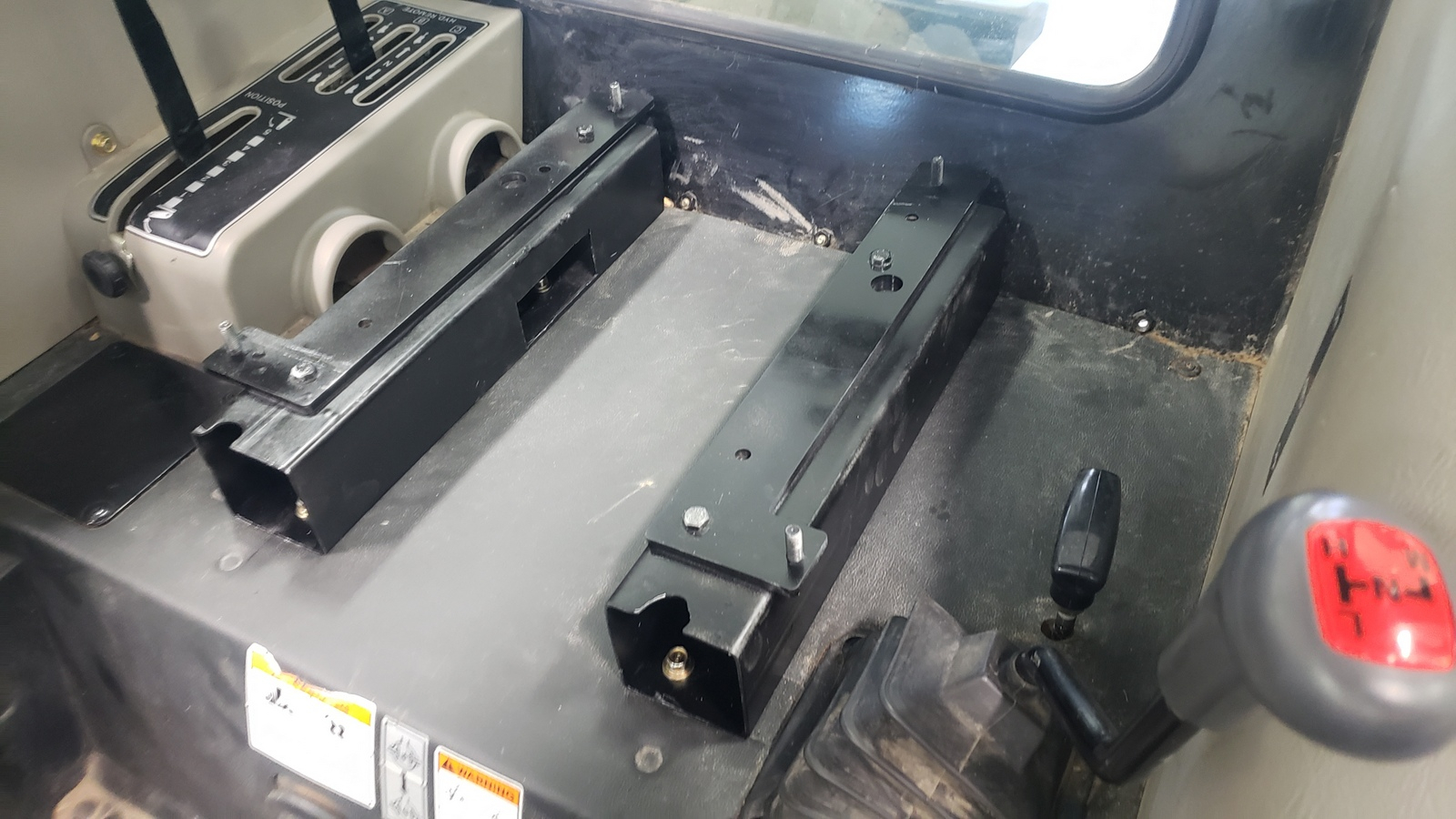

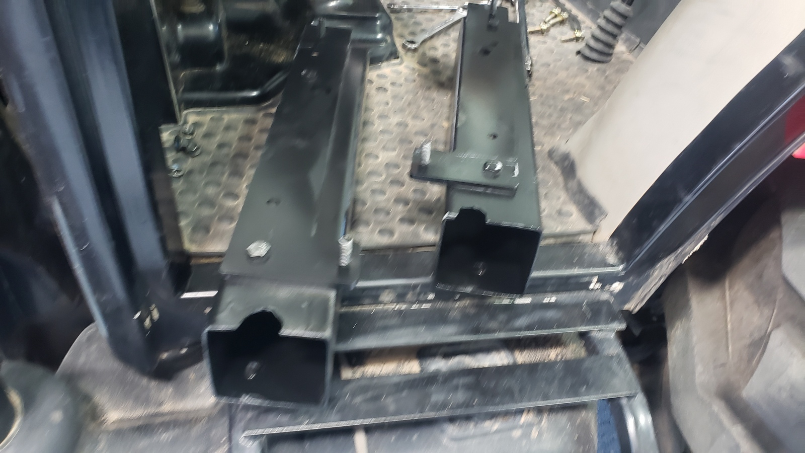

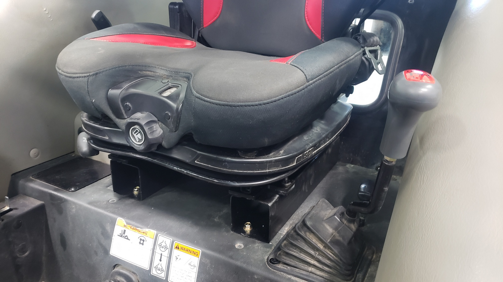

I have a 2655 as well and am big and tall. thanks to this thread i did the same thing. used 3 inch square tubing that a neighbor had in his scrap pile. the holes on the side are so you can get the bolt in at the rear. the notch on the top of the front is for the nut holding the bracket on the bottom of the seat to clear. i moved the top bracket back 1.5 inchs as well to give more room to the back. with it at 1.5 inches back, it still had a finger width of clearance at the very bottom of the seat that is closest to the back cab wall.
