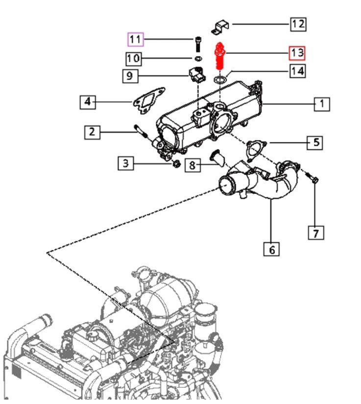

I have had intermittent issues with my 2565's glow plug light for 3 or 4 years. The dealer replaced the relay a few years ago under warranty, but the issue returned a couple of months later & then it was out of warranty. About 2 months ago my light came on & stayed on while I was in the pasture. I rushed it back to the shop, but by the time I got there the wire going to the heater was melting the insulation off & starting to smoke, so I yanked the battery cable & avoided a fire! (note to self...buy a fire extinguisher for the tractor) I removed the wire from the heater & cut off the end that had burned, then capped it with a wire nut. Problem solved, but I know I will have to sort it out eventually. Anyone have any idea where to start??? I just downloaded the shop manual, but the wiring diagrams are pretty useless, anyone know where i could get a better copy of them???
