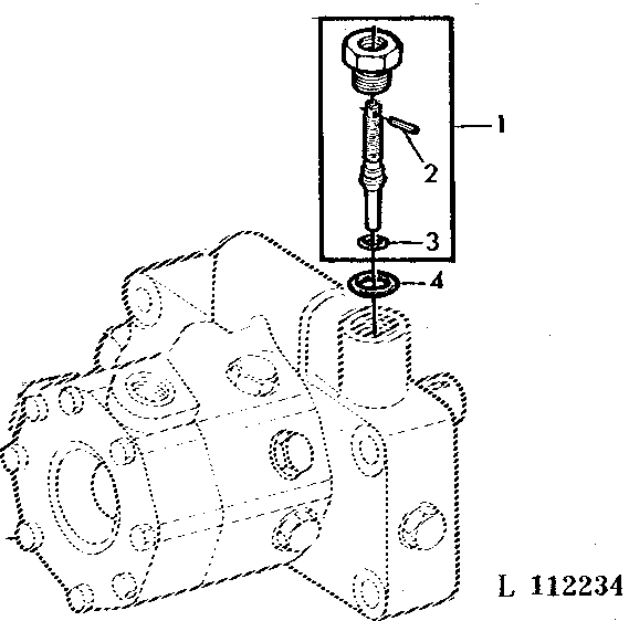

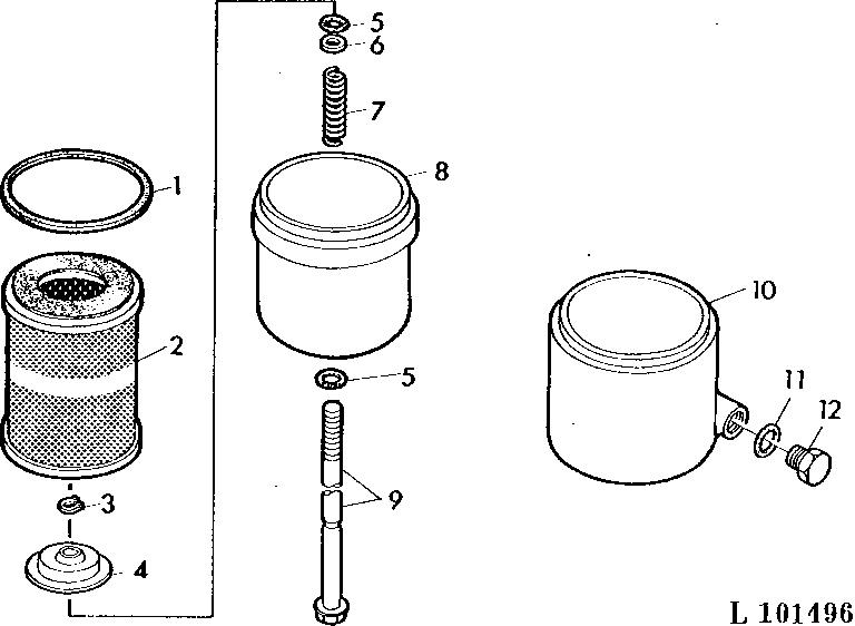

Remove hyd filter,put 5 gallon bucket under opening start engine and see if trans pump will pump oil and how many gpm's.
/ 2555 john Deere
Which filter? The spin on or the cartrige filter?
/ 2555 john Deere #7
Cartridge filter. Another thing you can try is install a hyd pump destroking screw and then manually destroke/engage pump to possibly clear debris from valve seating area. Do tractor have a FEL??

FEL=frt end loader. Valve I referred to is stroke control valve(parts key 26) depending on which hyd pump your tractor has 23CMC or 40CMC.
